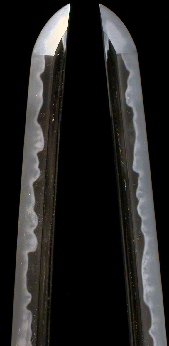

cabowen Posted May 30, 2010 Report Posted May 30, 2010 There is good hadori and not so good. There is well presented ji-tetsu and not so.... Here is an example of well done hadori: Notice how it is semi-transparent. Also notice how the ji tetsu is clear, not cloudy and hard like a mirror. It looks like the steel was vivisectioned. Quote

Mark Green Posted June 3, 2010 Report Posted June 3, 2010 Wow, a full polish window, with burnishing and all. Nice looking hada. I personaly like sashikomi, But i'm with Chris, when hadori is done well, it can be very wonderful to behold. I do feel though, that even in Japan, with the pro polishers, good hadori can be hard to find. I think it likely takes a knack. Some people have it, many don't. But put it on your sword none the less. Mark G Here is one by a board member with the knack Quote
