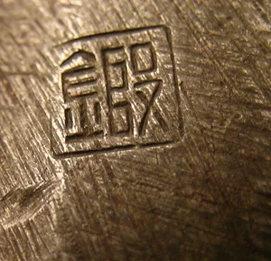

Bruce Pennington Posted May 22, 2024 Report Posted May 22, 2024 On 5/21/2024 at 7:46 PM, tim89 said: I have a Kanetsune. Expand Tim, Is there at Tan stamp above the mei? Also, can we get a close-up of that stamp at the bottom? Quote

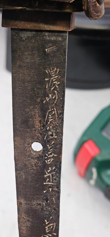

Bruce Pennington Posted May 26, 2024 Report Posted May 26, 2024 Timothy, I don't read Japanese, so maybe you can help us with this post? Otherwise, we'll wait for @Kiipu @BANGBANGSAN @SteveM. Photo righted and enhanced a bit Quote
Bugyotsuji Posted May 26, 2024 Report Posted May 26, 2024 濃州住人兼常鍛之 無し Nō Shū Jū Nin Kanetsune kitae kore (Reverse) Nashi (nothing) 1 Quote
Bruce Pennington Posted May 26, 2024 Report Posted May 26, 2024 Ah. I thought it might be something that would shed some light on the tan stamp. Quote
Bugyotsuji Posted May 26, 2024 Report Posted May 26, 2024 Kitau, kitaeru are the same 鍛 as Tan. It seems many of the signatures end in 鍛之 "forged by Kane-somebody", and the stamp is an added guarantee of reliability & authenticity. So Bruce would like to know here which particular forge in Mino/Seki added this hot stamp, right? 1 Quote
Bruce Pennington Posted May 26, 2024 Report Posted May 26, 2024 On 5/26/2024 at 10:29 AM, Bugyotsuji said: Kitau, kitaeru are the same 鍛 as Tan. It seems many of the signatures end in 鍛之 "forged by Kane-somebody", and the stamp is an added guarantee of reliability & authenticity. So Bruce would like to know here which particular forge in Mino/Seki added this hot stamp, right? Expand If that is known, then sure! We are just trying to understand the significance of the stamp. Even Richard Fuller, in his book, understands what the kanji says but no one understands why it is there. Does it mean the blade is made in a traditional manner? Is it a quality stamp by a particular forge??Just trying to figure out why it is on some blades. Quote
Kiipu Posted May 26, 2024 Report Posted May 26, 2024 I found it interesting that, as the Honorable Bruce stated above, it has only been found on blades forged in Gifu Prefecture. All that can be done is to locate more examples and see how many swordsmiths used this particular stamp and when. The when part is rather silent though. In my opinion, I see one of two possibilities. The 1st is that it was used by a training forge or a regular forge. The 2nd is that it was an association stamp just like the Shō 昭 and large Seki 関. However, I searched through all of Mal's monographs on Gifu Prefecture and did not find one example of the 鍛 stamp. I would think that he would have at least included one if it was found. On my end, I will keep my eyes open for more examples and post links to them. 1 1 Quote
Kiipu Posted May 26, 2024 Report Posted May 26, 2024 I found the following via a quick Internet search engine. Did not look to carefully though. Kaneaki KANEAKI—2ND SEAT -WW2 Japanese Army Officer Samurai Sword/Old Gendaito Kaneshige via text only? Lot 2437: Two Signed Japanese Swords Kiyonobu Kiyonobu Gendaito in Shin-gunto Mounts 1 Quote
Kiipu Posted May 26, 2024 Report Posted May 26, 2024 TAN/KITAU STAMP This stamp means forged or folded. Seems to be used mainly (?only) in Seki. Possibly it means a hand-made forged blade that is not of fully traditional manufacture (e.g possibly mill steel, or a variation of oil quenching). Omote-mei Two example only, neither are dated. This may mean they are pre-1942. Cox, Malcolm E. “A Survey of Wartime Blade Stamps.” JSSUS Newsletter Vol. 26 No. 3 (May-June 1994): pages 2–10. 2 Quote
BANGBANGSAN Posted May 26, 2024 Report Posted May 26, 2024 On 5/26/2024 at 6:30 PM, Kiipu said: TAN/KITAU STAMP This stamp means forged or folded. Seems to be used mainly (?only) in Seki. Possibly it means a hand-made forged blade that is not of fully traditional manufacture (e.g possibly mill steel, or a variation of oil quenching). Omote-mei Two example only, neither are dated. This may mean they are pre-1942. Cox, Malcolm E. “A Survey of Wartime Blade Stamps.” JSSUS Newsletter Vol. 26 No. 3 (May-June 1994): pages 2–10. Expand @Bruce Pennington I suspect that the "鍛" mark could represent the traditional hand-forged blade"本鍛練刀". http://ohmura-study.net/211.html 「株式会社濃州日本刀鍛錬所」 (清見町)が設立され、専属刀匠を置き、考案の特殊坩堝鋼、厳選した安来鋼を材料として、古式鍛錬の技法を遺憾なく発揮して優秀軍刀を鍛造し、厳密な検査の上、一つ一つに責任保証を付け、全国及び満洲. "Noshū Nihon Token Kōjō Co., Ltd." (Kiyomicho) was established, placing exclusive swordsmiths and utilizing specially devised crucible steel and carefully selected Anshin steel as materials to fully demonstrate the ancient forging techniques, forging excellent military swords. After rigorous inspection, each sword was guaranteed with a certificate of responsibility, and the company accepted orders directly from trading shops and customers across the country, as well as in Manchuria and China. https://www.touken-world.jp/tips/21493/ 1941年(昭和16年)には太平洋戦争が勃発。関の刀剣産業は再び盛んになりました。このころ作られた軍事用の刀剣は、古くからの日本刀とは区別して「昭和刀」と称されます。昭和刀は戦争が進むにつれ、粗悪品が出回るようになりました。 そこで関市の刀剣業者は製品のクオリティを保証するため、新しく制作された刀剣を関刃物工業組合で検査し、基準をクリアした物に証印を打つことに。近代的な製造システムによって価格を抑えられている上に、こうした品質保証制度が整えられた関市の刀剣は人気を集め、国内の市場シェアを伸ばしていったのです。 終戦直前の1944年(昭和19年)には、関の刀鍛冶は49人、昭和刀鍛冶200人、研師3,000人であったと記録されています。 In 1941 (Showa 16), the Pacific War broke out, and the Seki sword industry once again flourished. The military swords produced during this time were distinguished from the traditional Japanese swords and were referred to as "Showa swords." As the war progressed, the quality of Showa swords began to deteriorate, with many inferior products being circulated. To guarantee the quality of their products, Seki's sword manufacturers began to inspect newly made swords at the Seki Cutlery Industrial Association, stamping a seal of approval on those that met the standards. With prices kept low by modern manufacturing systems and the establishment of such a quality assurance system, Seki's swords gained popularity and expanded their domestic market share. Records from 1944 (Showa 19), just before the end of the war, indicate that there were 49 traditional swordsmiths, 200 Showa swordsmiths, and 3,000 polishers in Seki. 1 Quote
tim89 Posted May 27, 2024 Report Posted May 27, 2024 On 5/26/2024 at 1:14 AM, Bruce Pennington said: Timothy, I don't read Japanese, so maybe you can help us with this post? Otherwise, we'll wait for @Kiipu @BANGBANGSAN @SteveM. Photo righted and enhanced a bit Expand Bruce, Hey sorry I didn't give any information other than the torokusho. I'm usually pressed on time these days. Have twin 2yr old sons that have me running all over the house. Noshu ju nin kanetsune kitau kore The other side is just the rules describing the need to keep the torokusho with the blade at all times. I've been under the impression that it is traditional forge but more than likely oil quenched, which im 100% alright with if it is. This is the only blade I have from that time period. Everything else I have is 1980s>present or <1800s. Anyways, some more pictures. I played around with different lighting. Although I've studied Batto for many years I'm still trying to become more proficient with the smiths and the collector side of things so that I may appreciate and deepen my understanding of Nihonto even further. Timothy N. Quote

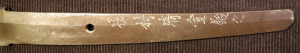

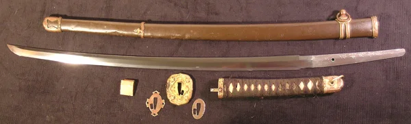

Bruce Pennington Posted May 27, 2024 Report Posted May 27, 2024 The Kiyonobu from Japanesesword.com Quote

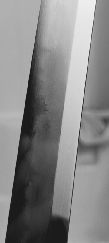

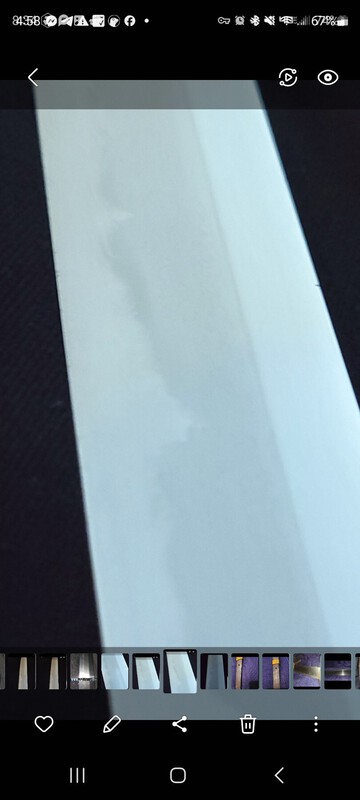

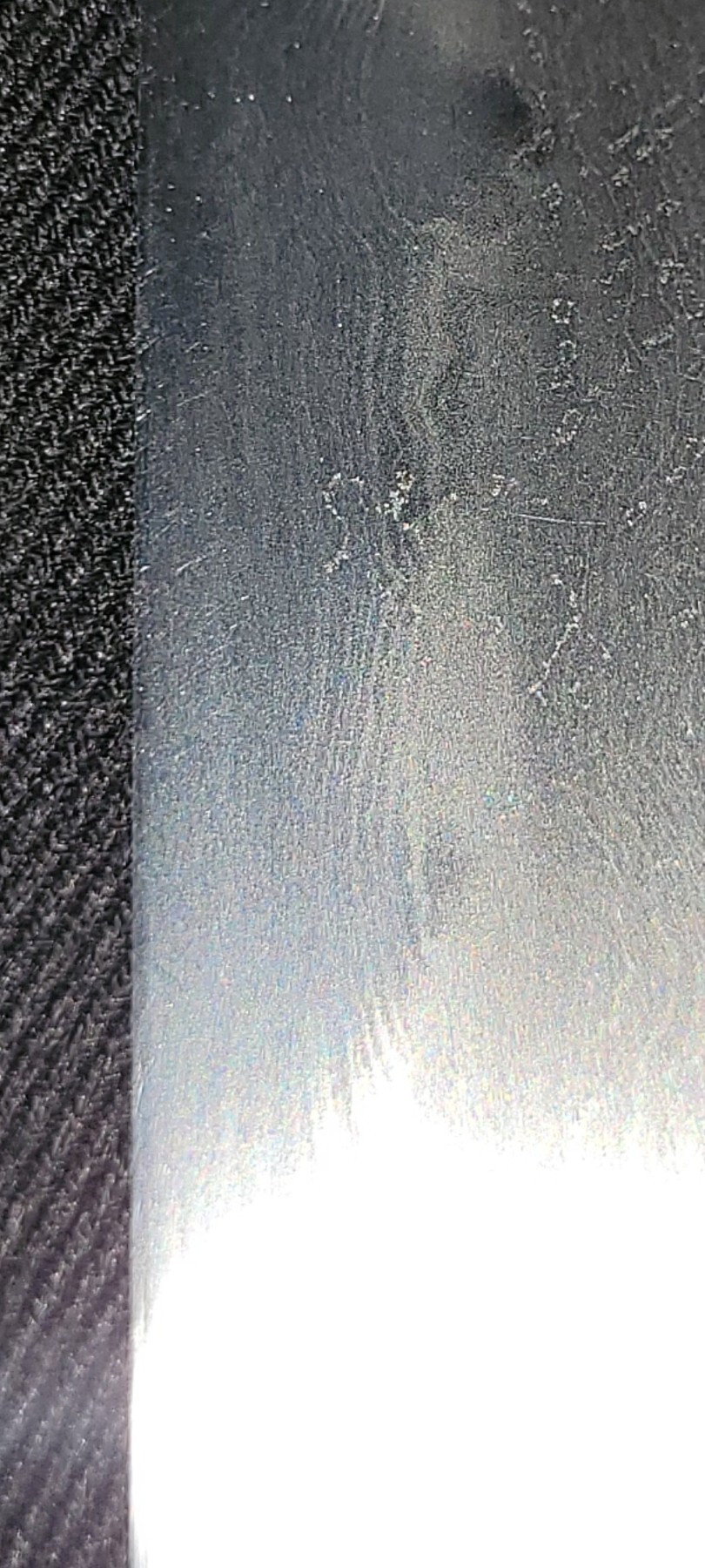

Bruce Pennington Posted May 30, 2024 Report Posted May 30, 2024 Going through these slowly. Please join in and give me your thoughts Nihonto guys! Sadatsugu, 1942, posted by @hxv. Has obvious hada, but to my untrained eye, seems to have black spots in the hamon. Does this mean oil quenched? Only 2 photos I have of the blade: Quote
dwmc Posted May 30, 2024 Report Posted May 30, 2024 I don't think I've ever seen an oil quenched in a Choji type hamon. I'm probably 100% mistaken but seems as though (of course without researching the matter) most oil quenched hamons appear to be Gunome pattern? Quote
Brian Posted May 30, 2024 Report Posted May 30, 2024 Don't see much sign of oil here. Lots of activity and nie lean away from oil quench. Can you add an arrow to the black areas you are referring to? Thanks. Quote

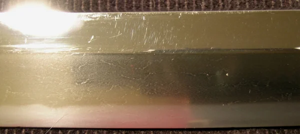

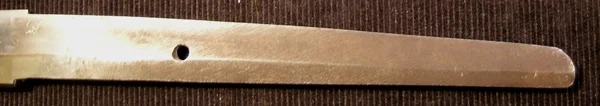

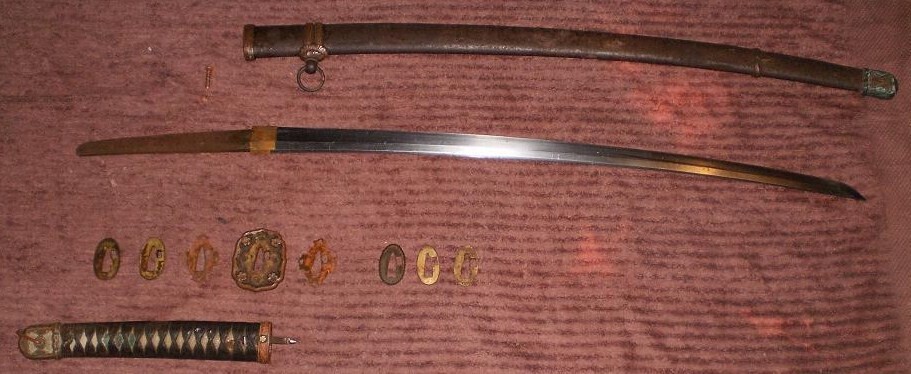

Bruce Pennington Posted May 31, 2024 Report Posted May 31, 2024 On 5/30/2024 at 2:22 PM, dwmc said: I don't think I've ever seen an oil quenched in a Choji type hamon Expand On 5/30/2024 at 2:33 PM, Brian said: Don't see much sign of oil here. Expand Ok, thanks guys. Brian, no need in my pointing. This is an area I'm completely ignorant about, which is why I am really counting on you guys who know this stuff. So, one down, a few to go. This was poste by @Nic in 2010, on THIS THREAD. It's all he posted, and he hasn't been here since then, so it might not be enough for a valued judgement, but here goes: An undated Kiyonobu And here's another undated Kiyonubo found at Japanesesword.com. Might be a better prospect for evaluation: At the risk of overload, one found on Aukshunshuset.com. Undated Kiyonobu Quote
