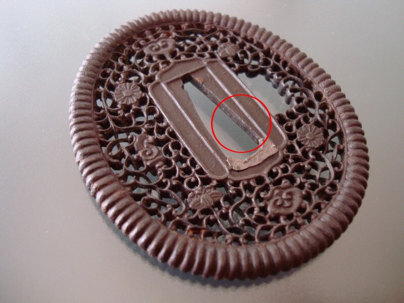

Thierry BERNARD Posted May 21, 2010 Report Posted May 21, 2010 Ford Hallam said: I think that's an amazing bit of work and a really splendid example. I like it too, best in real than in picture !!! :D :D :D Quote

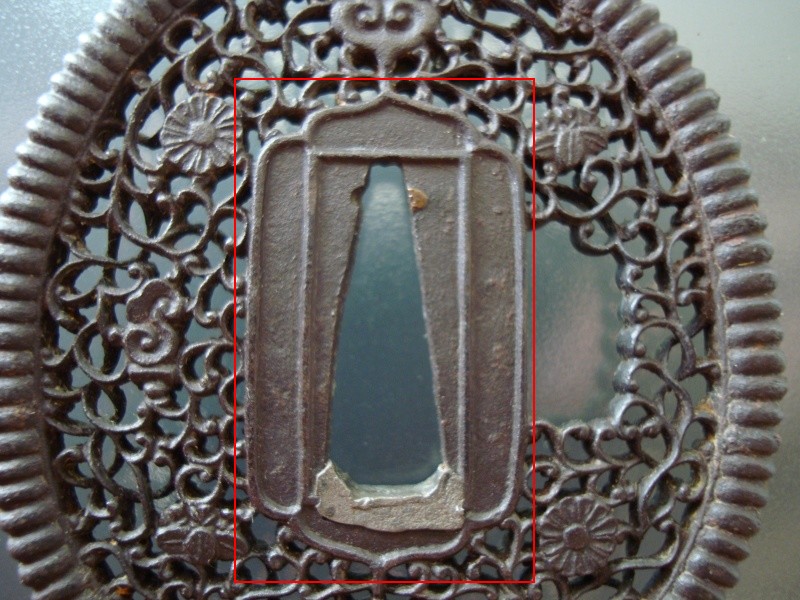

Ford Hallam Posted May 21, 2010 Author Report Posted May 21, 2010 Thierry, I have to admit this does indeed look cast. This then raises an uncomfortable suggestion. The texture inside the punched mark at the top of the nakago ana appears the same as the surrounding metal. This makes it look as though that punched mark ( the kuchibeni) was also cast. It's hard to be absolutely sure but it looks to me as though there are fine seam lines running along the sides of the tendrils. This would indicate to me that the wax original was formed in a 2 part rubber mould. A rubber mould that was made on an original tsuba. Quote
Mark Green Posted May 22, 2010 Report Posted May 22, 2010 Very nice casting job indeed!! I would think this tsuba is very young. Mark G Keith, I would say that laquer looks very new. Maybe to protect it from rust? It does have a nice shape. What size is it? You can age a tsuba in short order, with some patina mixes. Or the look of age that is. Quote
sanjuro Posted May 22, 2010 Report Posted May 22, 2010 Hi Mark I tend to agree with you, but the texture and finish are really very convincing. I've been over it with a powerful magnifying glass and still cant find a casting flash. It's most certainly not the usual casting finish. Its also quite heavy for a cast piece. I think I bought it because it looked so good even though I suspected it was cast. The size is 2 5/8 inches both across and top to bottom. The lacquer.... Well who knows? its worn in places but extremely hard and quite a thin coating. Maybe recent as you suggest. Quote

Lee Bray Posted May 24, 2010 Report Posted May 24, 2010 Are you sure this latest piece is cast? I can't believe they would add a shakudo fukurin if it were cast, seems too much trouble. I honestly don't see it as 'obviously cast' but that's not saying a great deal... Quote

Mark Green Posted May 24, 2010 Report Posted May 24, 2010 Kieth, I'm not so sure yours is cast. I was talking about thierry's nice tsuba being the wonderful casting job. I wouldn't think Chuck's was cast. But the pics are not that good. It would seem very unlikely that a nice Shakudo rim cover would have been added to a cast tsuba. Those nakago ana, punch crimps, do look a bit suspect though. Mark G Quote
Ford Hallam Posted May 24, 2010 Author Report Posted May 24, 2010 Chuck, I'm afraid I would be inclined to view your tsuba with suspicion. The surface does look to have that very characteristic "as cast" granular/ "wet sand" appearance. The kuchi-beni ( punch marks around the nakago ana, look to have the same "as cast" texture and the copper seki-gane doesn't look as though it was ever shaped to accept a nakago. The black patina on the seki-gane is not at all convincing to me either. Copper doesn't go black like that unless some sort of proprietary, instant patination fluid is applied. I suspect the "shakudo" rim is actually copper also and has been similarly patinated. I find the black to be far too blotchy and "stained" to convince me it's a genuine shakudo patina. Fitting a simple rim like that is quite easy and would be very helpful in hiding the inevitable seam that the wax model would have had. It's very hard to see but the inner edges of the openings (nakago-ana and hitsu) do look a bit suspect. apologies for not being able to be more reassuring. regards, ford Quote

Mark Green Posted May 24, 2010 Report Posted May 24, 2010 Hi Keith, Sorry for the confusion. We have not heard Ford Sensei's take on your tsuba yet. Maybe you could post a few new pics at an angle, under good light, so we can see the inner walls. I'm sure Ford will be able to tell. he seems to be the master at this game for sure. Just makes you wonder how many of these cast tsuba are out there in peoples collections. Some are very hard to spot. Ford, Great analysis on that last one. Do you think the sellers are just that ignorant, or just lieing to make the sale? Or some of both? Quote

chuck Posted May 26, 2010 Report Posted May 26, 2010 Sorry to derail this discussion of rim-pinging and nibbling and suchlike, but I am in a quandry regarding what do about this tsuba. I've finally got it in hand, and I can see clearly that it is cast. Thanks to you guys, I've had an education in what to look for (not only is this one cast, there's another one in my collection which is also fake. Grrrr...) the problem is - I like the tsuba. Especially now that I know it's a fake, because I have a sword project I'm working on that I can use it for, and I won't feel guilty about using an actual real antique for it. If I had paid $400 or more for it, I'd be feeling angry and ripped off, but for $200... I mean, can you really get an antique tsuba with a real shakudo rim for $200? That should have been a tip-off right there that this was a fake. In terms of reproduction tsubas - Fred Lohman offers his tsubas for about $100, and this one is far superior to a Lohman tsuba - he makes no pretense that his are anything other than modern copies, while this one has to pass as an antique. So it should look better than his. Some of the reproduction tsubas at swordstore.com go as high as $240. (side note: I have a Sword Store iaito. The rim of the tsuba chimes beautifully when pinged. It's not an antique.) SO... to sum up... The item was a fake and not an antique, which is disappointing, but I did get a spiffy reproduction tsuba that I can use. I probably overpaid a bit for it, but I wasn't grossly ripped off. My questions are: Should I try to negotiate with the seller for a partial refund (say, $50 to $100) since the item is not as described? And how to translate all this mess into feedback for the seller? I'm not sure if positive (it is a spiffy tsuba, and was delivered promptly), neutral (it was not as described, but OTOH I didn't get ripped off), or negative (this seller sells fakes!! Run away!! Run away!!) is appropriate here. What to do? peace. (EDIT: postscript) I just tried the "ping" test with the new tsuba and the other one I suspect may be a fake, and both passed. They Ping. No Thud. So either I am wrong about them, or the fakers are on to youse guys and are casting pingable tsubas. Quote
