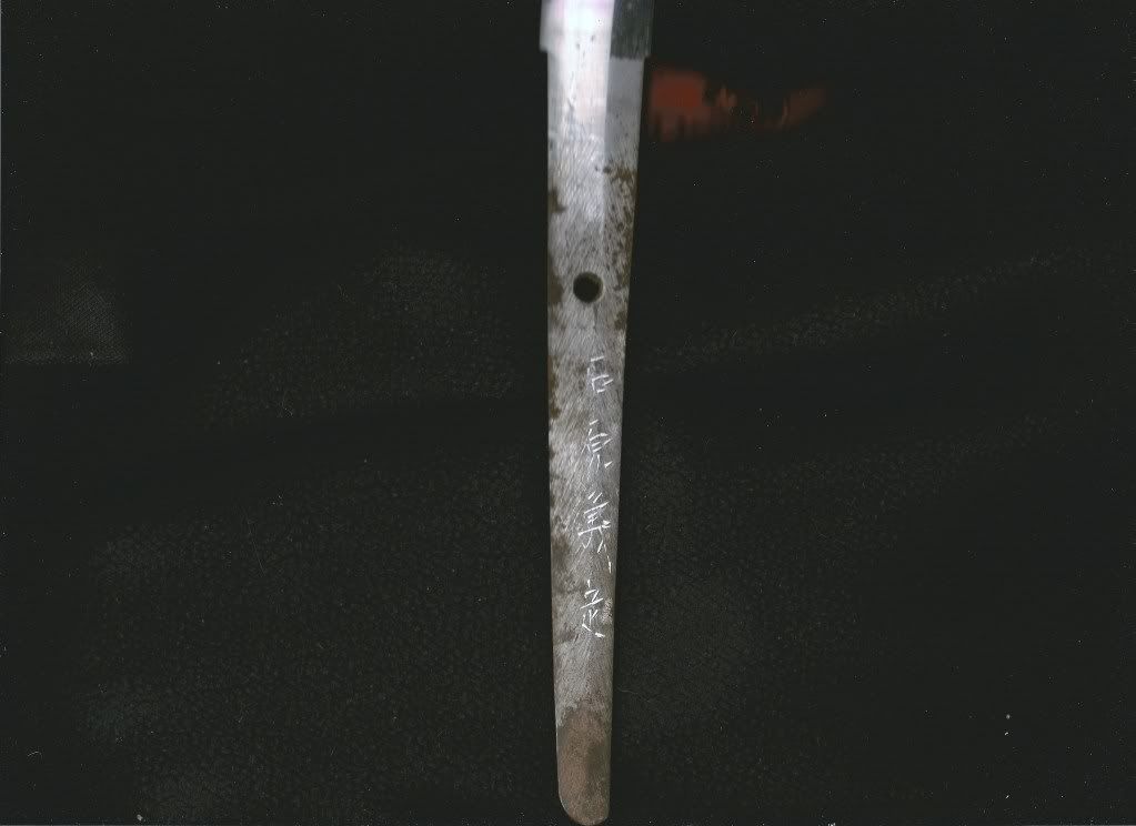

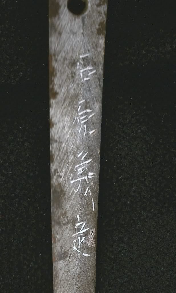

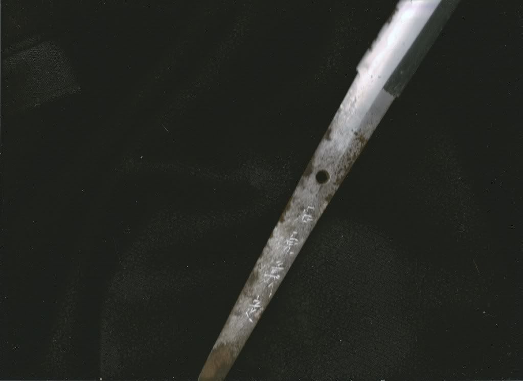

jason_mazzy Posted May 10, 2010 Report Posted May 10, 2010 This was a gamble from an online listing. Basically said he bought an abandoned house full of junk and this sword was in it. He didnt think it was real. I am very excited to say it is indeed real. But I do not know if it is gendaito, or shinshinto. The sword had been sitting in a basement in a scabbard for at least 35 years. The saya split, and the kissaki unfortunately has deep rust, but I do not believe it is through the skin stell. the rest of the blades is amazing, but there is little patina or rust on the nakago. Here is the mei, I cannot scan this blade because it is huge. Will try to borrow a camera to show you the amazing hamon. Thank you all so much. Quote
Stephen Posted May 10, 2010 Report Posted May 10, 2010 Jason if you have a program to crop some of the scan you may have closer pix, yoshi someone looks like the late war chippy mei id expect a stamp of somekind. Quote

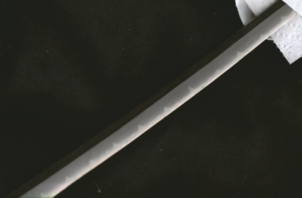

jason_mazzy Posted May 10, 2010 Author Report Posted May 10, 2010 The hamon on this is quite spectacular. has to be prewar Quote
Stephen Posted May 10, 2010 Report Posted May 10, 2010 not a date on the other side?, dont have to be pre war es with the chippy mei Quote
jason_mazzy Posted May 10, 2010 Author Report Posted May 10, 2010 I cannot figure it out. i crop it and it doesnt get bigger Quote
Stephen Posted May 10, 2010 Report Posted May 10, 2010 my scaner has a preview that i can crop to just what is being scaned. sending a PM about your jumping in with both feet and arms and wallet Quote
jason_mazzy Posted May 10, 2010 Author Report Posted May 10, 2010 my scaner has a preview that i can crop to just what is being scaned. sending a PM about your jumping in with both feet and arms and wallet lol I am done buying for now. just made all these purchases in a short timeframe. gotta hold it now. but you can not pass on a full size katana for less than dinner and a movie. Quote
Grey Doffin Posted May 10, 2010 Report Posted May 10, 2010 Masa something Yoshisada. I would be surprised if this isn't WWII. Grey Quote
Stephen Posted May 10, 2010 Report Posted May 10, 2010 wasnt sure if it was Sada or tada...hard to tell on them showato made meis Quote
Brian Posted May 10, 2010 Report Posted May 10, 2010 Jason, Don't jump to conclusions just yet. As Stephen said, once you get to know WW2 swords pretty well, these "chippy" mei stand out like crazy. Although we could be wrong of course, I am betting that we aren't, and this is a standard wartime blade. Brian Edit: Ah..I see Grey agrees. Quote
jason_mazzy Posted May 10, 2010 Author Report Posted May 10, 2010 Sorry about my confusing post, what I meant was it was not an arsenal blade. no stamps, definately tamahagane, and the most beautiful hamon. I do believe it to be gendaito. Quote

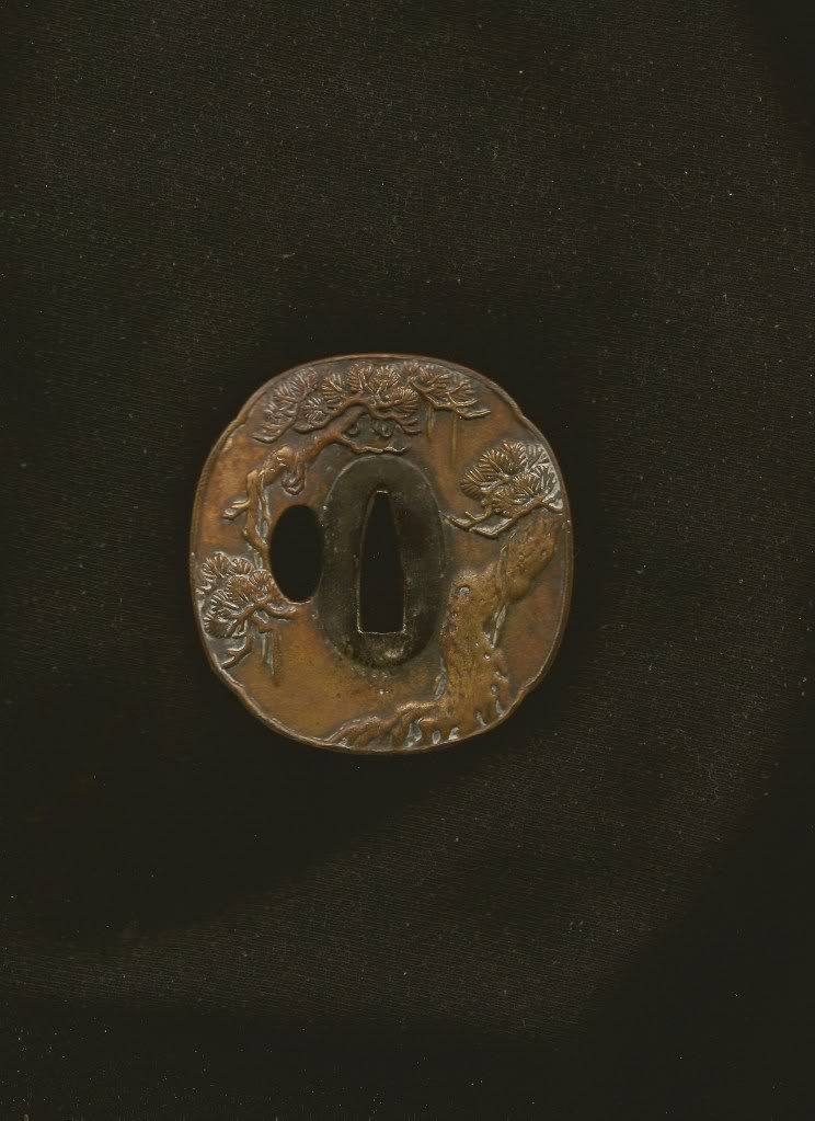

jason_mazzy Posted May 10, 2010 Author Report Posted May 10, 2010 Here is the tsuba. the fittings match perfectly, not sure about the menuki looks like bamboo leaves with gold inlay. but only 1 unfortunately. Quote
SwordGuyJoe Posted May 10, 2010 Report Posted May 10, 2010 This is a WWII blade and looks like showa era 'civilian' tsuba. This if Koichi San or Morita San may disagree, but I think this is a seki tosho smith Ishihara Yoshisada (石原義定). He is listed on Dr. Stein's site (http://home.earthlink.net/~ttstein/seki.htm) about a third of the way down the page. Quote

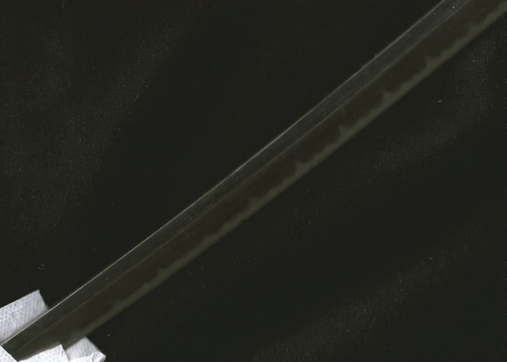

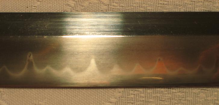

jason_mazzy Posted May 10, 2010 Author Report Posted May 10, 2010 will try when i get home. It is kinda like gunome, with sharks teeth every 3 or 4 waves. then there are lil globes inside the gunome and hamon. really quite neat. Quote
Stephen Posted May 10, 2010 Report Posted May 10, 2010 http://home.earthlink.net/~ttstein/yoshsad2.jpg does not quite look the same, many factory blades had some names chipped into them, dont get your hopes up. Quote
mdiddy Posted May 10, 2010 Report Posted May 10, 2010 "Lil globes" at the peaks of the gunome are a tell-tell sign of Showato. Quote
Stephen Posted May 10, 2010 Report Posted May 10, 2010 peaks evey three or four is sanbonsugi ....most likly a seki blade for the war. Quote
jason_mazzy Posted May 10, 2010 Author Report Posted May 10, 2010 the globes are below the gunome in the hamon Quote

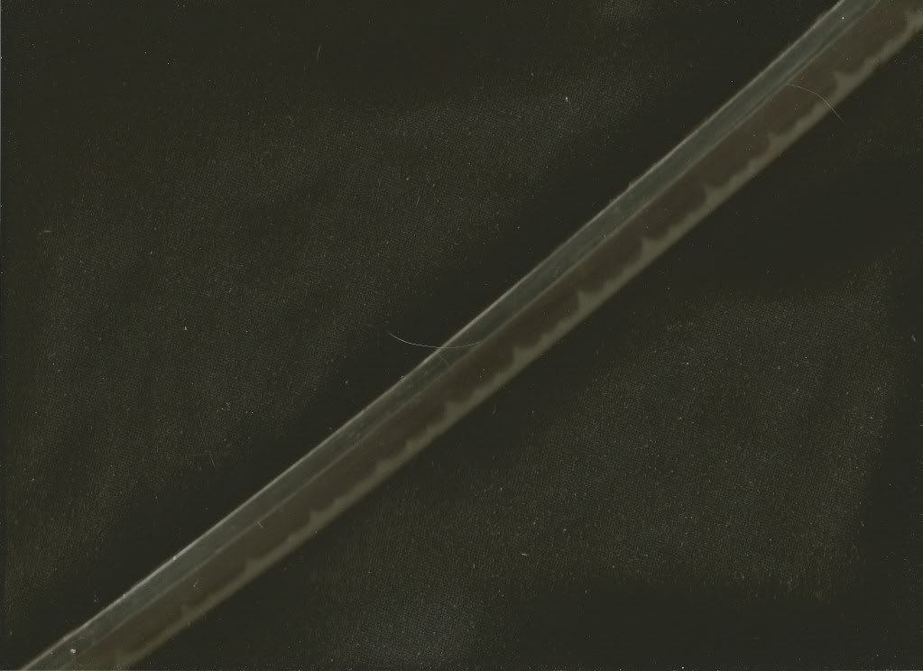

jason_mazzy Posted May 10, 2010 Author Report Posted May 10, 2010 Best I can get without a camera. But it doesnt do the hamon justice. Found the term for whats in the hamon Nioi kuzure. apparently seen in mt fuji hamons. and this looks alot like mt fuji type hamon that is in the connoisseur's, with the kuzure in it. page 100 for referance. nakago yasurime is takanoha Quote
mdiddy Posted May 10, 2010 Report Posted May 10, 2010 I'd call it Sanbon-sugi. Two short peaks followed by a third larger peak in repetition. Pg. 93 and 95 in Connoisseur's. Here's a link too: http://www.nihontoantiques.com/g106.htm. And a sample below from a Seki katana. Quote
jason_mazzy Posted May 10, 2010 Author Report Posted May 10, 2010 Sanbon-sugi hamon Nioi kuzure would be the right way to say it then? Quote
SwordGuyJoe Posted May 10, 2010 Report Posted May 10, 2010 I may be wrong on the name, since lining these up with kanji on computer is tough for me, but that's relatively irrelevant. If the yasurime didn't tell you it was seki tosho, the combination of that plus hamon sure did - it's definitely sanbon-sugi. If you really like this type of sword (Seki showa period blades), you are going to have a field day, since these are relatively easy to find. Just go to any militaria show and you should be able to find at least a dozen. Do you think this is gendai? Can you say why? Too tough to see any nie or nioi in the scan, so it looks at first blush to be showato. Quote
