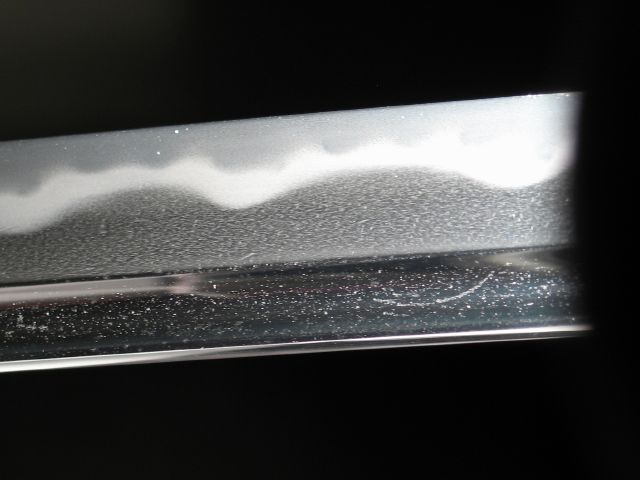

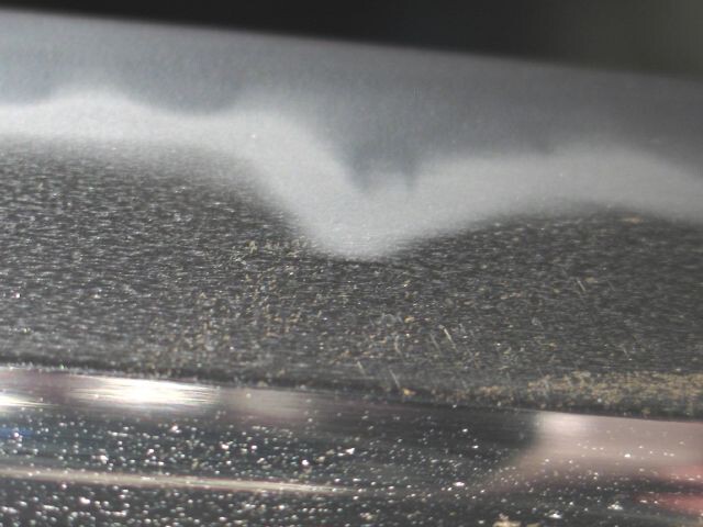

This blade is by 23rd Kanefusa.
The jigane was described as "ko-itame" (Japanese seller). Try as I might, I don't see ko-itame. Seems that ko-itame is used as a catchall if the hada is indistinct or difficuly to read.
What are your thoughts?
Hi Todd,
I would call that ko-itame or even itame. Konuka is a much finer grain, very close to muji or no grain. Of course, my opinion and a buck gets you on the bus.
Grey
Keith,
I encline to say Itame though I had an hesitation, that's the problem with these Macro Pictures.
Todd, you must tell me how you did them, they are very good indeed. Scanned or pictured? and if with camera, which lens?
Jean;
With blade in hand there is no discernable pattern; ie. burl/woodgrain/straight grain, hence my confusion. It simple appears as a uniform homogenous mass, as seen in photos.
It is a most pleasant effect.
The photos were shot with an (antiquated) Canon "Powershot" G6 (which has a "macro/super macro" feature) and a halogen reading lamp.
I assure you, if I can figure this stuff out (at my age and loathing of change), anyone can.

Is 23rd Kanefusa the Showa-period Kanefusa?
I think of Konuka as what I see in the photos below.

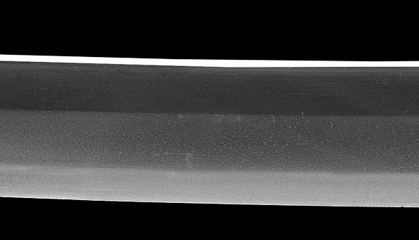

FWIW, I took the 2nd pic with a 10MP Canon SLR under orange light. I prefer larger MP and then zoom in later when I crop the photo. Probably same result as nice macro function but at least I can claim to be a photog snob with SLR! :rotfl:

"konuka hada" is usually reserved for describing the hada seen in Hizen-to, which is dense, tightly packed and covered in ji-nie and chikei such that it looks like rice bran...It is quite distinct and once you have seen it in a well polished blade you won't forget it....
It is very unusual to see any visible hada in a 23 dai Kanefusa gunto. The fact that it is only discernible when photographed with a macro lens means that it is most likely best described as "ko-itame, muji-fu"...
As seen in this photo, Kanefusa was a very capable smith. Unfortunately nearly all we see of his work are the factory made gunto of low quality. In truth, he was a very good smith who rarely, during the war years, made the time to make a traditional blade. I have seen umpteen dozens of the factory made blades but only one or two special order, traditionally made blades. Those few were very well made.....Another problem is the rather poor polish most of these Seki blades received. Some can be surprising with a proper polish.....
