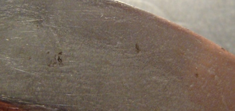

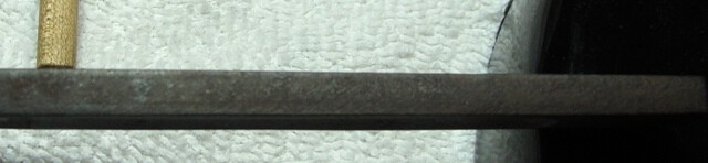

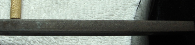

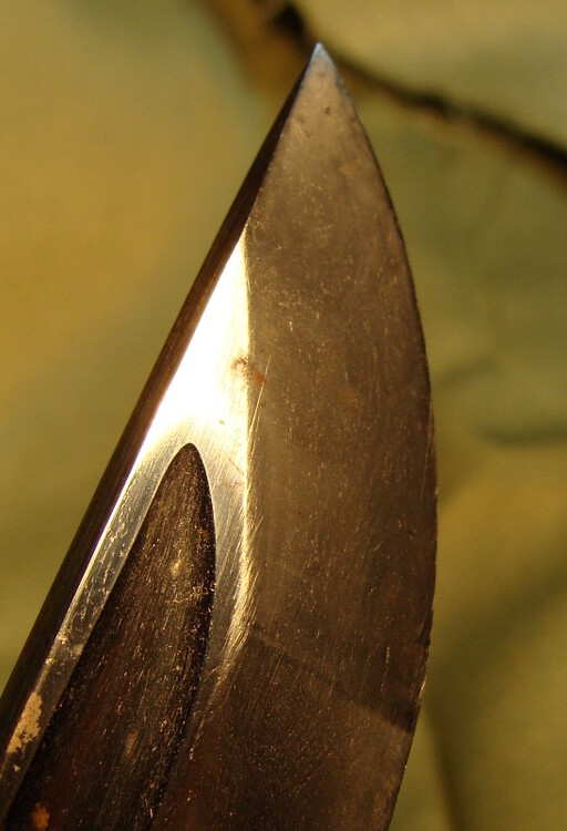

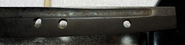

Mark Green Posted May 11, 2010 Author Report Posted May 11, 2010 Ok took a few more of the nakago. Someone did a very nice job on the finish work. File work on the end Is that a line between Jacket steel and core steel, that I am seeing along the mune side of the Nakago, or am I seeing things? Just looking at the top and bottom of the 'now' nakago. I would think the original machi was close to the area marked by the wood. I will try to see where that line of jacket steel/core steel ends, (if thats what I'm seeing) that may tell us a lot. I will try to get some good, full lenght shots tomorrow Quote
Mark Green Posted May 11, 2010 Author Report Posted May 11, 2010 What are ya'lls thoughts about that? Quote
raven2 Posted May 11, 2010 Report Posted May 11, 2010 Hi Mark, I am not sure about the Rai school attribution, but it certainly could be. No matter what, it is a beautiful hada and an impressive blade. Quote
Curran Posted May 11, 2010 Report Posted May 11, 2010 Mark, Great photos of the nakago you posted today. --Camera work and I mix worse than oil and water-- I expected Tom or Ted T. to come along and hit the nail on the head, but I think I will try and take a break from my gawd awful work to crack open the mini library and see if I cannot make sense of what I see. I still don't understand the hamon. Any Nie at all? If so, where and what sort of distribution? Quote

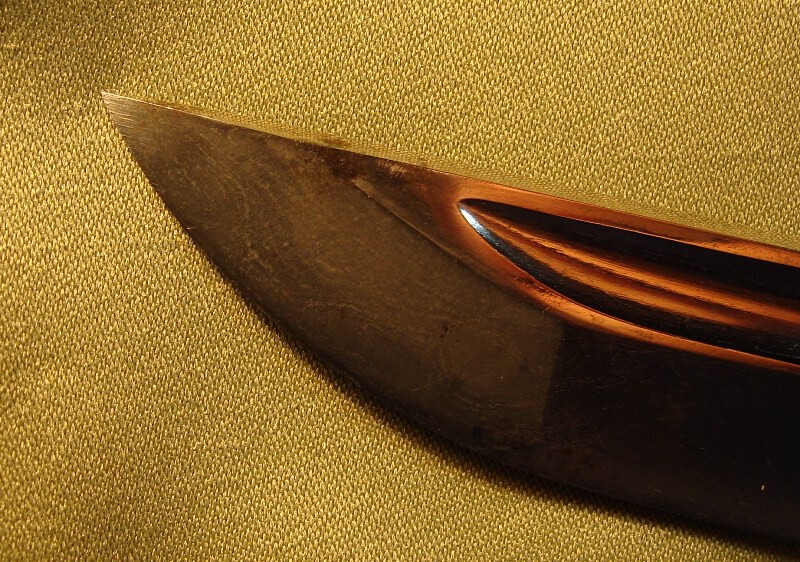

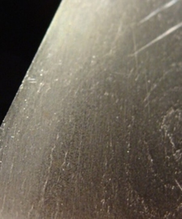

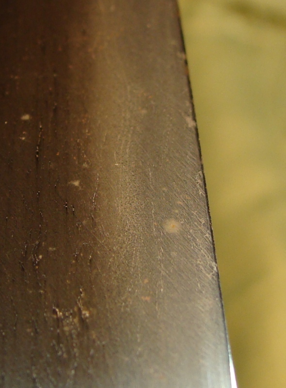

Mark Green Posted May 11, 2010 Author Report Posted May 11, 2010 Hi Gang, Yes, there seems to be a good bit of ura-nie running the length of the sword, just above the hamon, as expected. There seems to be so much ji-nie, and much chikei, throughout the jigane. The polish is quite scuffed up so it is difficult to get good nie pics. Here are a few I have enlarged of the nie, and chikei in the Boshi Quote
Mark Green Posted May 25, 2010 Author Report Posted May 25, 2010 I took a few more pics. My camera like to take close pics, but I haven't yet figured out how to get good long pics. I've been doing a lot of research, I feel now that this sword may well have been 80cm or longer. With a 1.7 or so torisori. I'm starting to think it is much older then I first thought. I tried to get a shot of the activity in the hamon. I feel it should go to shinsa. Who has the Shinsa service deals going for SF show? I will be away that week. Quote

Darcy Posted February 14, 2012 Report Posted February 14, 2012 other than battle damage, or the non samurai clause, why else would a sword be shortened? A nice sword with bo-hi, cut nakago and several remounts seems to me to be a good candidate for some kind of action other than sitting on the mantle, overhearing politics. Reasons to shorten a sword: 1. I'm short and don't ride a horse and this here sword is too long. 2. I want this sword, in those mounts. 3. Oops, I accidentally the sword in half. 4. Ooops, forgot to oil this one over the last century and too bad about that sukashi rust. 5. Oooops, I accidentally polished through your hamon. I fixed your tachi by turning it into a wakizashi. Your bill is for full polish of the katana plus o-suriage. If you want me to move the Sadamune mei into the new position that will be extra. Ah don't worry, I think you should just forget about it because most of his are not signed anyway, this way it will just blend in with the others. Save the money. Quote

george trotter Posted February 15, 2012 Report Posted February 15, 2012 other than battle damage, or the non samurai clause, why else would a sword be shortened? A nice sword with bo-hi, cut nakago and several remounts seems to me to be a good candidate for some kind of action other than sitting on the mantle, overhearing politics. I've come into this just now, but have to say there is one prime reason that old swords were shortened in more modern times...as this one seems to me to be... I've seen a few koto o-suriage Kyugunto mounted swords over the past few years or so and I must say the shape, style, placement of the last (top) hole and "freshness" of the this nakago shortening, and the overall shorter length of the sword, reminds me strongly of these o-suriage blades in Kyugunto mounts of Meiji era. So, would I be crazy to say this blade looks to me to be a prime candidate of a sword shortened for a kyugunto usage? The sword lengths of modern era (especially it seems Meiji era) military use were much shorter than of previous eras so this explains why the sword was shortened "recently" IMHO. What were the fittings Mark...any clues? Even if we never know...still a nice Den Uda Kunimune blade...congrats indeed. Regards, Quote
