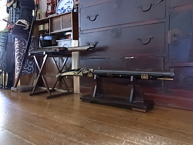

As to the oil on wood question, this thread has now given me reason to consider maybe lightly oiling the insides of the stocks. Many old Tanegashima have splits alongside the stocks where the wood has shrunk alongside the barrel, but the metal has refused to shrink correspondingly.
