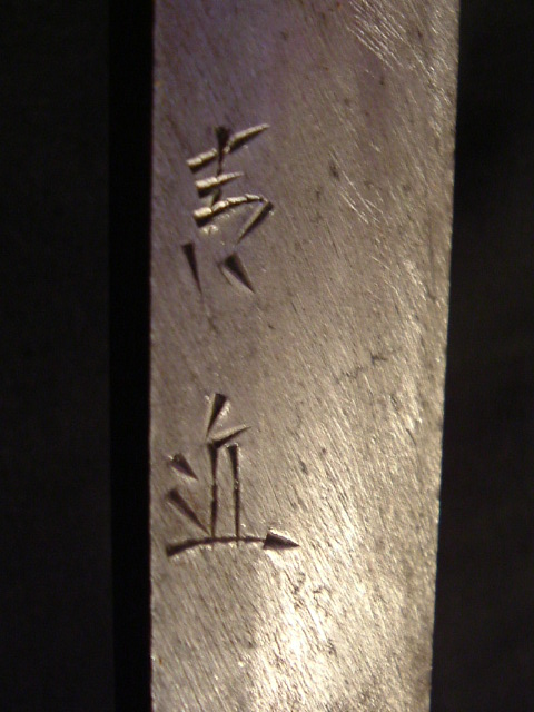

RussellM Posted April 30, 2010 Report Posted April 30, 2010 Greetings all, I'm a new member here and I am hoping you may be able to shed some information on the maker of this blade. I believe his name is Yoshichika. There are also two stamps on the nakago. I'm told this blade was made in March 1944, and it is in Type 3 Shin Gunto combat mounts, with a steel scabbard. Any info on the maker, the meaning of the stamps, and method of manufacture would be greatly appreciated. Pics to follow, taken by the previous owner: Regards Russ Quote

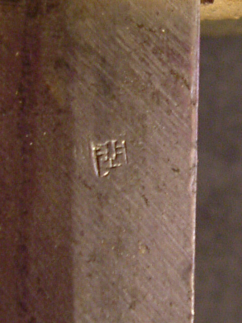

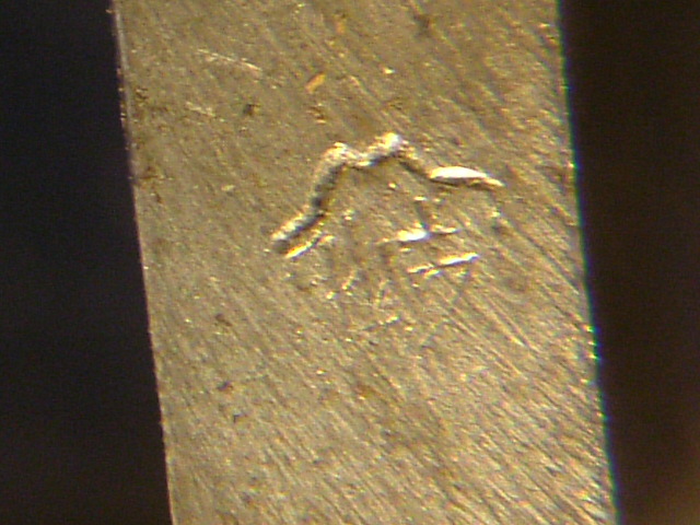

John A Stuart Posted April 30, 2010 Report Posted April 30, 2010 It has the Nagoya mark, 名 and the Seki mark 関 and the Chimata stamp. John Quote

John A Stuart Posted April 30, 2010 Report Posted April 30, 2010 I actually do not know what it signifies. It has the characters 山支 which could mean Yamashi or Sanshi or some short form for somewhere. John Quote
george trotter Posted April 30, 2010 Report Posted April 30, 2010 It is read "Chimata" sometimes, but in WWII swords it is read "Ki or Gi" for Gifu prefecture where Nagoya is situated. Literally, it means "a fork in the road", which is probably how Nagoya came into existence, as situated at the juncture of two trading routes. These three inspection/quality stamps are good evidence that your sword is probably the oil-quenched blade made in great numbers for the Army between 1943-1945. This blade is signed (I think) Yoshichika...he was a Seki Tosho working at Seki between 26th April 1943 and 1945...his family name is Yoshioka Tetsu?jiro or Ko?jiro. Regards, George. Quote
John A Stuart Posted April 30, 2010 Report Posted April 30, 2010 Right on George, I forgot that it is really one kanji, 岐 Gi. Nuts. John Quote
george trotter Posted April 30, 2010 Report Posted April 30, 2010 Nuts to me too John, i forgot that Seki, a major town in Gifu also, means barrier (I think), probably a customs/security checkpoint on the trade route in Samurai times...so Seki and Nagoya are both relevent to "Gi" of Gifu. Regards, George. Quote

cabowen Posted May 9, 2010 Report Posted May 9, 2010 Nagoya is actually in Aichi, not Gifu Prefecture... Quote
george trotter Posted May 10, 2010 Report Posted May 10, 2010 Oh yes, you're right...Hmmm, well I suppose it must mean the sword was made in Seki (Gifu) and then, as part of the process (mounting?), passed through the Nagoya arsenal? Geo. Quote
cabowen Posted May 10, 2010 Report Posted May 10, 2010 george trotter said: Oh yes, you're right...Hmmm, well I suppose it must mean the sword was made in Seki (Gifu) and then, as part of the process (mounting?), passed through the Nagoya arsenal?Geo. Correct....I believe the Nagoya Arsenal was the closest to Seki and likely many or most gunto made in Seki went through Nagoya.... Quote
