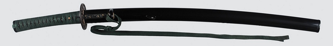

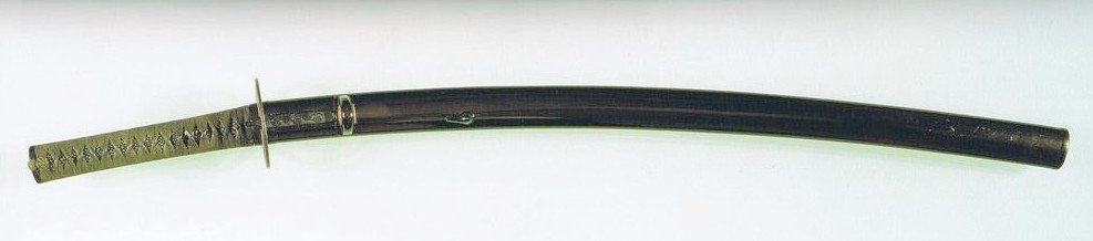

paulb Posted January 6, 2013 Report Posted January 6, 2013 Dear Jean, Opinion rather than fact and based on what I have seen over the years described a Tensho. 1. The tsuka is always waisted 2. the kashira is horn with the ito tied over it. 3. I have seen the binding in doeskin (as in my example illustrated above) and black lacquered leather, I think there was a good example of this some time ago on Fred Weisbergs site where he was selling a Juyo papered Tensho koshirae with leather (it was a stunning set) 4. Binding is always over black same 5. Other fittings are simple, the tsuba iron. 6. Saya plain black lacquer Regards Paul Quote

kunitaro Posted January 6, 2013 Report Posted January 6, 2013 Additional from what i saw in the past is Menuki were ko-mino, ko-kinko or it could be Iron menuki. Tsuba could be ko-tosho, ko-kachushi,ko-kinko, ko-mino, ko-shoami, kanayama, old Owari, but, not too big. Kozuka and Kogai should be ko-kinko or ko-mino as well. Sometime both, or only Kogai, or nothing at all. as we see Hitsu-ana of Old Tsuba. And Please look at example photos which Jean san posted the link of Tsukamaki-shi. http://www.thejapanesesword.com/forum/v ... f=29&t=278 the Fuchi is very sepacial. the height is very low, less than 1cm, could be 5mm. It could be Shakudo, old copper or iron. could be ko-mino, ko-kinko, This low Fuchi makes Tensho Koshirae looks so special. and It is in fact very difficult to find one original. Original Saya is very thin. and egg shape, Ha side is thinner than mune said. And I remember that Kaeri-tsuno is a bit different angle, sometime different shape. but not always there. However, Original one is very very rare. and i think that most of them are already Juyo papered or above. Quote

Eric H Posted January 6, 2013 Report Posted January 6, 2013 Thanks George, is the picture showing a Tensho tsuka? I have asked this question on the Samurai sword forum and it seems that your example is known as Katate Maki and is not Tensho Koshirae according to Kensen sama, well known Japanese craftsman. Jean, The pic by Richard George is Muromachi era koshirae. The Muromachi koshirae you have posted on the other forum, according to the Zufu paper... „its handle is wrapped in a style known as kangi-maki with black leather and the menuki are completely covered by the wrap“... (nihonto.com) from Sesko book e-koshirae Eric Quote
