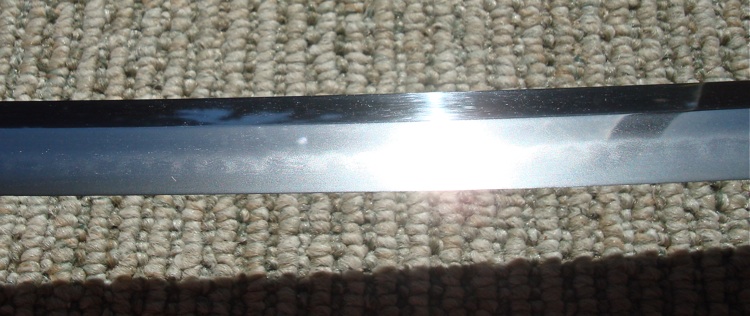

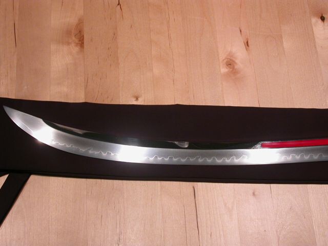

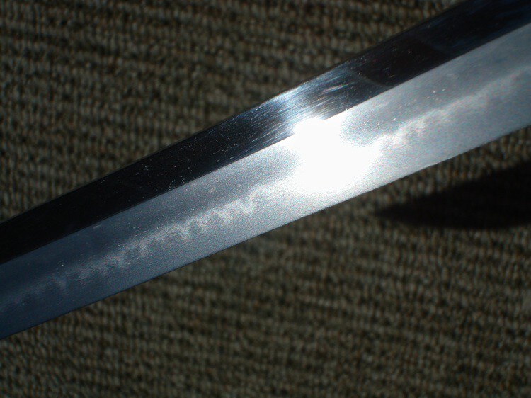

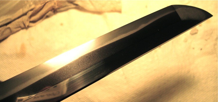

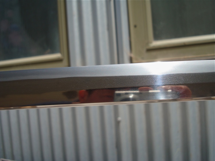

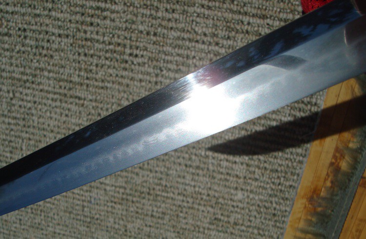

SwordGuyJoe Posted June 16, 2010 Author Report Posted June 16, 2010 Well at risk of encouraging more debate about this decision, attached are the photos of my Norimitsu. This will be polished in sashikomi to highlight the radical hada. Please keep in mind that this post was meant to share my experience with this polisher. Your point about amateur vs. professional polishers have been well made and well received. That said, have at it... Before pictures are all the way back at page one. Quote
moss Posted June 16, 2010 Report Posted June 16, 2010 Hello Joe, Are these progress shots or the finished polish? Just that you said 'This WILL be polished in sashikomi to highlight the radical hada' I'm just trying to figure out what stage it's at? Cheers Moss Quote
SwordGuyJoe Posted June 16, 2010 Author Report Posted June 16, 2010 Just a sample of a section of blade in nearly finished polish. Not complete yet, but more than just an open window. Quote
moss Posted June 16, 2010 Report Posted June 16, 2010 Look forward to the finished polish Cheers Moss Quote

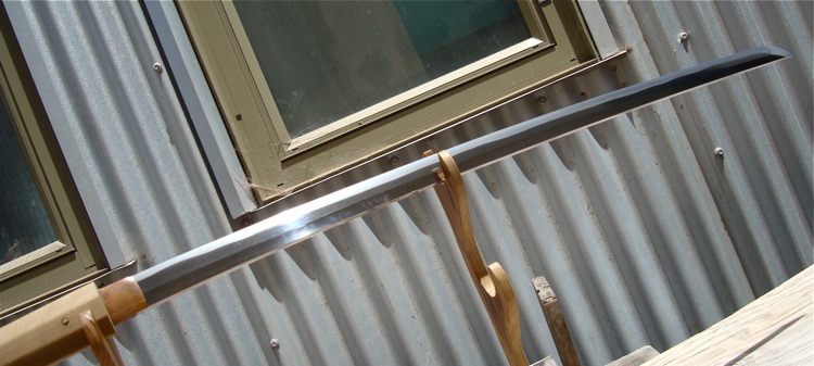

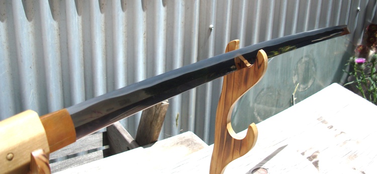

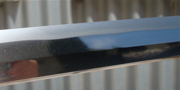

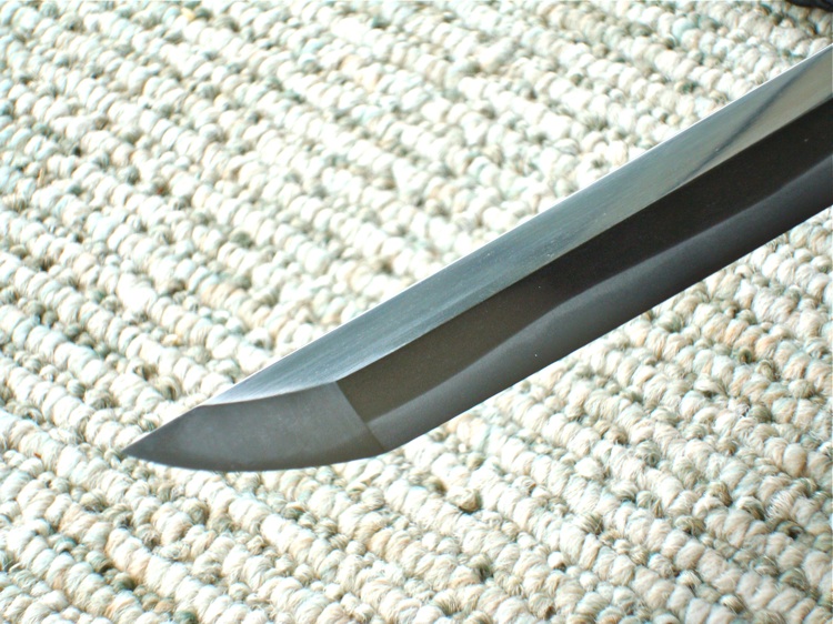

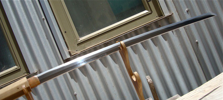

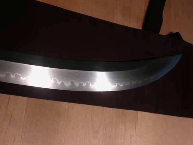

SwordGuyJoe Posted August 29, 2010 Author Report Posted August 29, 2010 This is the Shinto Kawachi no Kami Nagakuni that I just received back. Looks a lot better in hand than in the photos, but as I said from the beginning, I wanted others to be able to see the before and after of the polisher. Quote

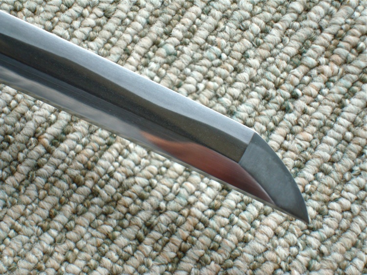

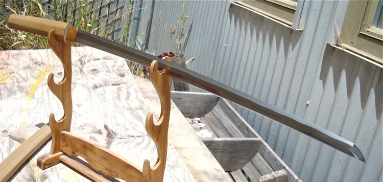

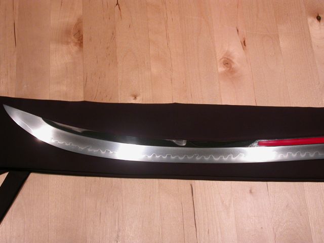

SwordGuyJoe Posted August 29, 2010 Author Report Posted August 29, 2010 ...and the rest. I understand the concerns addressed in earlier posts, but out of respect to the polisher, if you would like to give me some guff, please feel free to pm or e-mail. I think this came out pretty good and as stated, far better in hand than in these photos. Thanks for looking when the gendai blade is done, I'll post those as well. Quote
cabowen Posted August 29, 2010 Report Posted August 29, 2010 Judging a polish from pictures alone is superficial...You can tell us if it is good by doing the following: look at the reflection of an incandescent light bulb in the ji and move the blade so that the reflection travels up and down the blade. Note how the shape changes as it moves up and down the blade. If the bulb stays the same round shape up and down the blade, you have a good foundation polish, if it contorts in and out every 6 inches or so, you have a poor polish, irregardless... Looks like this blade had some kissaki damage in its past.... Quote
Jean Posted August 29, 2010 Report Posted August 29, 2010 Looks like this blade had some kissaki damage in its past.... Yes Chris it was also my thought Quote
Stephen Posted August 29, 2010 Report Posted August 29, 2010 the proof of the pudding in polish is how the kissaki turns out. Quote
SwordGuyJoe Posted August 29, 2010 Author Report Posted August 29, 2010 When I received the blade, that was the first thing that stuck out to me as well. I of course checked my 'before' photos to see if it was improperly ground down. It was not. It was difficult to see any detail before the polish and I couldn't see the boshi. So at the very least, the damage was pre-polish. Also, Chris, thanks for the tip on judging a polish by pictures. That will be very valuable! Quote
cabowen Posted August 29, 2010 Report Posted August 29, 2010 When I received the blade, that was the first thing that stuck out to me as well. I of course checked my 'before' photos to see if it was improperly ground down. It was not. It was difficult to see any detail before the polish and I couldn't see the boshi. So at the very least, the damage was pre-polish. Also, Chris, thanks for the tip on judging a polish by pictures. That will be very valuable! It would have been a good idea to move the ko-shinogi back a bit to make the width of the kissaki uniform from the yokote around and up, that is, the ko-shinogi should be parallel with the fukura. As is, the kissaki it poorly shaped, which throws of the balance of the whole blade and draws the eye to the damage, instead of away....This is something a professional would have done. The tip was on not judging a polish by pictures, but that is semantics I suppose! Most people judge a polish superficially. I have had so many people jump on me for criticizing certain well known amateurs- "Hey, he does a great job-look at his web site!" Or, "I have several blades he polished and they look great!" When I ask them to try the light bulb test, they quickly become silent......There is much more to polishing than meets the casual (and ignorant) eye.... Quote
Stephen Posted August 29, 2010 Report Posted August 29, 2010 the casual (and ignorant) eye agree but would like have said uneducated eye or less experienced. seems of late harsh words a thrown out for students who have not reached full appreciation of a blade and polish, I have Chris and Cary + many other who have taken time to teach a old dog how to lay down with swords. I thank them their knowledge and hard work. Quote
cabowen Posted August 29, 2010 Report Posted August 29, 2010 the casual (and ignorant) eye agree but would like have said uneducated eye or less experienced. seems of late harsh words a thrown out for students who have not reached full appreciation of a blade and polish, I have Chris and Cary + many other who have taken time to teach a old dog how to lay down with swords. I thank them their knowledge and hard work. Ignorant is not always a pejorative- it can mean inexperienced, untrained, etc. I did not mean to sound harsh and/or judgmental in any way.....But your point is taken and I apologies if I have come across as harsh.... Quote
cabowen Posted August 29, 2010 Report Posted August 29, 2010 the proof of the pudding in polish is how the kissaki turns out. I will respectfully disagree....It is but one component, though I will give you, an important one... Quote
SwordGuyJoe Posted August 29, 2010 Author Report Posted August 29, 2010 The tip was on not judging a polish by pictures, but that is semantics I suppose! Chris, I understood your point and apparently wrong summarized while trying to tell you thank you for sharing some insight - It sure is tough to tell you thank you. I'll pass on replying to the ignorant comment and just say thank you again. I have a lot that I could learn from you and the rest of the gentlemen on this board, Stephen and Jean are certainly on that list, and I appreciate the words of wisdom whether delivered harshly or otherwise. Quote
cabowen Posted August 29, 2010 Report Posted August 29, 2010 The tip was on not judging a polish by pictures, but that is semantics I suppose! Chris, I understood your point and apparently wrong summarized while trying to tell you thank you for sharing some insight - It sure is tough to tell you thank you. I just wanted to be sure that we understood each other. You are most welcome and if this tip helps you, I will certainly be pleased to have been of help.... I'll pass on replying to the ignorant comment and just say thank you again. I have a lot that I could learn from you and the rest of the gentlemen on this board, Stephen and Jean are certainly on that list, and I appreciate the words of wisdom whether delivered harshly or otherwise. As I explained above to Stephen, it was not meant in a pejorative sense. I should have used "untrained" or "inexperienced" to avoid having my meaning misconstrued. My apologies...... Quote
SwordGuyJoe Posted August 29, 2010 Author Report Posted August 29, 2010 No apologies necessary - I appreciate the help as always. Quote
cabowen Posted August 29, 2010 Report Posted August 29, 2010 No apologies necessary - I appreciate the help as always. And you are welcome as always... PS- Go Brett! Quote
Guido Posted August 29, 2010 Report Posted August 29, 2010 It would have been a good idea to move the ko-shinogi back a bit to make the width of the kissaki uniform from the yokote around and up, that is, the ko-shinogi should be parallel with the fukura.I think even more reshaping is necessary, and there are quite a few other points that should be addressed. However, I didn’t reply after seeing the initial post becauseI understand the concerns addressed in earlier posts, but out of respect to the polisher, if you would like to give me some guff, please feel free to pm or e-mail.although I’m a little puzzled as to why the polish is proudly presented in public, but discussion of it discouraged … Quote
SwordGuyJoe Posted August 29, 2010 Author Report Posted August 29, 2010 It's not that I am trying to discourage discussion, but I thought that the concerns of sending swords to an amateur polisher were well stated already. If people don't like the polish/workmanship and feel that saying, "See, I told you so," is necessary, I guess they can go ahead, but didn't see what that would add at this point. I am posting these pictures publicly so if people were interested in a polish and considered using this gentleman this could help them make their decision one way or the other. I am competent enough to be able to look at the blade and make my own determinations about the job that was done. I am not looking for people to tell me what a great decision I made and tell me how nice it looks or visa-versa. I am/was trying to simply give an account of my experience with this polisher and no more. I hope this answers your question/puzzlement and if any part of this comes across and snide, that certainly was not my intention. Quote
cabowen Posted August 29, 2010 Report Posted August 29, 2010 Joe- I understand your motives and appreciate you sharing, however, I think it is important for those without a lot of experience to understand exactly what constitutes a proper polish. As I have said, pictures do not tell the whole story. Simply putting up pictures such as these without any sort of critique or constructive criticism of the work has the real potential to lead people astray. Full disclosure leads to well informed consumers and ultimately, proper preservation of swords. Quote
