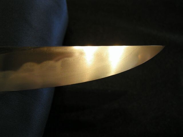

cabowen Posted June 1, 2010 Report Posted June 1, 2010 Hi Chris, I I'm curious, you said that westerners don't know how to view swords properly (can't seem to find the exact quote), can you please elaborate on that? Thanks. I said that many (not all) do not seem to know how to properly view a sword. When people say that hadori hides the detail in the hamon it means they are not looking at the blade properly because when held at eye level and pointed at a light at the appropriate angle, the hamon will light up like a neon light and all the detail is plain to see. I have seen very few people hold a blade this way to inspect it. It is the best way to see the detail.....it also allows one to play the bulb up and down the blade to check the quality of the foundation polish. If the foundation is well done the image of the bulb will remain the same size and shape as it moves up and down the blade. If it undulates and changes shapes back and forth it means the blade has waves in the surface and the polish is poor. Quote

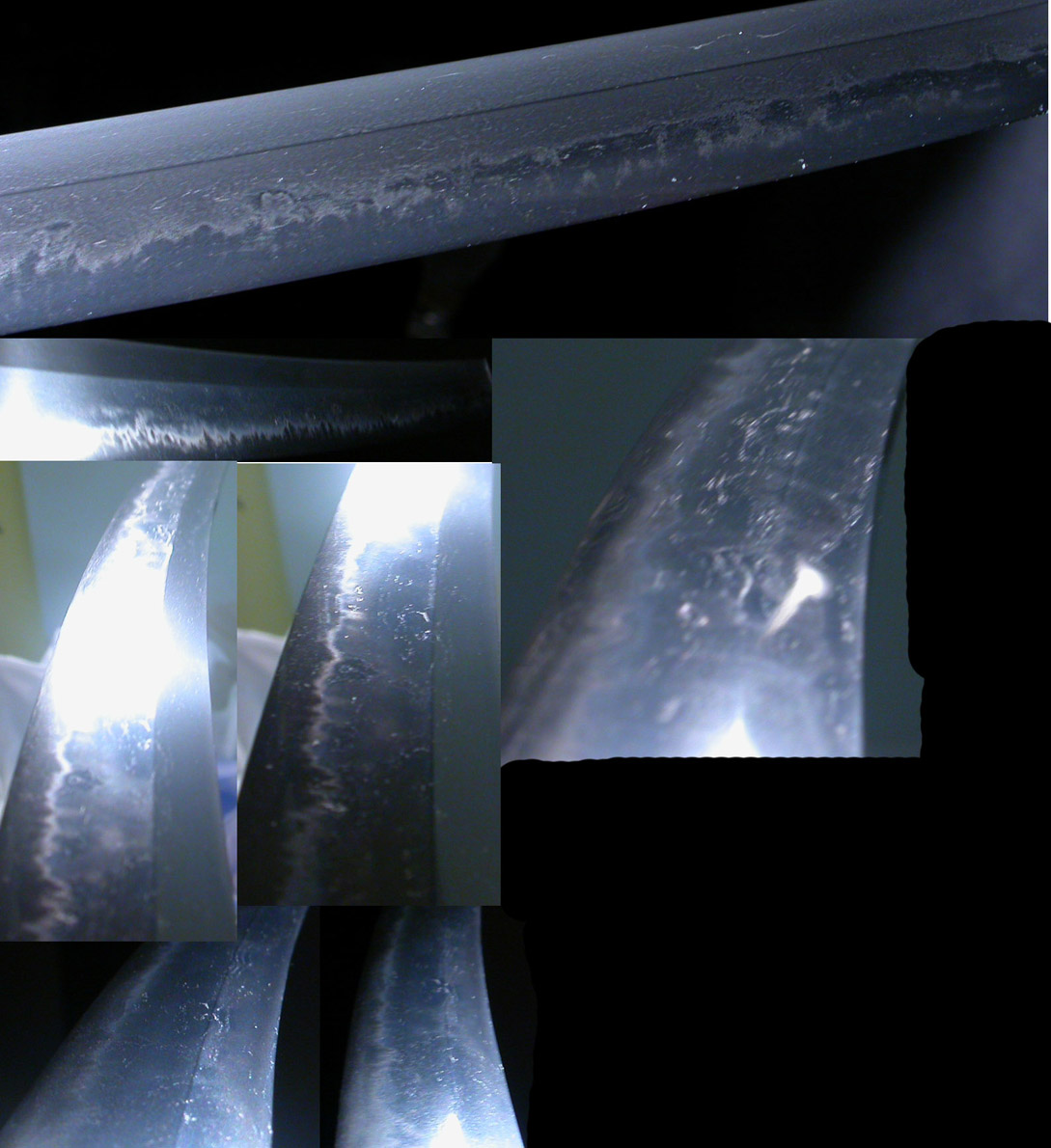

drbvac Posted June 1, 2010 Report Posted June 1, 2010 Great discussion and to throw a little wrench here is a katana with a "special" Sashikomi polish I saw for a Japanese collector who wanted this style - check out the mune and shinojigi - not burnished so the activity is all across the entire blade Quote

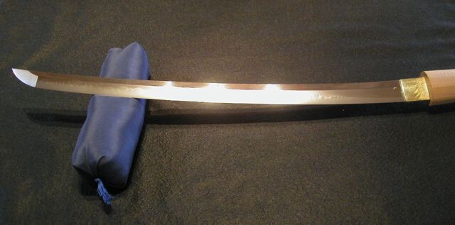

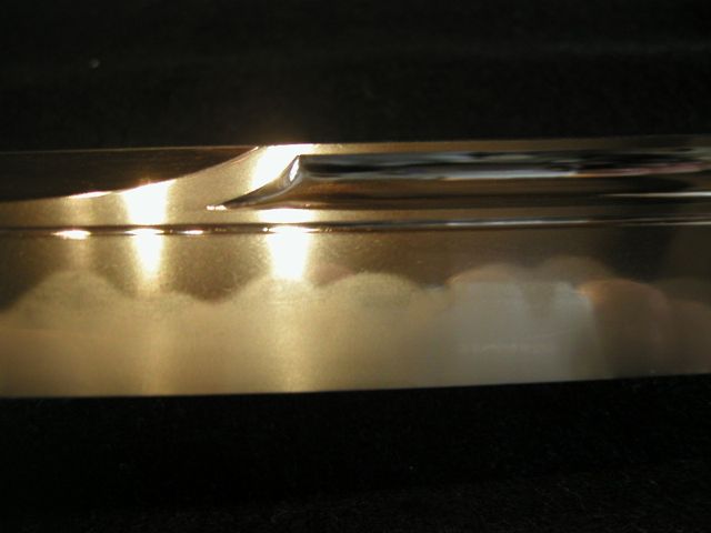

Eric H Posted June 2, 2010 Report Posted June 2, 2010 A nioi-deki blade with a tight Nioiguchi and therefore polished Sashikomi. Eric Quote

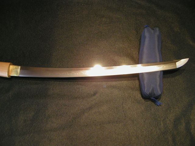

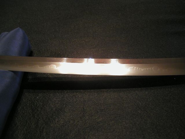

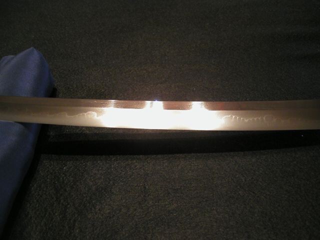

Eric H Posted June 2, 2010 Report Posted June 2, 2010 A nie-deki blade with an abundance of Hataraki polished Hadori-shiage. Regrettably I was not able to make pics of the fine details that show the beauty of this blade. This is the sword I mentioned previously that got best polish. The other was a Shodai Tadayoshi. Eric Quote
