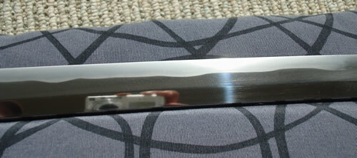

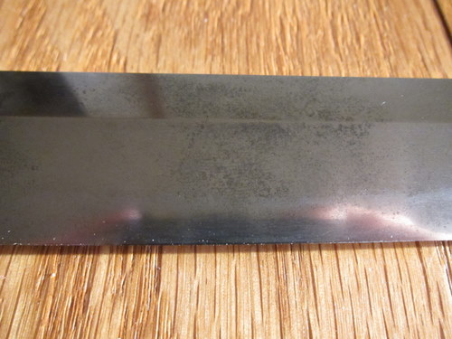

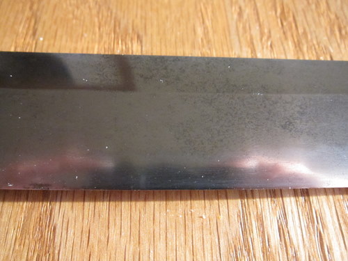

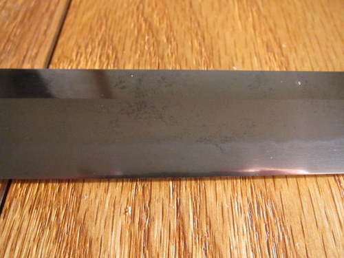

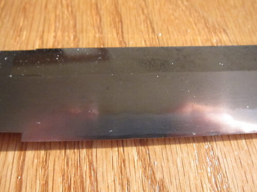

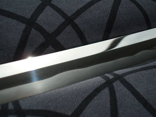

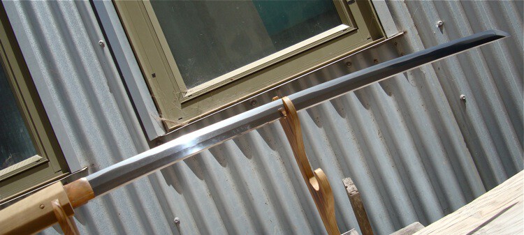

SwordGuyJoe Posted April 22, 2010 Report Posted April 22, 2010 All, I have asked folks for opinions on a polisher in a post from a few weeks ago (viewtopic.php?f=3&t=7249). I received some good responses, so I figured I would give him a try. I have sent him two blades I have discussed on this forum - a Shinto Kawachi no Kami Nagakuni (viewtopic.php?f=9&t=6951) and a gendai blade (viewtopic.php?f=50&t=7168 and viewtopic.php?f=15&t=7261). I thought it may be fun (or tragic) to show you all the progress as it comes and share my final thoughts. I have found Eric to be extremely helpful, learned, and most of all patient with my dumb questions. While I will let his craftsmanship speak for itself, but I am very excited to see the finished products. He has completed my 'window' on the Nagakuni and I attach a before picture and the four 'after' pictures below. There are also some before pics on the Nagakuni post I pasted above. Keep in mind - neither of these blades risk being ranked as Juyo, so if you are offended that I didn't seek out a juyo polish I respectfully understand, but am still very comfortable with the decision I made. Before: After: Quote

SwordGuyJoe Posted April 23, 2010 Author Report Posted April 23, 2010 Quote Joe, how long did your polish take from start to finish. Neither blade is completed yet. This is the first group of photos that I received for one of the two blades Eric is working on for me. The second, a gendai blade by Yasumoto Norimitsu, is being worked this weekend and I should be able to show the group the progress early next week. While the Shinto Nagakuni blade is far more valuable, the Norimitsu is just going to be a knock out. I can't wait to see and share it with you. Another great word of recommendation I will say to support Eric is that he seems truly passionate about what he does. I actually think he as excited as I am. Here are a couple 'before pics of the Norimitsu' and I'll share some after pics when I have them. Thank you for your kind words. Quote
raven2 Posted April 23, 2010 Report Posted April 23, 2010 Nice job. Great improvement. The blades are going to look great after they are done. Quote
Curgan Posted April 23, 2010 Report Posted April 23, 2010 Well, it seems that there are still to be found diamonds in the mud... Quote

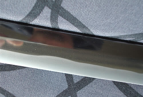

Brian Posted April 23, 2010 Report Posted April 23, 2010 I note that most comments are from relative NMB (or Nihonto?) newcommers? I must say..that is a heck of a lot of "kesho" there. Brian Edit to add: Joe...that aint no "window." You don't go the whole hog including hadori/kesho and what appears to be nugui when doing just a window. I expect that whole side is completed that way Quote
Grey Doffin Posted April 23, 2010 Report Posted April 23, 2010 Let me add, for the benefit of newcomers and maybe a few of the others, that it isn't only how shiny the sword ends up looking that matters. A proper polish removes enough of the blade to leave it with the correct for it's age and school geometry, and not an ounce more. The color of the steel has to be right, the grain has to present itself properly, and all the activity in the hamon needs to be visible. If there is going to be a defect surfacing the polisher needs to know what to do about it. And dozens other of details need to be seen to. Saying nothing about the polish or polisher in question (I don't know who Eric is), but speaking of polish in general, if you are going to have a sword polished make very certain that the polisher has proper training. Grey 1 Quote
SwordGuyJoe Posted April 23, 2010 Author Report Posted April 23, 2010 Quote Edit to add: Joe...that aint no "window." Yeah, this isn't a window. He did some work and provided me a few photos of the progress. I am really pleased with the milky kesho finish. Quote ...Grey's post... I agree with everything that you are saying. Anytime you try a new polisher, you incur a pretty significant risk. It is for this risk that I mentioned that neither of these swords are at risk of being ranked juyo any time soon, but needing of a polish. If they were, regardless of the references, I wouldn't have risked it. You are one of the many class acts here and I know you are not saying anything about the polish or polisher and appreciate the public service announcement - it is very needed. I assure you and others, this decision wasn't made lightly and was after careful conversation, research, and consideration. I am posting my experience so the rest of the board can share in my experience with a relatively unknown polisher. I do not suggest anyone make a decision based solely on what I have posted or will post, but take a lot of time, talk with people and make the best informed decision possible. Thanks again Grey Quote
David Flynn Posted April 24, 2010 Report Posted April 24, 2010 All I can say is, that to me the Hadori looks way to thick and if hiding the hataraki well........ Quote
SwordGuyJoe Posted April 24, 2010 Author Report Posted April 24, 2010 Thank you David, I appreciate your opinion. It will be interesting to see the work completed and using better photos. When I view the original high resolution photos, you can still detect the nie and nioi in the rolling gunome hamon, so the hataraki hasn't been hidden with the hadori. This is my fault by posting small format photos. I am looking forward to seeing this in hand. Thank you again David. Quote
Jean Posted April 24, 2010 Report Posted April 24, 2010 Once again, it will be very difficult to say anything without holding the blade, in fact it is impossibele. I have seen Japanese Hadori polish hide the hataraki, the only way to see them was to look at the hamon with the slightest possible angle. A midare hamon looked very much Mino with togari ... Quote
Stephen Posted April 24, 2010 Report Posted April 24, 2010 Not all togi make the same size windows, Joe in the latter photos one can see where the window ends. I think he used the full length of the the stone. I'm not a fan of Hadori but done right it can be brilliant. Quote
