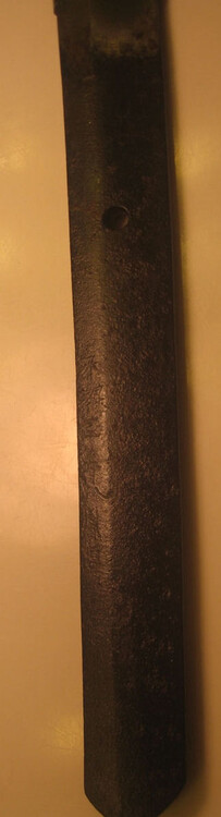

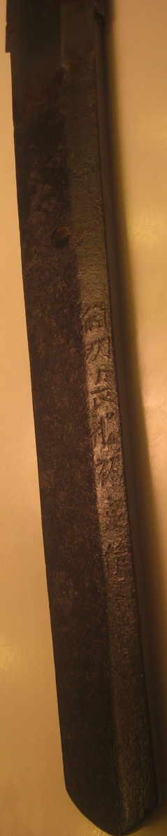

IanB Posted April 5, 2010 Report Posted April 5, 2010 Damien, The inscription on the reverse, or ura side, of the tang is a date. It starts with the year period Eiroku, which began in 1558 and finished in 1569 / 1570. The name of the year period is followed by a number of the year in that era. In this case it looks like 2 so the blade was made in the second year of Eiroku or 1570. The small scratched mark inside the hilt fitting is probably nothing more significant than a mark made by the guy assembling the sword from parts - so that the right fitting ended up on the right hilt. Ian Bottomley Quote

Nobody Posted April 5, 2010 Report Posted April 5, 2010 The inscription on the reverse, or ura side, of the tang is a date. It starts with the year period Eiroku, which began in 1558 and finished in 1569 / 1570. The name of the year period is followed by a number of the year in that era. In this case it looks like 2 so the blade was made in the second year of Eiroku or 1570. .............. Allow me to correct a minor error. The 2nd year of Eiroku era was 1559. 永禄ニ年八月日 – a day in the 8th month of the 2nd year of Eiroku Quote

IanB Posted April 5, 2010 Report Posted April 5, 2010 Daimen, Both John and Nobody have pointed out my boo-boo with the date. I had quoted the terminating date for Eiroku and then just added the digit to that instead of the start year. As I said to John, time to drag me off to the retirement home for the terminally idiotic. Sorry Daimen Mea Culpa. Ian Bottomley Quote

Jamie Posted April 5, 2010 Report Posted April 5, 2010 Zeug, It's a Tachi Mount. The mount it's in wouldn't have been overly common from the time the blade is supposedly from. And it is common to see Kanji( the etchings you are describing) on both sides. If you can, measure the Blade- From the point to the Habachi(metal Collar) notch and post your finding. That's where the metal collar meets the blade on the back side(mune). Literally the notch that the Habaki sits in. Someone translated the signature to be BishU Osafune Sukesada Right? Well that signature can mean a couple of things. To have some idea, you'd need to know the date it was forged. Usually swords signed That way were bundled literally and sold in bulk for war. But from what I understand- many signed that way earlier than the late 1500's can be good swords. I am fairly new to collecting so I have limited knowledge here. I was looking at purchasing a Tanto signed that way though so I did some research on those smiths recently. I wouldn't think a low level blade would be in a tachi mount- but they are saying(other members) that they have seen them that were sold as tourist items. So I am unsure. The blade would need to be looked at by someone qualified and they could give you more info than anyone looking at pictures of it. Then you'd also know if it would take a polish or not as well. Quote
zeugmax Posted April 6, 2010 Author Report Posted April 6, 2010 The exposed blade is 29 inches long. i compared it to a friend's modern katana and it was about 2 inches longer. Anyway, here are the pictures of the tang, after a light coat of veg oil on it. i will get mineral oil tomorrow and go over it again. The rust became darker when i did this, but i think that's ok, right? that makes sense it would do that. I included what the blade looks like under the habaki. None of the pictures have been touched up, so good luck trying to read the etchings.... Thanks! Quote

John A Stuart Posted April 6, 2010 Report Posted April 6, 2010 I've touched it up a bit. Still my eyes can't make it out much. ?shu Naga??sada Saku. Cripes!! John Quote
Stephen Posted April 6, 2010 Report Posted April 6, 2010 lets not get our undies in a bunch, veg oil is not going to cause ruin, do a search here and youll see its what old choji was made with back in the day. John must not have been reading the whole thread all ready fig out its Bishu Osafune Sukesada. Jamie and Lee lets tell him what we see from the new pix, hows the hamachi, what is the hamon? lets work together to pin point the blades work. Quote

zeugmax Posted April 6, 2010 Author Report Posted April 6, 2010 I'm not offended, but enough about the oil for now. i intend to fix it immediately....let's move forward and talk about the sword. Can you see anything? Does the quality of the etching show age? Now do you see why i used photoshop? Quote
Stephen Posted April 6, 2010 Report Posted April 6, 2010 The blade shows age, the hamaci shows us theres room for polish, the hamon is suguba(which is a clue as most bizen where choji but not all) the nakago jiri is bizen which goes with the mei, it is also ubu not cut down which helps with the value. In the late 1500's there was a mass prouductions of bizen blades which used Bishu Osafune as has been pointed out. so after i do some reading about who used suguba homon in Bishu ill get backt to ya, dont sell ehe blade short because some make it out to be Kazuuchimono (mass produced ) ....photo shop is not needed we know what it says. pix is still not facing the nakago but off to the side. is the rest of the blade in all rust? if the hamon changes from suguba to choji id like to see it and if you can see any actvity between the rust such as grain pattern. edit to add cropped and rotated pix Quote
