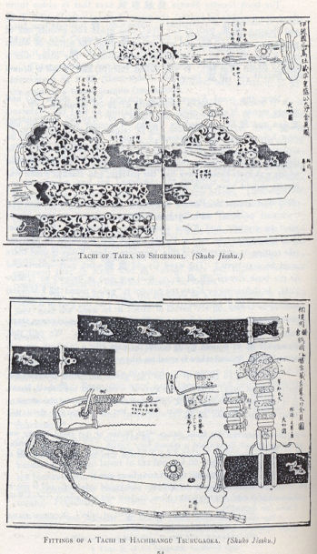

Stephen Posted March 31, 2010 Report Posted March 31, 2010 Ian really youve never seen same coverd tsuka on a tachi? seen a few prestaton swords like that, and as you have said mostly Menji era as this looks to be, but sure they did it a lot longer ago than that. scan from Sword and Same. cant remember what was on the first ed The Japanese Sword: A Comprehensive Guide ? old timers working brain i have. Quote

IanB Posted April 1, 2010 Report Posted April 1, 2010 Stephen, I am sorry I didn't make myself clear. When I said I hadn't seen a same covered tsuka on a tachi, I meant on one of these brass covered tachi made in the Meiji period. I have of course seen loads of real tachi with same tsuka. As I said, these Meiji items normally have the tsuka covered with brass sheet like the scabbard. In this genre I have seen tanto, wakizashi and tachi, all with identical stamped panels. It must have been quite a cottage industry turning them out. Sorry for the misunderstanding. Ian Bottomley Quote
