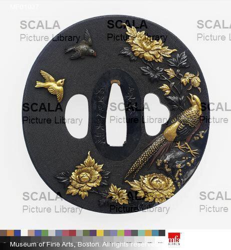

John A Stuart Posted March 29, 2010 Report Posted March 29, 2010 That's great. I responded on SFI, but, will do so here as well. This style of carving and subject matter leads me to some derivative artist of the Ishiguro school of carving. It mightn't be by a leading craftsman, but, it is competant work. A good buy, I'm thinking. John Quote
John A Stuart Posted March 29, 2010 Report Posted March 29, 2010 Here is a picture of an Ishiguro school tsuba that illustrates my reckoning. This also is mumei, but, notice how the peonies are carved. There is quite a difference in the exquisite workmanship of the BMFA tsuba, I think you will notice. John Quote
Curgan Posted March 29, 2010 Author Report Posted March 29, 2010 Indeed. The flowers look almost the same, but the Bostom Museum tsuba is a masterpiece. Especialy the peakok. Birds of prey are a trademark to ishiguro and now depicted in perfection... Quote
John A Stuart Posted March 29, 2010 Report Posted March 29, 2010 Not neccessarily birds of prey, but, birds in general. I think that is a copper pheasant 山鳥 and plovers 千鳥 chidori. Quote

nagamaki - Franco Posted March 29, 2010 Report Posted March 29, 2010 Greetings, I think that is a copper pheasant 山鳥 ..... . "Golden pheasant" http://pkhits.com/wallpapers/Animal%20and%20Birds/38397,xcitefun-golden-pheasant-chrysolophus-pictus.jpg P.S. I could be completely off, but my feeling is this subject tsuba has more of a Goto connection. Kaga comes to mind, but perhaps not any of the mainline characters. Worth submitting to shinsa imo. Quote
John A Stuart Posted March 29, 2010 Report Posted March 29, 2010 Ah yes Franco, that is more like it. 錦鶏 The 'golden chicken', John Quote
