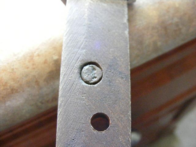

The sword has a seki stamp also and the two holes just mean that the sword has been mounted twice.eg two different handles.

As to the two holes...as Simon said, it usually means the sword has been re-hilted at some time and the new hole had to be drilled to accommodate the peg passing through a different spaced binding on the new handle. I would say however, that in the case of WWII blades which had a working life of perhaps 10 years at most, it is equally possible that the first hole was drilled when it was made...but, when it arrived at the "fitting/mounting" factory, it was found to be too "out of position" and a new hole was drilled for its mounting, before it was issued. It is found surprisingly often....it is most common on old traditional swords from re-mounting of course, but I would say rare on WWII vintage blades due to remounting...more likely from mis-placing of the first hole by the maker. Just an opinion. It is very rare to see a modern gunto with a plugged hole however...first I can remember seeing.

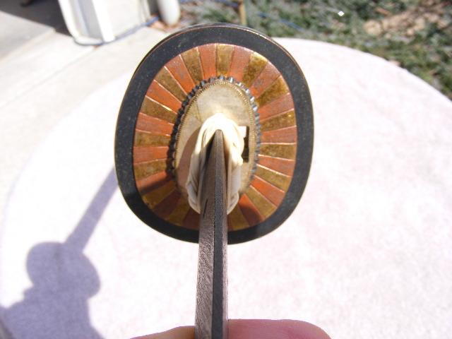

FIRST I WOULD LIKE TO THANK EVERY ONE FOR THERE HELP. (THANK YOU)
NOW LETS SEE IF I UNDERSTAND WHAT I WAS TOLD. IT WAS MADE AT THE SEKI ARSENAL FROM AROUND 1939 TO THE END OF THE WAR. THE SWORD SMITH WAS KOBAYASHI KUNIMICHI . HE IS AN AVERAGE SMITH THAT WORK AT THE SEKI ARSENAL WITH 300 TO 400 OTHER SMITH. I WILL TRY TO GET SOME MORE PICTURES UP TODAY OF THE BLADE AND YES THERES ONLY 2 HOLES. THANKS AGAIN BOB

OK I GOT IT NOW ABOUT THE ARSENAL THANKS FOR CLEARING THAT UP.

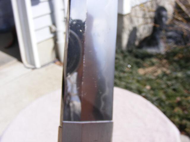

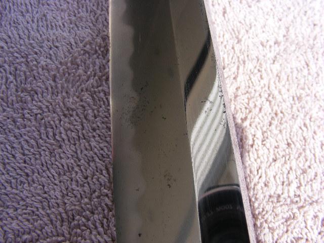

I THINK THE BLADE IS OIL TEMPER I TOOK SOME SHOTS OF THE SCRUBBED AND TRIED TO GET THE TEMPER LINE IN THERE TO.YOU GUYS LOST ME TALKING ABOUT THE (TAMAHAGANE ) WHAT DOES THAT MEAN ? ALSO IS THERE ANY WAY TO GET THOSE SPOTS OF THE BLADE?
AGAIN THANKS FOR ALL YOUR HELP
Hi Bob, Tamagahane (jewel steel) is the best steel obtained from a traditional tatara (bloomery furnace). BTW, could you not use all capitals when you post? It is very loud in a visual sense. John
