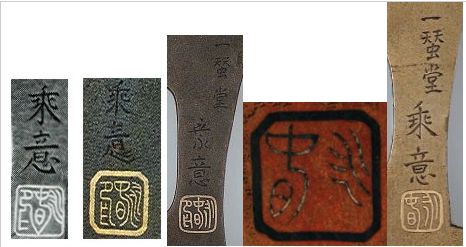

Ludolf Richter Posted March 18, 2010 Report Posted March 18, 2010 Hi experts,I am interested in a Tsuba from an auction to come signed Joi.The Mei plus the seal are shown on the right side of my pic.On the left side are 2 examples of real Joi pieces with the seal "Nagaharu",which he normally added.The left part of these seals is missing in "my" Tsuba.How do you read this seal?Ludolf Quote
Eric H Posted March 18, 2010 Report Posted March 18, 2010 By comparing the seals only, in my opinion, it's not by Issando Joi, but perhaps by one of his pupils. The seal rightmost in the pic I have added is from a forged Tsuba. I have of course noticed that the shoshin seals show slight differences among themselves. If one could see the entire workmanship of the Tsuba a judging would be more accurate. Eric Quote

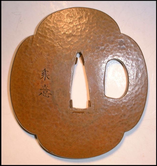

docliss Posted March 18, 2010 Report Posted March 18, 2010 Dear Ludolf I reply to your query not as an ‘expert’ but as an ‘interested party’. On p. 189c of the earlier edition of Kinkō Meikan is an illustration of a Joi mei with a seal identical to the one you illustrate. This seal is described by the author as reading Nagaharu. What, then, do the seals on your ‘real Joi pieces’ read, with their additional, and varying, character? The only other Joi seal that I have seen is that illustrated in Shōsankenshu, and described by the author as ‘early’. This is on a rather fine gimei tsuba of which I am attaching an image; I imagine this to be a Meiji work by a Mito Sekijōken artist. Regards, John L. Quote

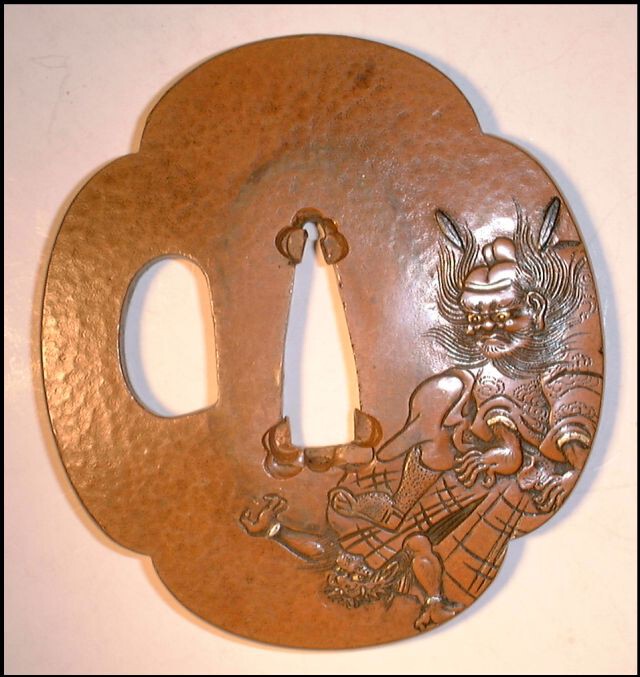

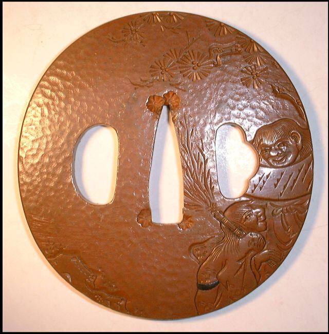

docliss Posted March 21, 2010 Report Posted March 21, 2010 ... and two more (gimei) Joi tsuba to add to the thread. John L. Quote

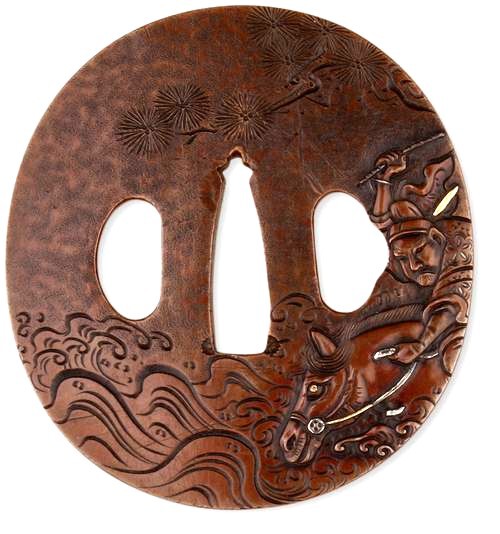

Ford Hallam Posted March 26, 2010 Report Posted March 26, 2010 I'd forgotten that I'd uploaded a few images of other genuine works by Joi :D so here's a link to my Picasa gallery where you can see them They are all viewable in larger format my clicking the little magnifying icon at top right I think it always preferable to study the finest examples so as to better appreciate what distinguishes the work of the masters from the "also rans" regards, ford Quote
Ford Hallam Posted March 27, 2010 Report Posted March 27, 2010 I've just seen this piece by Joi presented by Ginza-Choshuya. There's also a very detailed description of the work as well as some biographical material about Joi. All translated into English by Paul Martin. Quote

Brian Posted December 10, 2010 Report Posted December 10, 2010 Amazing that many of these gimei tsuba stand on their own as pretty nice work. Maybe not great work, but well above average and I wouldn't mind owning any of them. Pity the artists didn't try and improve their own works or let their work stand under their own name. Giuseppe...nice tsuba, although apparently not meant for mounting as we so often see. Ford, that real Joi you posted way back is absolutely stunning. More like a painting than a tsuba Brian Quote
Ford Hallam Posted December 10, 2010 Report Posted December 10, 2010 Hi Brian yes, it is a beautiful work and one can't fault the workmanship but I actually don't think it's by Joi either. I believe this is a much later work, in some respects more refined than the originals but it at least exhibits real artistry. Aesthetically speaking I think the example I showed is in fact more sophisticated than original Joi works. This is not to say it is (imo) better but merely informed by a different aesthetic. The most obvious give-aways for me is the relative size, ie; largeness, of the tsuba in relation to what would be the seppadai area and the very subtle surface graduation and rim formation. I think this is a very late Edo period or Meiji period work. I alluded to Unno Shomin (student of Hagia Katsuhira, Mito prov.) I see certain similarities. Another obvious possibility would by Ogawa Teikan, also from Mito. regards, ford Quote

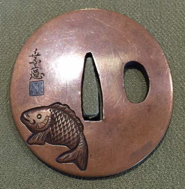

Barrie B Posted November 7, 2015 Report Posted November 7, 2015 Here's my (gimei) Joi Tsuba.. I notice that most of these Joi Tsuba seem to made of Suaka..! Is that just coincidence..? Barrie. Quote
