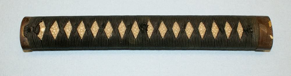

David Price Posted March 7, 2010 Report Posted March 7, 2010 OK, frist off...I am a beginner trying to learn (hopefully from others mistakes). I think this is a Nara (or Ko-Nara?) tsuba. Am I correct? I don't think is is a very good one as the stag looks like a sheep with sticks on it's head . The color in the first two photos is closer to what it looks like in-hand. Any thoughts or constructive comments? The fuchi & kashira that came with it I believe are also low quality. The tsuka does not show any signs of having ever had menuki. The mimi has what looks like white paint rubbed on it. It is not a casting seam. Thanks Dave P Quote
David Price Posted March 7, 2010 Author Report Posted March 7, 2010 The nakago is ubu and mumei. Regrettably, someone force fitted a saya to the katana. They cut out the ha side of a random saya so the habaki would fit. And the saya was too short for the blade . I bet the tip of the kissaki is still in the saya! Unfortunately, the blade is ruined ! Dave P Quote

David Price Posted March 11, 2010 Author Report Posted March 11, 2010 doug e lewis said: could not the sword be saved somehow? is the boshi to far gone not to re-shape the kassaki into a ko-kassaki shape? or is too much $$$?? a shame to lose even low end nihonto, eh? doug e It looks that the tip of the boshi is completely broken off in this photo . I had Chris Osborne look at it and he also thinks it would be a waste of time and money to try and reshape the kissaki. There just does not appear to be any tempered steel left at the tip of the kissaki. Very sad. Dave P Quote
