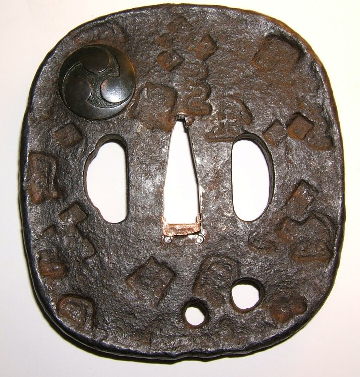

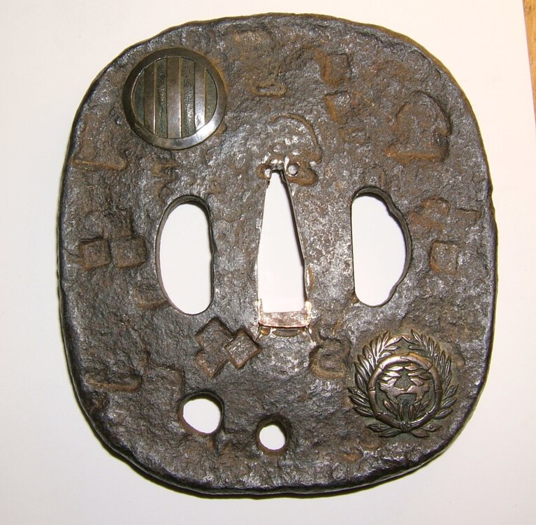

Here is the tsuba from an handachi mounted sword I own. The shape is somewhat different than many that have been posted and it has a pronounced hammered rim. The size is 8.4 x 7.7 and 0.5 cm thick through the nakago ana - so quite a heavy piece. The kamon on the front are two of those used by the Date family of Sendai, the mitsu tomoe maru on the back by too many families to identify. These are applied in a rather dark shibuichi giving them a subdued appearance against the dark iron. I suspect they have been added at a later date to the basic plate - but have been inlaid rather than just applied. In the hand you can see the KIN stamp plus another that looks rather like a snake. Most of the punched marks are simple squares.
Ian Bottomley
  • Love 1
Mine's sizes are the following:
84mm x 83mm x thickness variable in a range between 4 and 6 mm

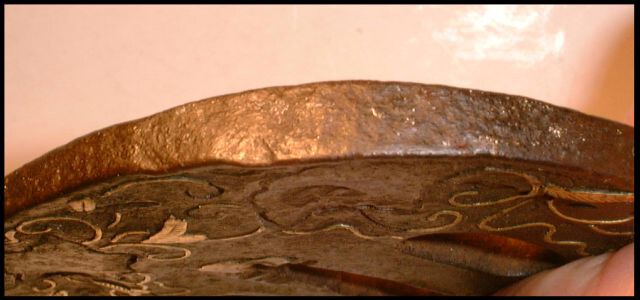

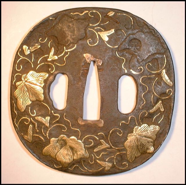

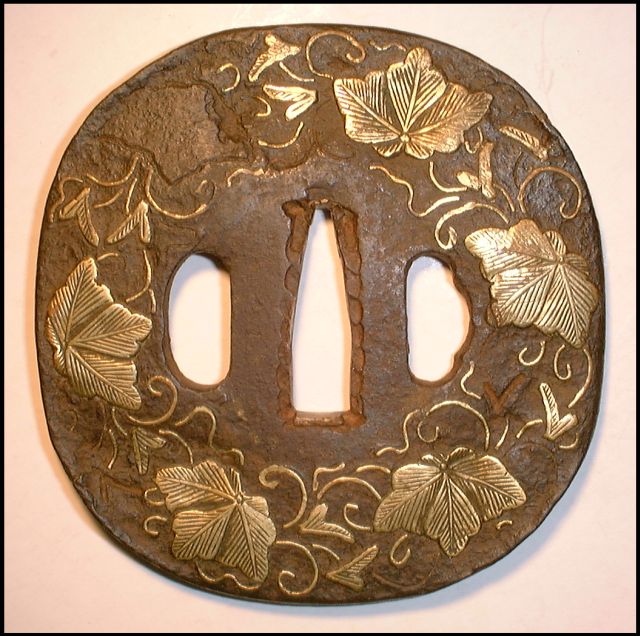

Here is example of an early tenpō tsuba, 7.8 cm – 7.6 cm, with the later addition of a gold, suemon-zōgan depiction of ivy (tsuta) leaves and tendrils. There is a raised, flattened, hammered mimi, a small kōgai-hitsu, and what appear to be brass sekigane in the well-used nakago-hitsu. The inlay covers much of the kokuin, but some of this has been lost, clearly revealing a ‘ten’ kanji at 2 o’clock on the ura surface. Search as I may, I can detect no indications of folding.
I am puzzled by the choice by tsubakō of tenpō plates for later decoration; surely such work would have been simpler on plain, undecorated plates?
John L.

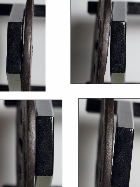

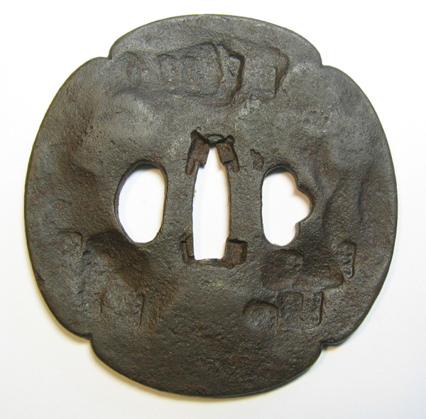

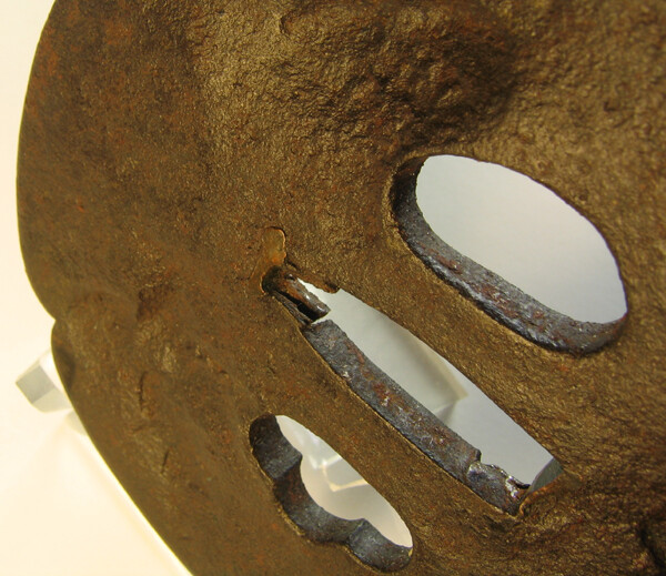

Here is the one Tempo tsuba I have. One can see in the cutouts for the sekigane that there is a step down from the surface to what appears to be another layer. Also in the closeup one can see where it appears as though a layer has been lifted a bit in the cut. There doesn't seem to be obvious indications of layers in the mimi, however, or in the two hitsu-ana. For what it's worth. It's good to see some Tempo here. Good subject and not much mentioned.
Colin
Hi,

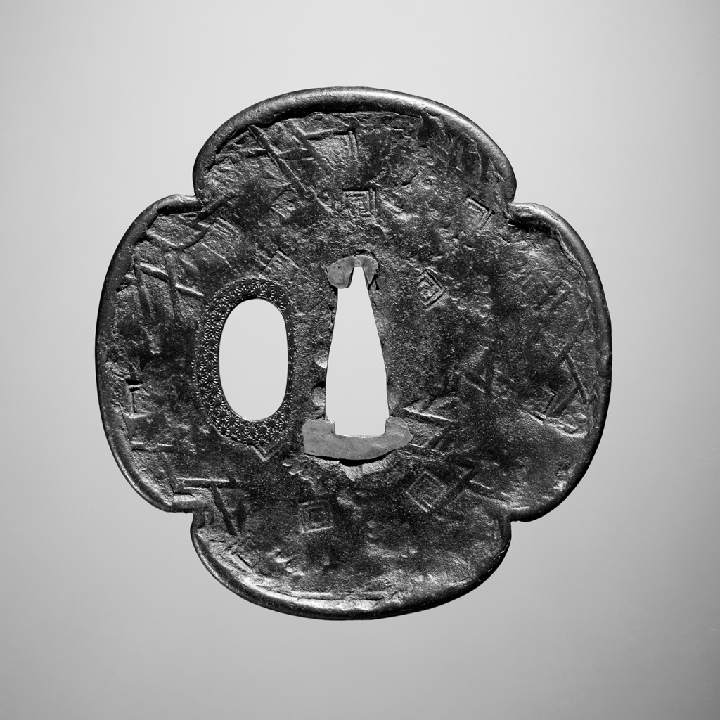

Interesting question. I just dug out my tembos and looked at them. I do see some evidence that the plates were folded over.
The early ones had excellent iron (still looked like saotome metal) and really great compositions - the later ones not-so-much.
I'm sure I've posted images of the little beasts before, but here's a couple of them I shot for a fine art series of tsuba
images I was putting together:
Best,
rkg
(Richard George)
