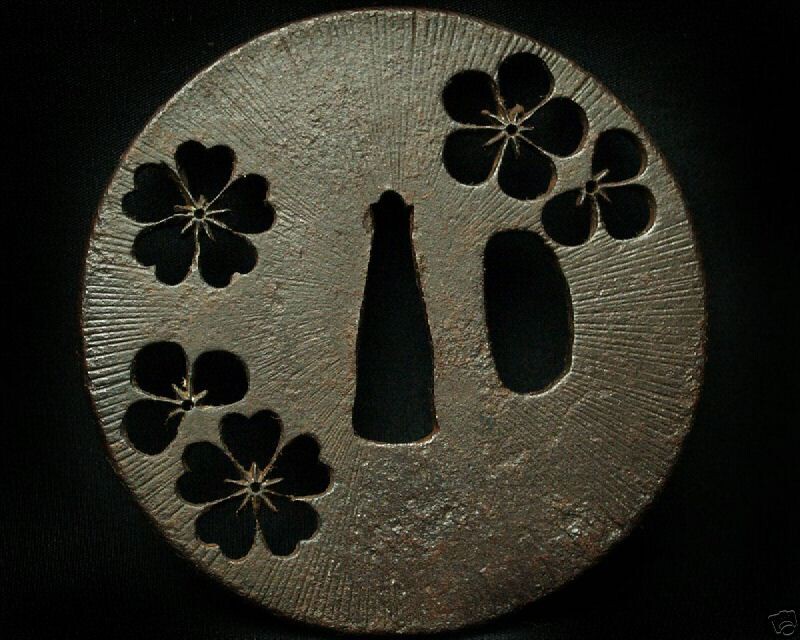

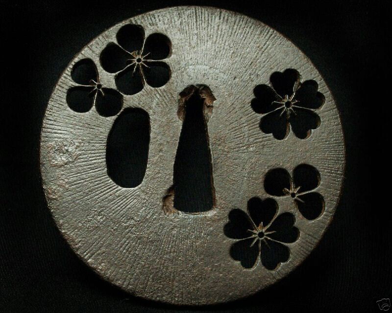

Ok here goes;
It looks like a Tosho tsuba with negative sukashi of sakura and ume flowers.
I'm wondering if you were disappointed by the quality of the plate which would make it a later piece, hence the breakage of the sukashi.
The design seems a bit crowded, the flowers close to the rim. Could the sukashi have been a later addition? Is this mutton dressed as lamb and rather than Tosho it is another homogenous iron plate?
Anyway these are my guesses for this tsuba.
Philip

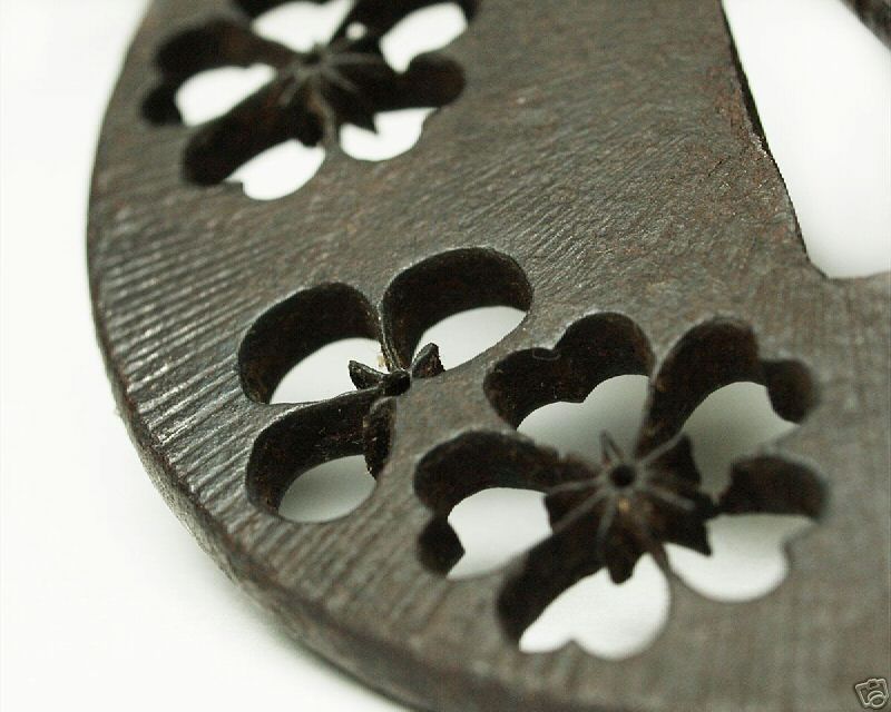

The first one, the only thing that jumps out is that some of the sukashi has rusted out in the flowers.

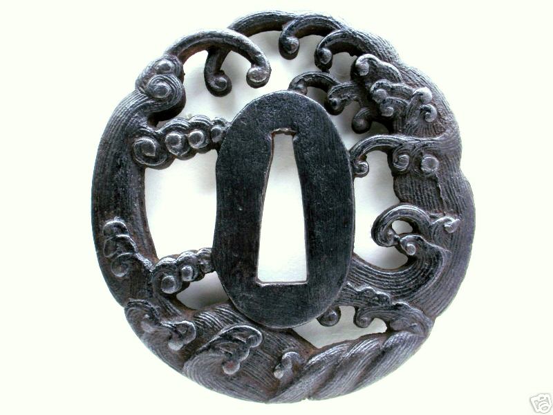

Another beginner here, and no points for going third, but I also think the second one is cast. From the picture it looks like the filework didn't clean up quite all the flashing from the mold (said one who bought a cast tsuba on his very first attempt). I'd love to hear a definitive explanation of what's wrong with the first one.
Thanks for the answers, you have hit the nail on the head with the second tsuba. It was indeed cast, and my purchase is insofar a cautionary tale for beginners, as I was sloppy when looking at the pictures. I have ignored the signs of casting and the lack of decent color. I was buying form a seller who was usually selling decent and genuine kodogu.
The first one is tricky, I agree, and perhaps it is not so easy (OK, it is almost impossible) to see the flaw in the pictures. The tsuba had firescale and the luster you can see in the pics resulted from this flaw rather than from a rich patina. You can see that this tsuba is shining, and that the shine is greyish? Well, that's it - that's the fire scale. It must have been in a fire for a short time, as the scale was thin and hard. This was definitely not yakite shitate (fire treatment at the end of the manufacturing process to give the tsuba a rich, molten look) as the color was really ugly - greyish, blueish, nothing like the deep, moist look of good patina.
I think it really wasn't fair of me to post it, but at least it shows us all the perils of buying tsuba on eBay, judging its quality by pictures only (even if the photographs are in high-res).
There are many honest sellers on eBay, and among them many people seling out of Japan. They have tonnes of low-grade or medium-quality items that find no buyers in the Japanese market. Some of this stuff has been in a fire like the first tsuba, some is rusted, pitted, stripped of patina, etc. It is almost a wholesale business and these sellers pay no attention to details. This was such a case.
Now you can draw your conclusions.
Philip, thanks again for your nice idea :-)
I'm a bit perturbed that the patina on the first tsuba is seen as fire scale. It looks perfectly fine to my eyes.
I agree it is not easy to recognise fire scale on that tsuba and as a matter of fact, I begin to doubt it was fire scale at all having read Ford's opinion.
Fire scale is usually brittle and little flakes are discernible - nothing of that sort was present in this tsuba. It was the strange color which made me think it had fire scale. Besides, the tsuba had parts (mostly left side of the omote) which were very very hard - I couldn't even clean off the rust with a piece of bone there...
Of course I may be wrong, maybe it was just heat-treated without the "molten surface" effect, hence the surface hardness... But it was so different form other late Edo Katchushi tsuba... the colour, the hardness...
But if Ford says it has no fire scale, then it surely doesn't.
Thank you Ford :bowdown:

Sorry chaps, I can't claim absolute authority in these matters but fire damage may range from hugely obvious flakes of scale peeling off, as Mariuszk described, to a situation that would possibly overlap with some of the processes that were actually used to create the original patinae.
Hi Ford
Is there any chance that you could post pics of 4 different tsuba- one with firescale and let us try to determine which one has this problem?
Philip
Hi Phillip,
sorry again, no chance. I'd never buy a tsuba that was fire damaged :shock: ...he he, and if I did make that mistake I wouldn't tell anyone :glee:
A further complication is the recent proliferation of fakes on the market, all with very confusing finishes to confuse the inexperienced.
I suppose a blue/grey cast to the patina, very red, almost purplish rust in the sukashi and a certain dryness would be the first things to hint at possible fire damage. But these aspects can also be obscured by oil or wax.

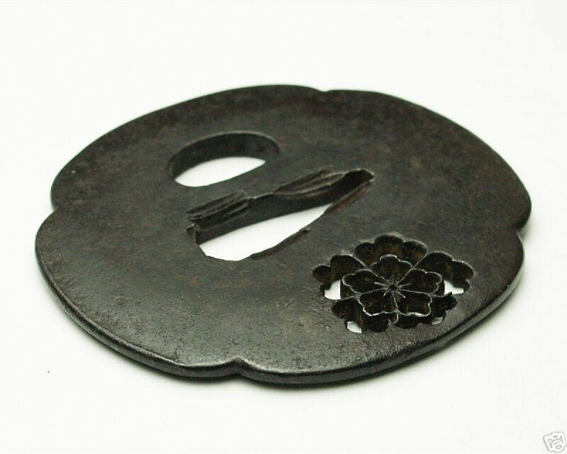

OK, here is the solution to tsuba 3.
Yes, it has been cut down to its current size - you can see that parts of the mimi have been removed and the tsuba has been reshaped into mokko-gata (it used to be maru-gata).
Then, look at the ko-sukashi - it is damaged on one side. It used to have the form of a pentagonal cherry blossom (a ka-mon), which is still visible in its middle section. My guess is that this tsuba has received a strong blow which has caused a contraction of the sukashi - you can see that some of the outlines are bent. Subsequently, a part of the damaged tsuba has been filed down, but the damaged ko-sukashi has remained unrepaired.
Yes, the damaged sukashi is something one should see immediately. Well, I have not :-)
