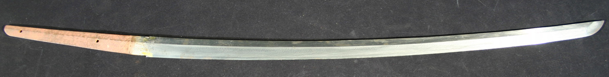

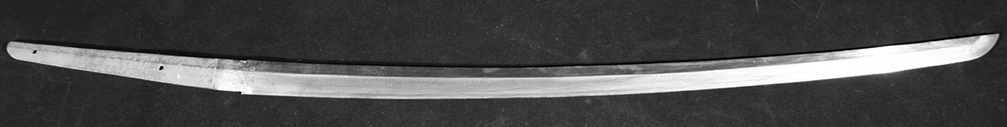

steeve Posted February 24, 2010 Report Posted February 24, 2010 Hi,I just bought this katana blade on ebay from "World Armor Antique DAIMYOU" Please could you tell me what do you think about it. It's bad polish but the nagako looks to have a good work and the main shape of the blade look not so bad... Thanks for your knowledge and I hope that it's not too bad but please be honest. Tell me if you need some picture. steeve Whole Length about 35.4"(90cm) : The blade Length about 26.3"(67cm) , Carve about 0.7"(1.9cm) : Width (motohaba) about 1.3"(3.5cm) : Weight about 920g Quote
pcfarrar Posted February 24, 2010 Report Posted February 24, 2010 It appears to be a WW2 period blade. Judging from the nakago it may have originally been in 44 mounts. Quote
steeve Posted February 24, 2010 Author Report Posted February 24, 2010 Hi, I thinks too ,but do you thinks that it's a machine made? thanks Quote
pcfarrar Posted February 24, 2010 Report Posted February 24, 2010 At first glance it reminded me of a Koa Isshin Mantetsu. 1 Quote
Bruno Posted February 24, 2010 Report Posted February 24, 2010 A Mantetsuto without any inscription on nakago, and in 44 mount? I agree that it looks like a WW2 blade, yes maybe a Mantetsuto. Quote

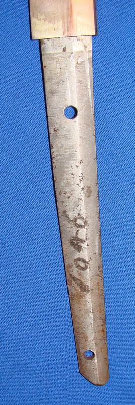

Stephen Posted February 24, 2010 Report Posted February 24, 2010 any more kanji in the nakago mune besides the one shown in third or forth pix? Quote
george trotter Posted February 24, 2010 Report Posted February 24, 2010 It does look like a WWII blade...I would agree that it looks like Mantetsuto except fot the following points... The nakago is ha-agari kurijiri, which is different from Mantetsuto (kurijiri). The yasurimei seems the same but seems coarser. The Mantetsutos I have seen all had one mekugi-ana and were in Type 98 koshirae. I have not seen one in Type 3 mounts, but if so, maybe the nakago would have to be lengthened to accomodate the extra hole? and "thinned" towards the jiri to allow enough wood in the tsuka? Just a thought. There may be a clue to the blade in the small stamp? on the mune which I cannot see properly? Regards, George. Quote
Grey Doffin Posted February 24, 2010 Report Posted February 24, 2010 It doesn't seem likely that a Mantetsu-to wouldn't be signed as such, and I doubt anyone would be able to state with certainty that it is Mantetsu (Manchurian steel) without the signature. It does look like WWII vintage, and the kesho yasuri (style of file work on the nakago) suggests more of a hand made blade than machine made. Probably not true Nihonto (made of tamahagane) but probably water quenched. The blade needs a proper polish, which will cost more than it is worth, probably. Now that you've satisfied the itch to buy a sword, spend serious time in study. Read and reread books and get to see in hand every sword you can. Knowledge will lead to smart buys. Grey Quote
Bruno Posted February 24, 2010 Report Posted February 24, 2010 Is there any tiny tiny stamp on the nakago that you have maybe missed? There is a little mark on the nakago mune, may we see a big close up of it? Quote

steeve Posted March 2, 2010 Author Report Posted March 2, 2010 HI,I just get my sword this morning.The sword look more polish than on the picture. I have watch the nakago and I saw no stamp or sign. I can only see these kanji on the mune of the nakago . is it numbers? do you really think it's a mantetsu? It 's similar but I have search on the web and I only find sword with sign. thanks for your help. steeve Quote
pcfarrar Posted March 2, 2010 Report Posted March 2, 2010 Is the sword just a bare blade or do you have any koshirae with it? It's probably not a mantetsu but I suspect its factory made in a similar way. Quote

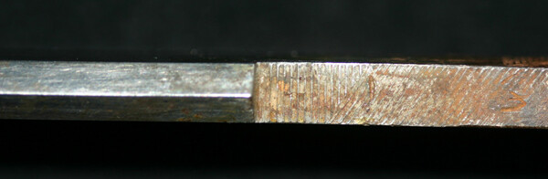

Bruce Pennington Posted October 8, 2021 Report Posted October 8, 2021 @steeve - if you are still receiving NMB emails, we have recently discovered that these blades were made in 1945 by Mantetsu. The serial number "い 28" is the 1945 series. We have 8 of these on record and yours makes 9, and the earliest number in the series. 6 of them have the "Konan Essei" slogan, but 2 are mumei like yours. い 28 mumei (Steeve) い 67 Konan Essei (from a book with a Diary citation) い 90 Konan Essei (from a book with a Diary citation) い 213 Konan Essei (from a book with a Diary citation) い 289 Konan Essei (from a book with a Diary citation) い 449 Konan Essei (from a book with a Diary citation) い 622 Konan Essei (Beng Shua Collection) い 1170 mumei (NGF Collection) 3 Quote

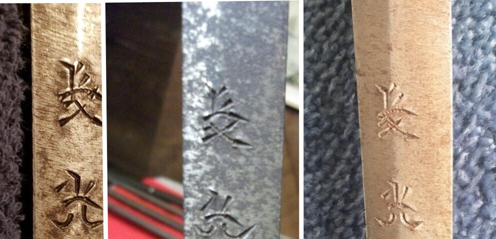

vajo Posted October 8, 2021 Report Posted October 8, 2021 For me it is a Nagamitsu. Nakago, Yasurime and Nakago-jiri looks like nagamitsu. oh i see its an old thread - sorry. Quote
Bruce Pennington Posted October 9, 2021 Report Posted October 9, 2021 On 10/8/2021 at 1:55 PM, vajo said: nagamitsu. Expand Chris, It is certainly possible. I have a variety of Nagamitsu mune with numbers and kana (1), so it's possible this is just another one. But after zooming in on Steeve's, it's clear the yasurime is the same as Mantetsu 1945 Yasurime (Steeve's in the middle) Nagamitsu 3 Quote
