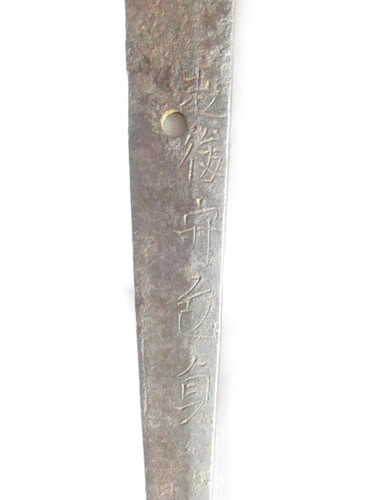

Before I blindly ask for assistance on the name, I came up with Echigo (no) Kami Kanesada. Am I right?
I do need help with the date. The second character is difficult to decipher. Can you please help?
Here is the full inscription:
And a close up:
Thank you so very much in advance...

So the date is August 1666? I read Manji (Thank you) ku nen hachi gatsu hi. Close? Also, can you help point me in the right direction on which Kanesada this is? The date looks to be (to your point) an early second generation Kanesada (KAN 281), but could it be a late 1st generation (KAN 280)? Thank you so much for the help.
I took a few pictures of the blade and had a VERY difficult time capturing the hamon and hada - below are the pictures and here are the sword particulars:

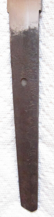

Can we have a picture of the whole nakago?

I have only been collecting for about 3 years, so I still have a LOT to learn - and I am not presuming shoshin or gimei on this blade - but with differences this radical, how do you ever know whether the signature is genuine without sending to shinsa? And even then, I am sure they get them wrong at times too.
