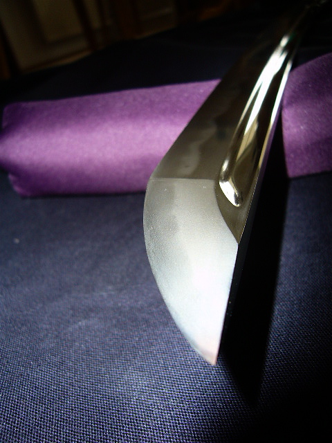

Hello Richard, the Kimuras do make good swords. I have one by Kimura Kanehiro "Kaneteru" for sale on my website. Here is the link for your interest: http://www.katsujinken-ya.com/2.html . However, do not feel obliged to buy it.
