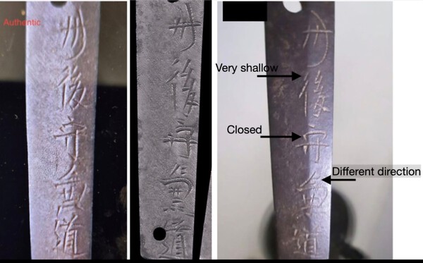

Lilleskit Posted Thursday at 11:37 PM Report Posted Thursday at 11:37 PM Hello all, I have a blade signed Tango no Kami Kanemichi. Opinions so far have been mixed and I personally am leaning on the gimei side. It would be nice for it to be real but I'm skeptical. My blade is far right next to a couple of the many confirmed mei. I added notes with a few of what I think are problems. Regards, Ken Quote
Mikaveli Posted Thursday at 11:40 PM Report Posted Thursday at 11:40 PM Looks very suspect to me... Assuming it's unpapered? Quote

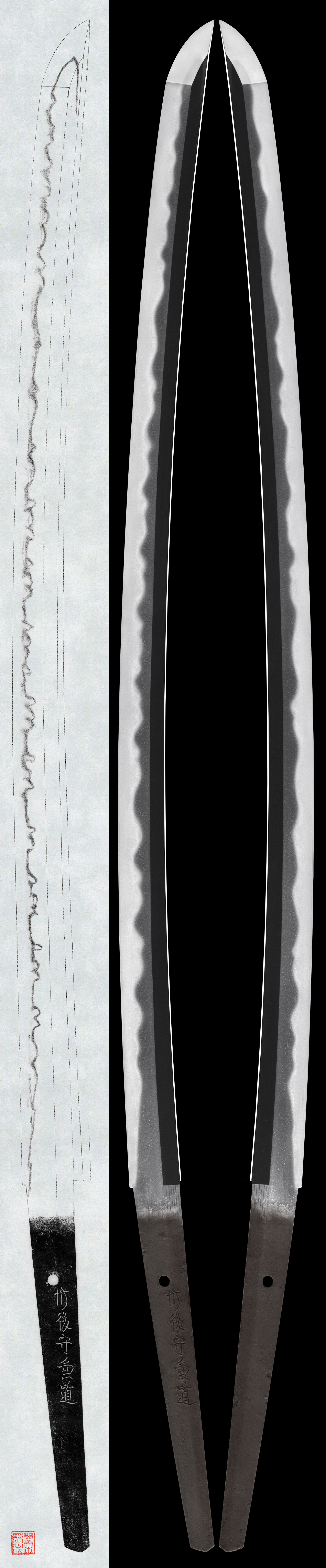

Jacques Posted Friday at 09:02 AM Report Posted Friday at 09:02 AM Detecting a gimei is much harder than you think. You need to start by taking into account the smith's entire career This one is tokubetsu hozon (dots on Kane are in the same way than on yours) 1 Quote
Mikaveli Posted Friday at 09:21 AM Report Posted Friday at 09:21 AM 10 minutes ago, Jacques said: Detecting a gimei is much harder than you think. You need to start by taking into account the smith's entire career . Yes, and no! 🙂 You're right that just because there are differences, it doesn't necessarily mean gimei - many smiths changed their mei over time (along with titles, yasurime etc.), and I've seen documented examples where with age, their mei becomes noticeably more lightly struck. But by the same token, some gimei is very, very obvious. My favourite is western copies of kanji, shape based without understanding of stroke order, stops or direction etc. Quote

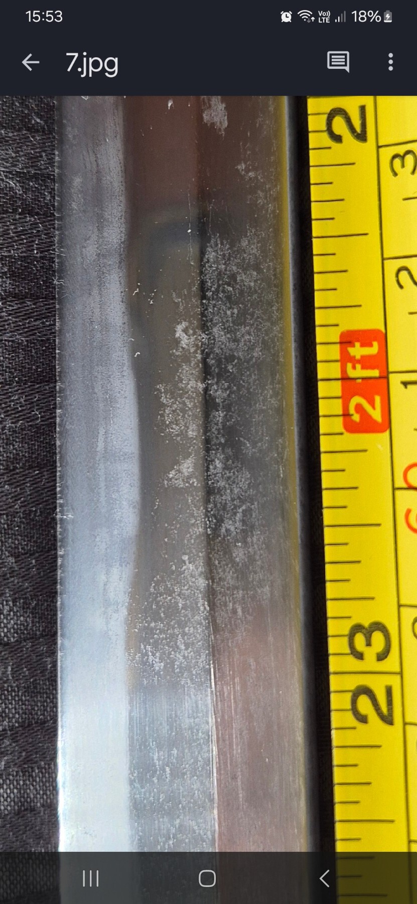

Rawa Posted Friday at 12:18 PM Report Posted Friday at 12:18 PM Are those stains running on shinogi-ji and hira innactive rust? How this is called? Quote
Lilleskit Posted Friday at 01:17 PM Author Report Posted Friday at 01:17 PM (edited) 4 hours ago, Jacques said: Detecting a gimei is much harder than you think. You need to start by taking into account the smith's entire career This one is tokubetsu hozon (dots on Kane are in the same way than on yours) Yes, it recognize this blade and the mei. I found many examples signed this way. The reason I wavered from thinking it was a close enough match were the "dots". They are lined up, one behind the other, chasing each other down and to the left on some of the examples I've found. I truly want to be incorrect and find it to be authentic. Seems that the devils in the details. Some might remember gimei signed Kozuke Daijo Fujiwara Sukesada that looked pretty good exect for the final stroke not starting a little early and crossing over the previous one. Edited Friday at 01:19 PM by Lilleskit Incorrect information given Quote

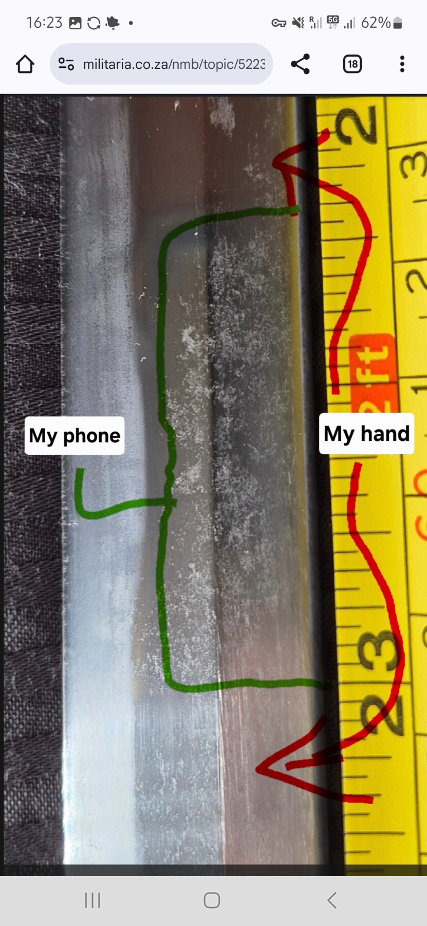

Lilleskit Posted Friday at 01:30 PM Author Report Posted Friday at 01:30 PM 1 hour ago, Rawa said: Are those stains running on shinogi-ji and hira innactive rust? How this is called? Hi, No, it is in poor shape but there's no active rust on the blade. Maybe you're seeing reflections of the surroundings. Quote
Lilleskit Posted Friday at 02:17 PM Author Report Posted Friday at 02:17 PM 18 minutes ago, Rawa said: Im mentioning those I think you're referring to the micro pitting/oxidation scaring on the shinogi-ji, ji, and mune. The redish color on the bottom right portion is me, my reflection. I'm a horrible photographer. 😅 Quote
Lilleskit Posted Friday at 02:39 PM Author Report Posted Friday at 02:39 PM 52 minutes ago, Rawa said: Im mentioning those Not active rust. Along with the micro pitting you can see my reflection that appears somewhat redish at the top and bottom of the picture. Quote
