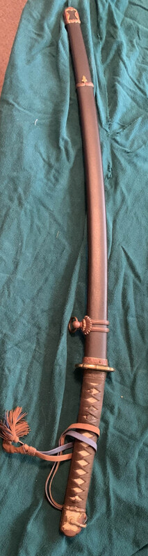

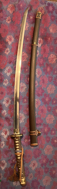

Listed as ARMY MOUNT 27 1/4" KANEYOSHI ?

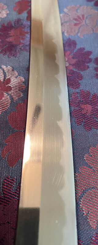

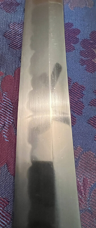

 Nice Flowing Hamon -How do you tell if oil or water quenched ?

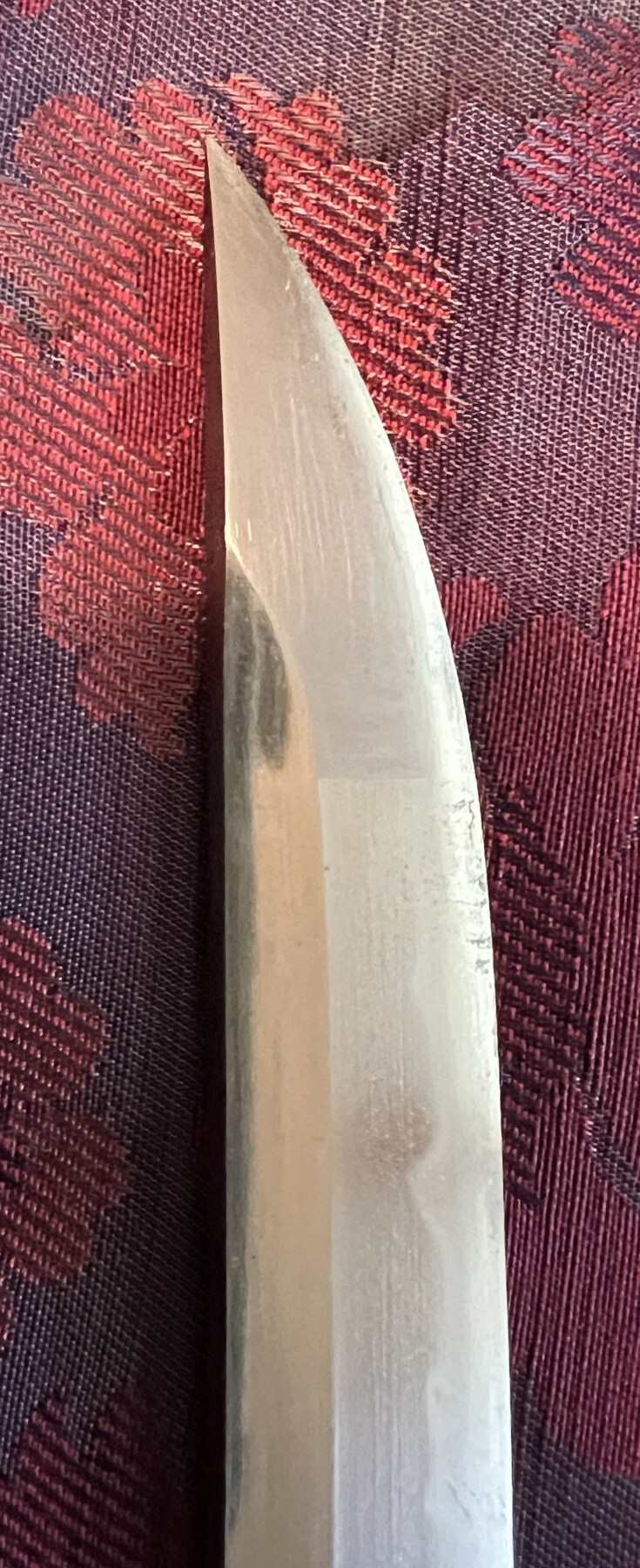

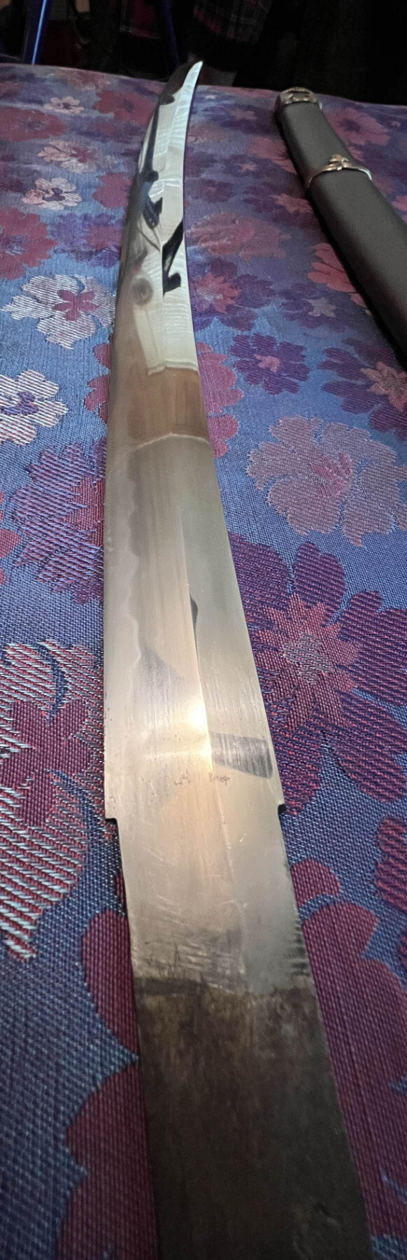

 Kissaki appears long or stretched out in my eyes
 Clasped Hands Sarute

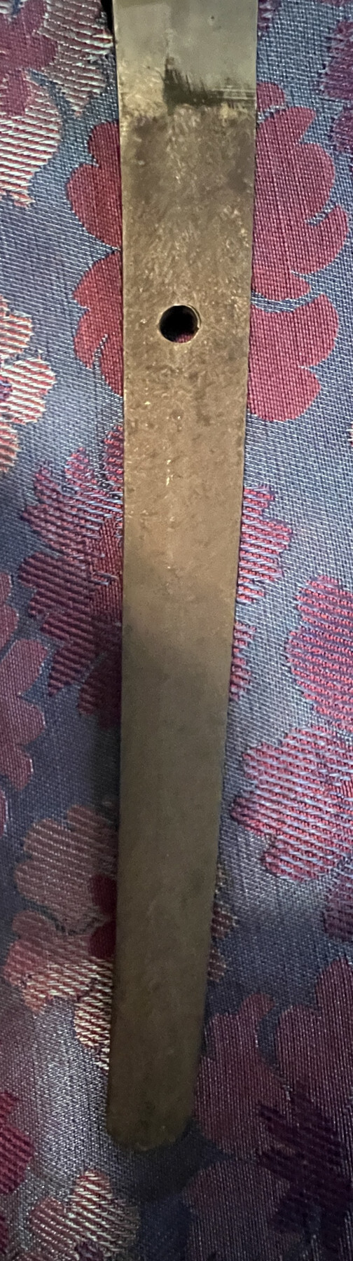

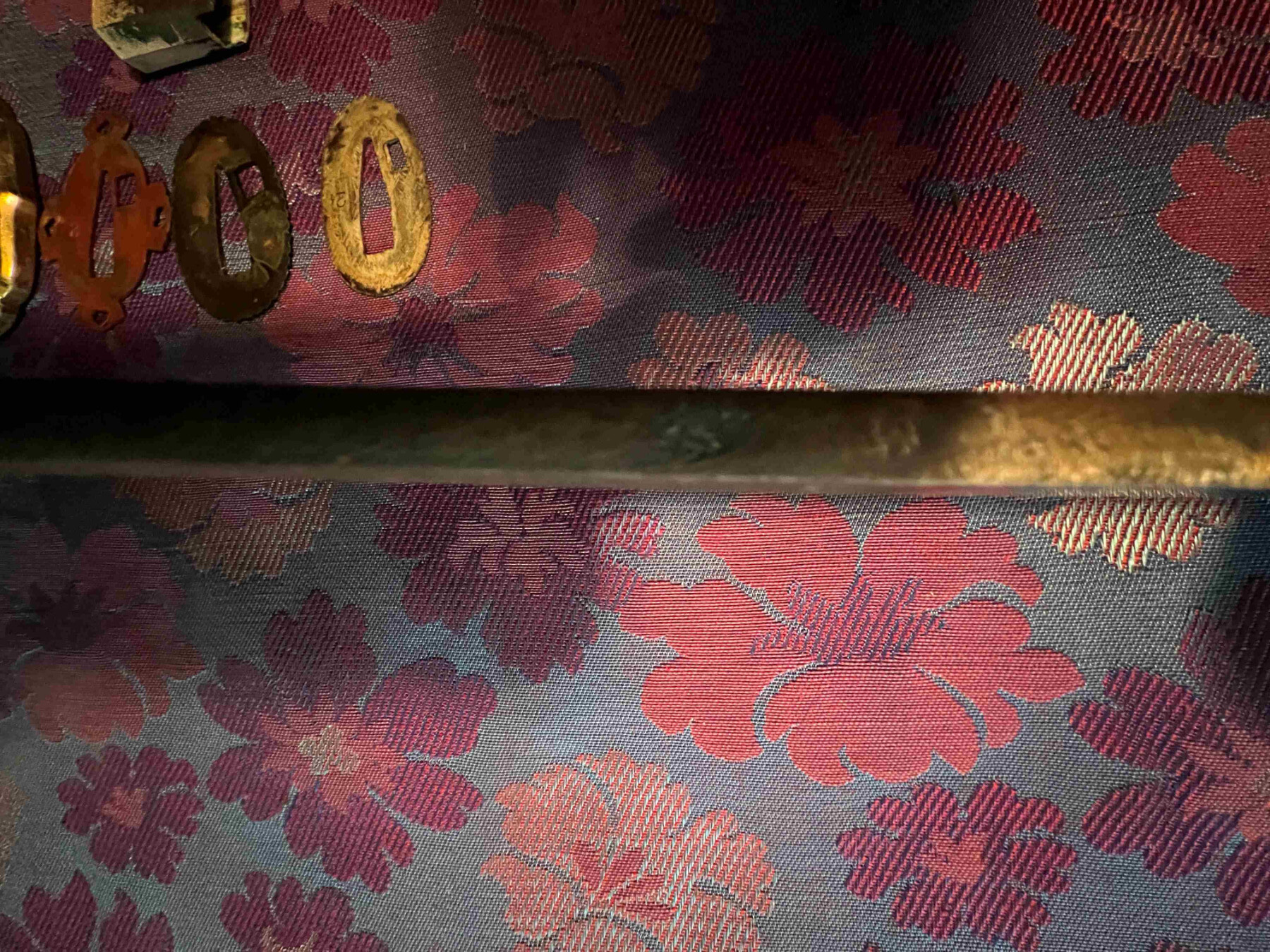

 Spine on the Nakago is stamped but hard to see
  Showa' stamped
 As always any information is appreciated
                          Enjoy-Thanks Steve

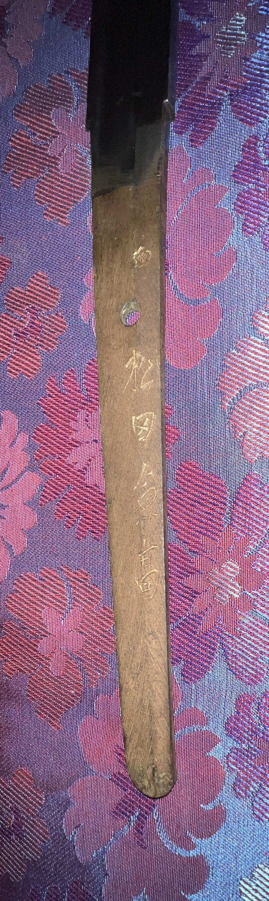

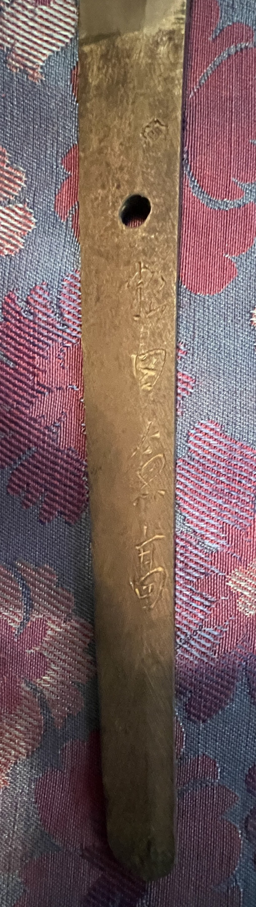

Steve, looks to be 兼高 Kanetaka (松田 高市 Matsuda Takaichi)
Born: Meiji 44 (1911) Sept 16; Reg: Showa 14 (1939) Oct 26.
1937: Bugi-gun, Seki-machi, Aza naka-machi. 1939: Seki-machi, Naka-machi. Deshi in 1937: 1. History: trained from Taisho 13 (1924) under Kojima Kanetoki (Kanemichi). Independent Showa 5 (1930) May.
Example mei: Kanetaka 兼高
Noshu Seki ju Matsuda Kanetaka saku 濃州関住松田兼高作
maybe with type 94 shinto gunto mounts, yes very long kissaki and strong sori.  I think these mounts finished in 1938, so may be just pre-war.
G'day Steve,
It is a showato, so probably oil quenched, but the photos aren't good enough to tell for certain. I disagree with Mal about the mounts, they are type 98, nothing suggests type 94 to me.
Cheers,
Bryce
A very nice Type 98 showato nonetheless. A complete package with tassel, extended kissaki, and in good condition.
