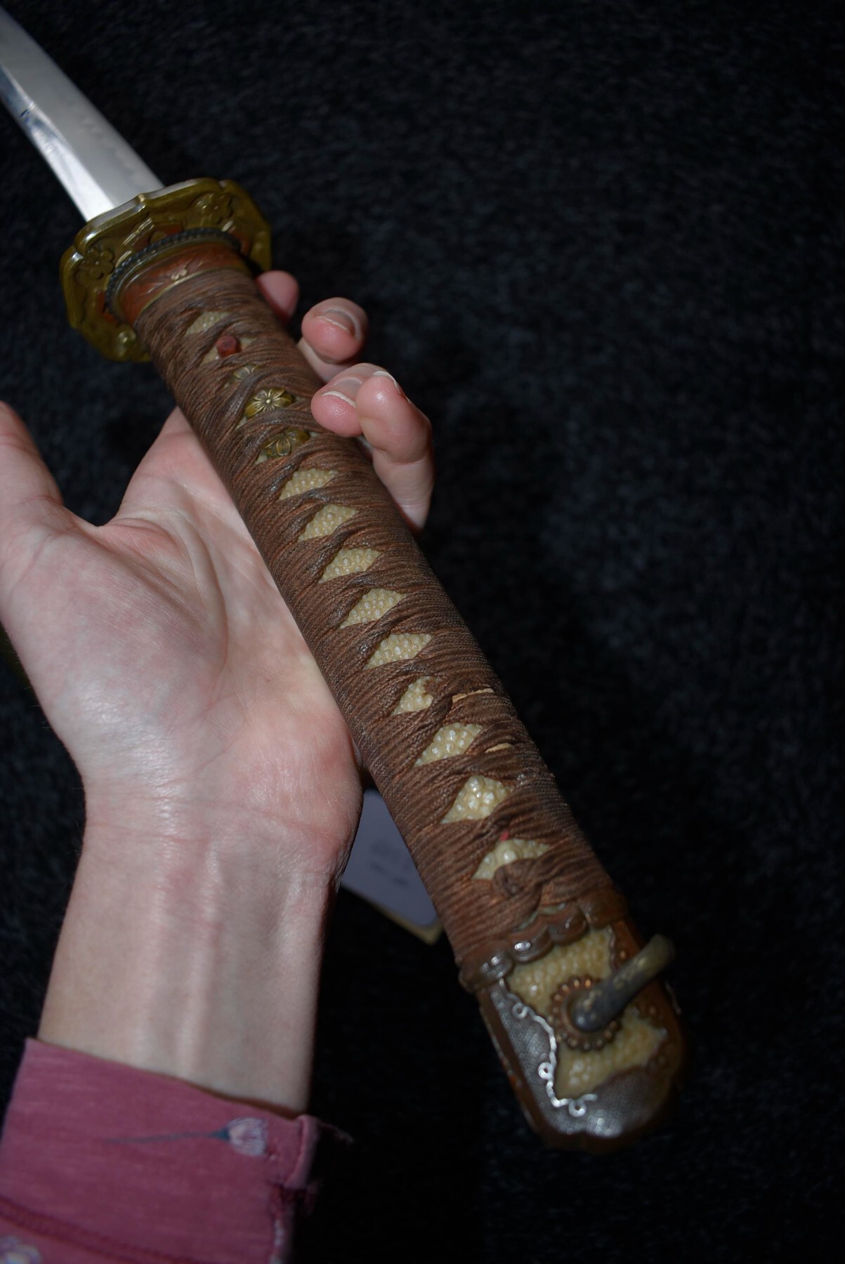

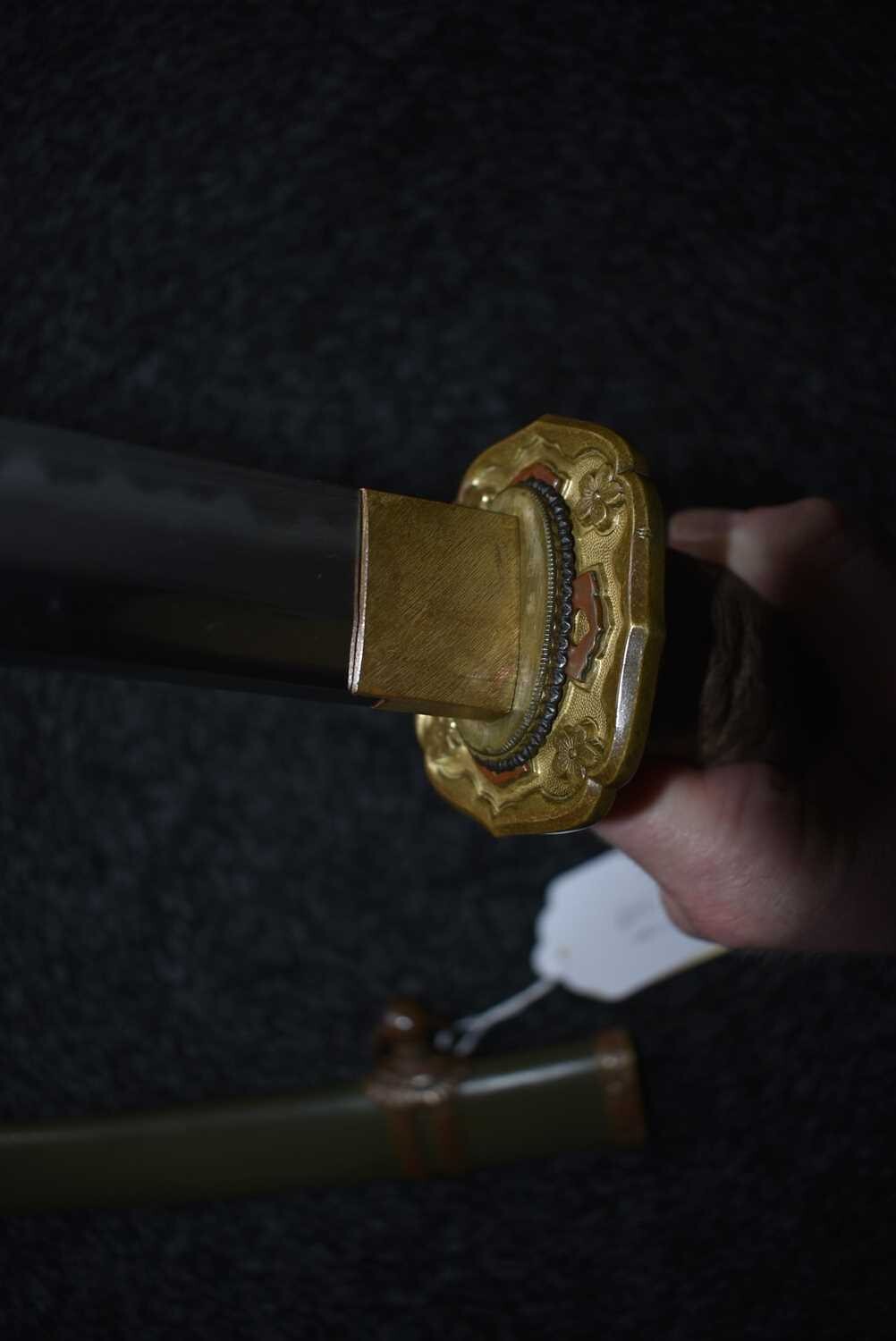

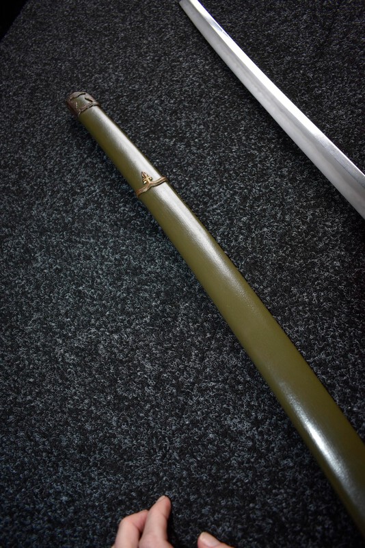

Jan Pirecki Posted April 19 Report Posted April 19 Gentleman, I wished to ask for your expert opinion while paying you back with some eye candy, I Have found this Noshu Seki ju Kenemichi Sword for sale, unfortunately there are no tang photos to examine, the photos could be better and the blade itself seems to be obstructed by preserving oil, however it still looks impressive, I thought that many of you would enjoy taking a peek. The blade itself looks gendaito, but without taking a better look at the grain one can't evaluate it to its fullest. The saya seems to have possibly been repainted, the blade looks genuine, with the trademark sanbonsugi -esc hamon of the smith being clearly visible. I have found him in Sloughs book, he was rated at 2 million yen, he worked in the Mino tradition, was a teacher to his younger brother Kanenori and son Kanetoki. I would love to hear your opinions :D Quote

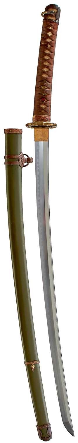

lonely panet Posted April 20 Report Posted April 20 the hamon isnt your typical style for kojima kanemich, thats raising my eyebrow, also the saya paint warrents a closer look at, i would be concerned about THE FRESHNESS compared to the frail ito. heres what kojima kanemichi should look like, sorry for the poor pics, they had to be dragged out of a oooooold usb 1 Quote
PNSSHOGUN Posted April 20 Report Posted April 20 It may be the photos but the polish appears to be a recent non-traditional type. Not the end of the world, generally you wouldn't receive a proper polish on a Showato anyway, but if you're after an original war time sword then hold off. 1 Quote

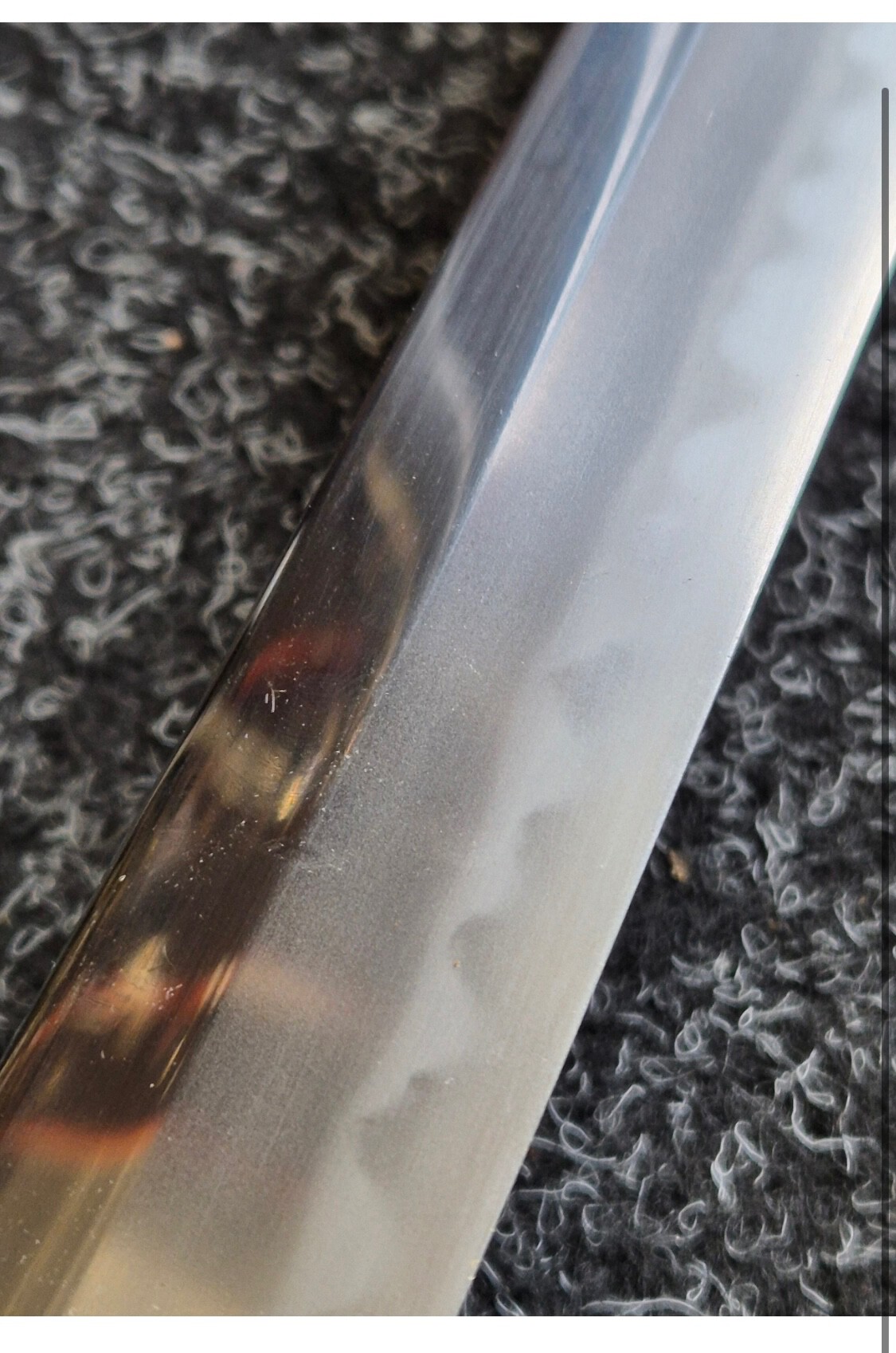

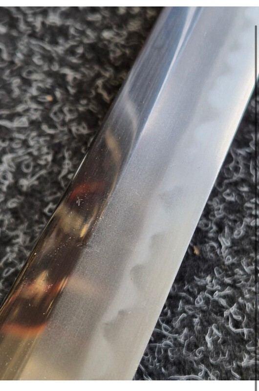

Jan Pirecki Posted April 21 Author Report Posted April 21 I have received the additional photos, unfortunately it looks like a showato to me 😕 could be wrong, maybe just a poor polish. Quote
Jan Pirecki Posted April 21 Author Report Posted April 21 You guys really saved me from splashing money wastefully, thank you all. Quote
