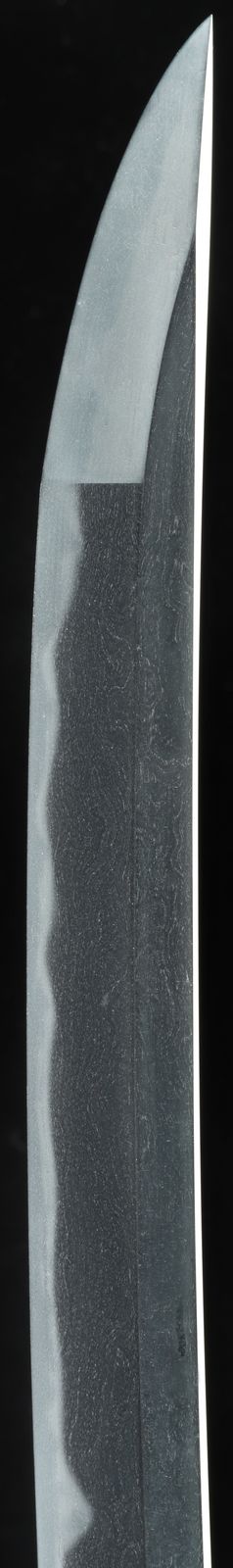

Lewis B Posted April 16 Report Posted April 16 And another. A Juyo naginata naoshi attributed to Kashu Sanekage from the Nanbokucho era. The kaeri is absent on the ura side. 2 Quote

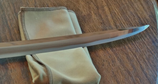

Mushin Posted April 16 Report Posted April 16 Here's a naoshi with a gakumei (framed signature) of Chikushu Yukiyoshi, the grandson of Sa Yukihiro 2 Quote

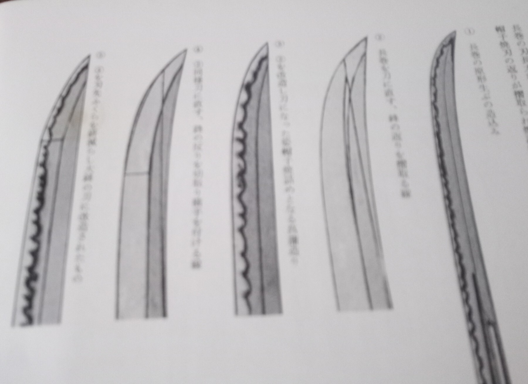

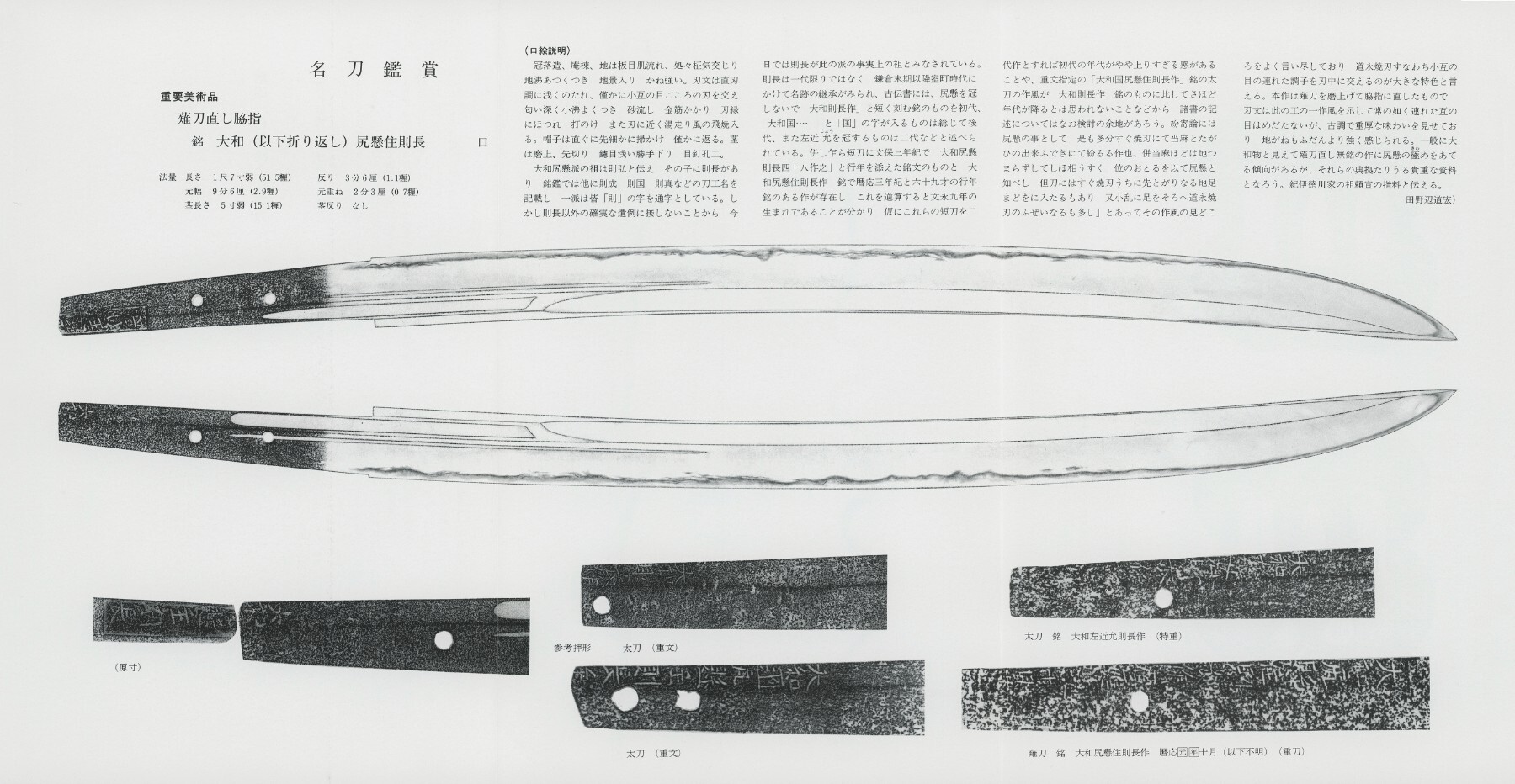

Rayhan Posted April 16 Report Posted April 16 @Jacques is correct here, but since the Naginata Naoshi is a modified version of a previous Naginata there are exceptions. I am attaching a Juyo Bungo Tomoyuki and one side the boshi is yakitsume and on the other slightly turned back as per the setsumei and oshigata. 3 Quote
Franco Posted April 16 Report Posted April 16 On 4/16/2025 at 5:39 PM, Rayhan said: @Jacques is correct here, but since the Naginata Naoshi is a modified version of a previous Naginata there are exceptions. Expand Nope. Naginata can be modified at one end or both ends. Each piece must be evaluated independently. A yakitsume boshi can and will be evidence that the sword was modified at both ends. There will be examples where the turn back is fully retained. You can call it an exception if it makes you feel better. 4 Quote

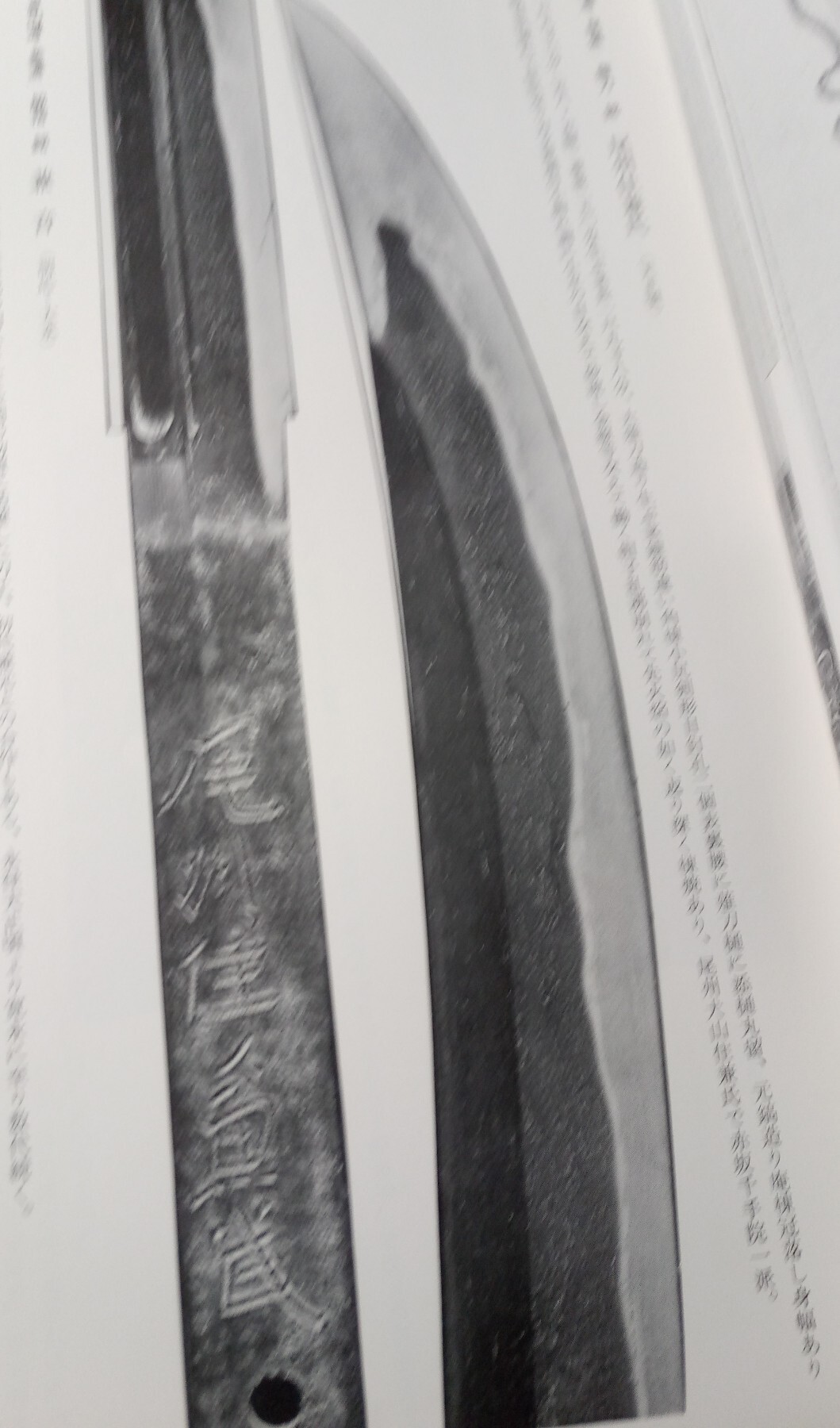

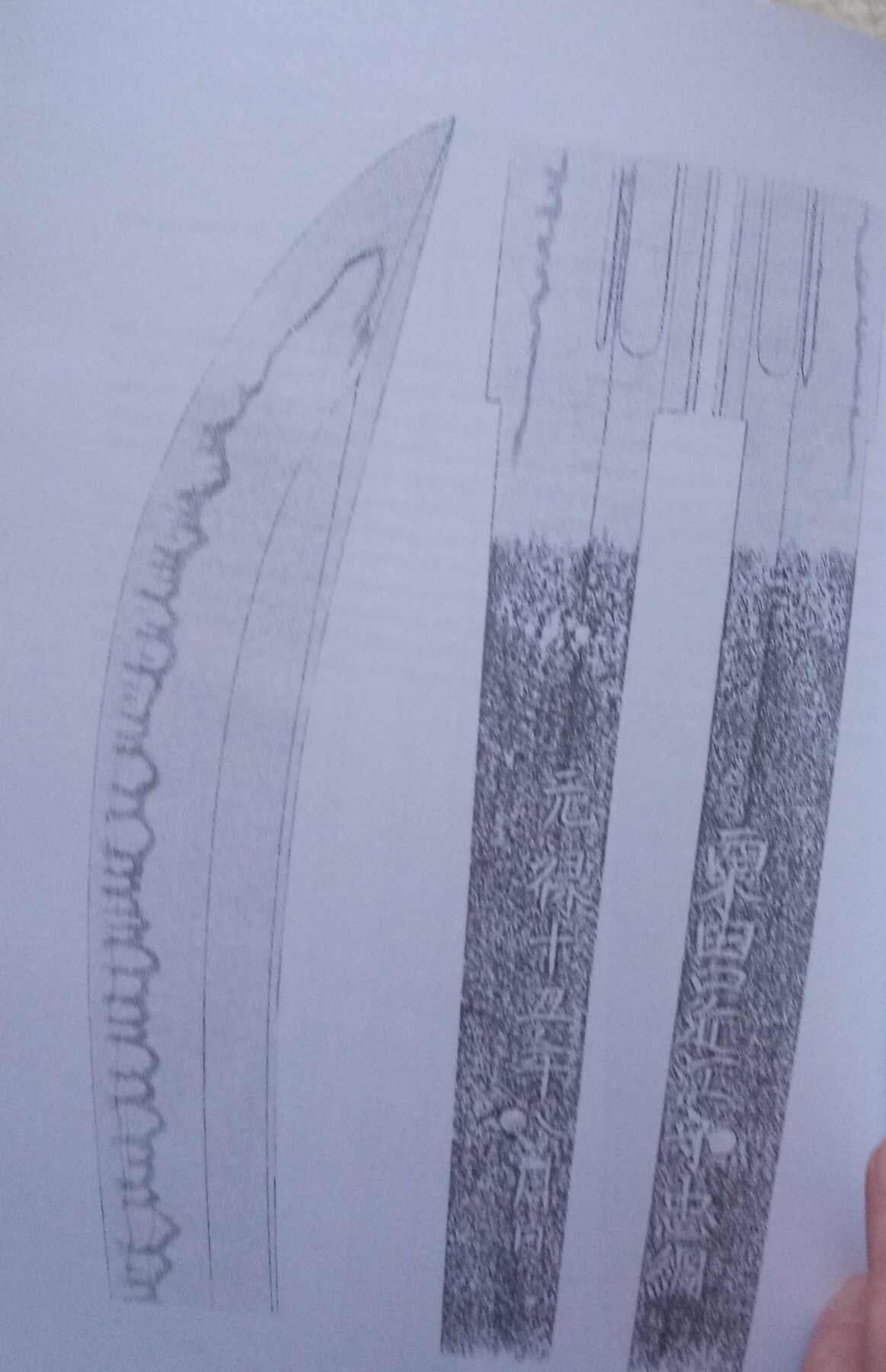

Mushin Posted April 16 Report Posted April 16 Here's a Juyo Token naginata naoshi with orikaeshi-mei of Osafune Masamitsu of the Kanemitsu school that has retained its kaeri on both sides. It has been shaped by shaving away metal along the mune from mid-blade upward. Despite the alteration, you can see its original profile remains visible, particularly around the monouchi, where a slight flare shows its naginata origins. The bōshi is hakikake with a turn-back that flares out Sōshū style. The blade is also notably thick at the base but the nakago has been shortened greatly and the signature has been retained. 1 Quote
Rayhan Posted April 16 Report Posted April 16 On 4/16/2025 at 6:25 PM, Franco said: Nope. Naginata can be modified at one end or both ends. Each piece must be evaluated independently. A yakitsume boshi can and will be evidence that the sword was modified at both ends. There will be examples where the turn back is fully retained. You can call it an exception if it makes you feel better. Expand Yes, I think everyone is in agreement and put forth examples in a diplomatic way. But you are right, I want to call it an exception 😉 1 Quote
