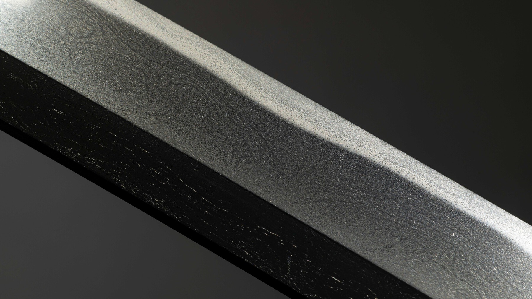

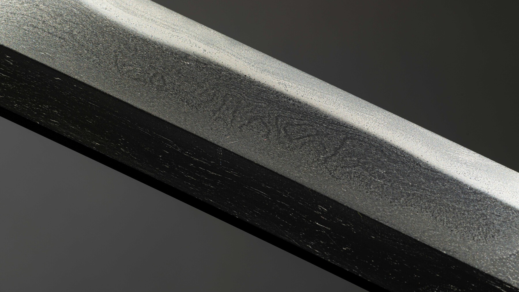

Chikei doesn't always follow hada
In places where chikei are not formed you can see the structure of the jigane, which has a much finer texture than it might seem when looking at the chikei

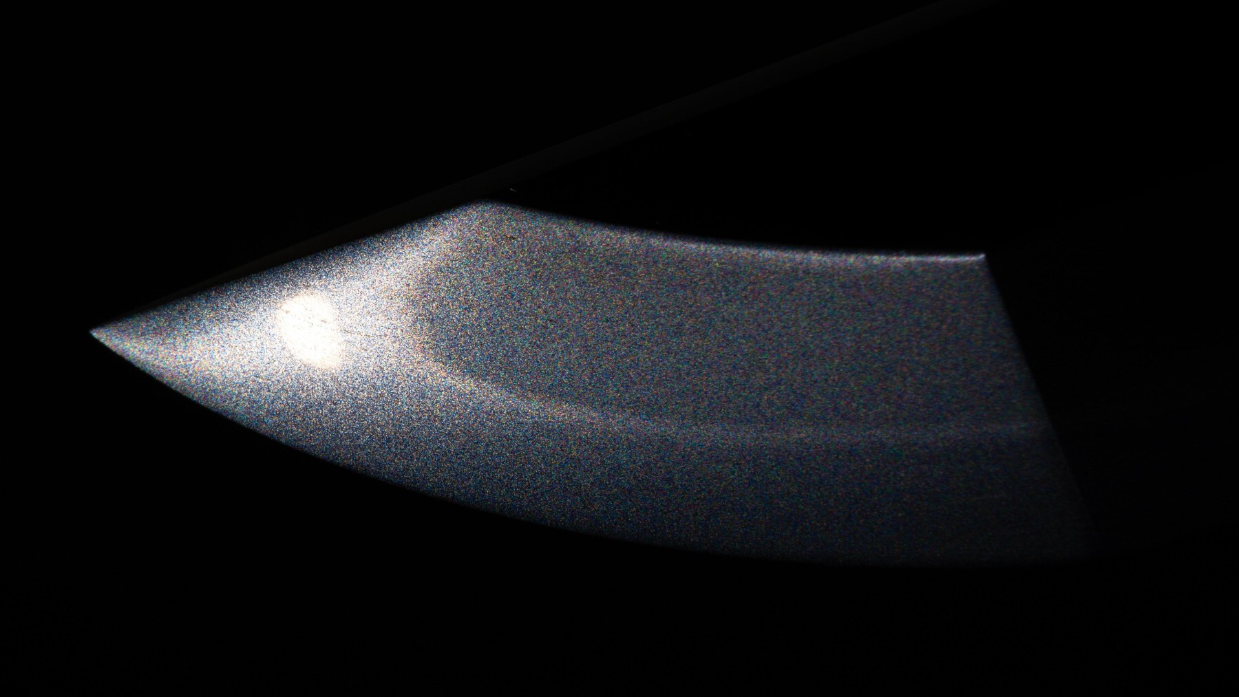

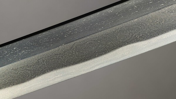

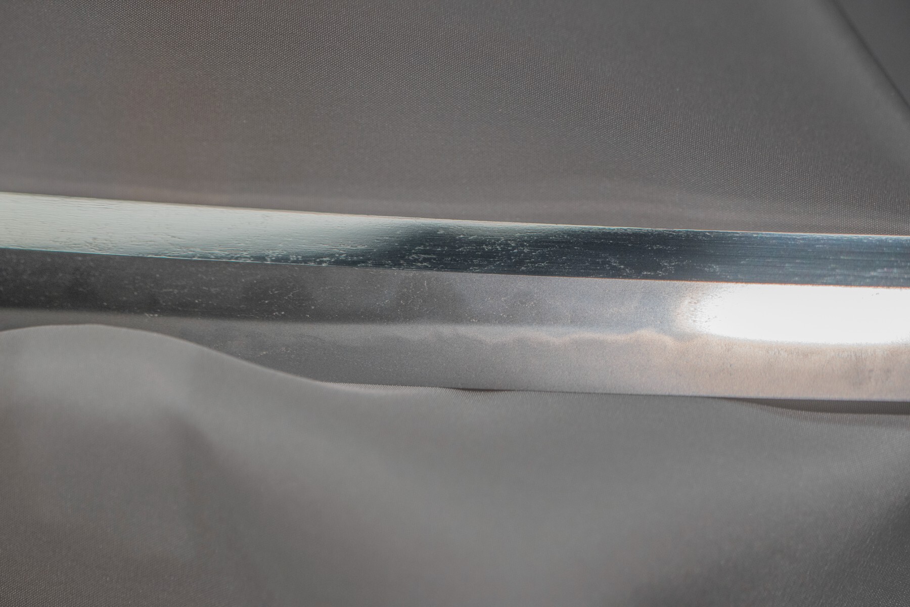

The first case you describe is actually the jigane itself (chikei is not made of a cluster of ji-nie)
The published photos are of a blade from a first-class Soshu swordsmith, however the chikei are made of martensite crystals that are woven through the layers of jigane
Chikei can take many forms and many times may not be visible at first glance
Here is an example of a Bitchu blade from the end of Kamakura, where the chikei are about the thickness of a human hair (for a better idea - the sakihaba is 16mm and the kissaki is 25mm)
Another example of an early Yamashiro blade with very fine ko-nie jigane and chikei, which are also very fine (you can see them better in places where the photo is a bit out of focus)
@Brano excellent examples of why taking carefully executed photos, under sympathetic lighting is so important. The finer details come alive and can be appreciated when in hand examination is not possible.
