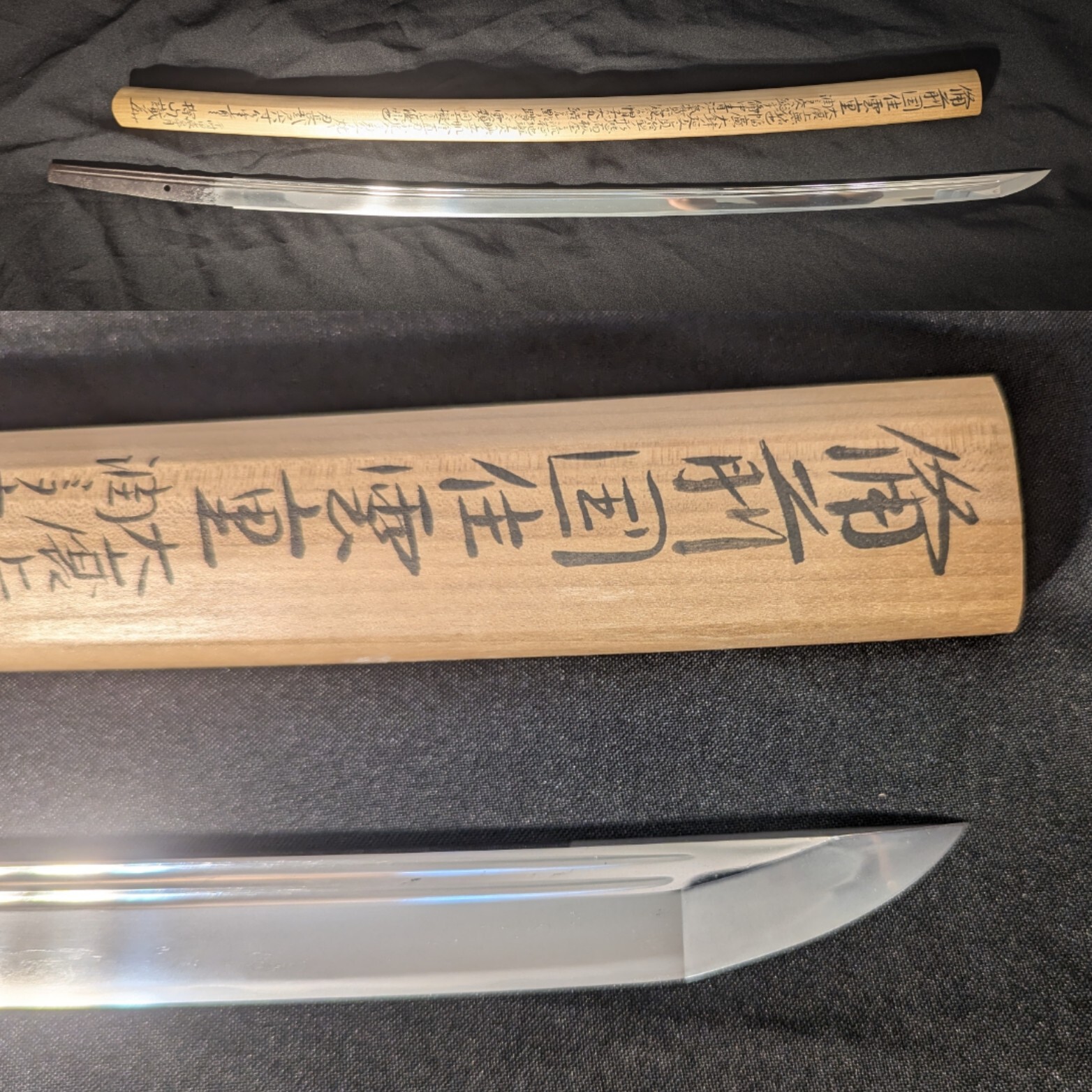

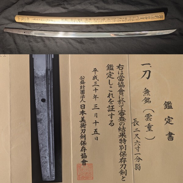

Hi Bosco, most of the pieces I focus on tend to be in that time range and I sometimes have larger examples like the 79cm ( 2 shaku 6 sun 1 bun ) Unju below. Please message me to discuss what might be available.
Best regards,
Ray
  • Love 5

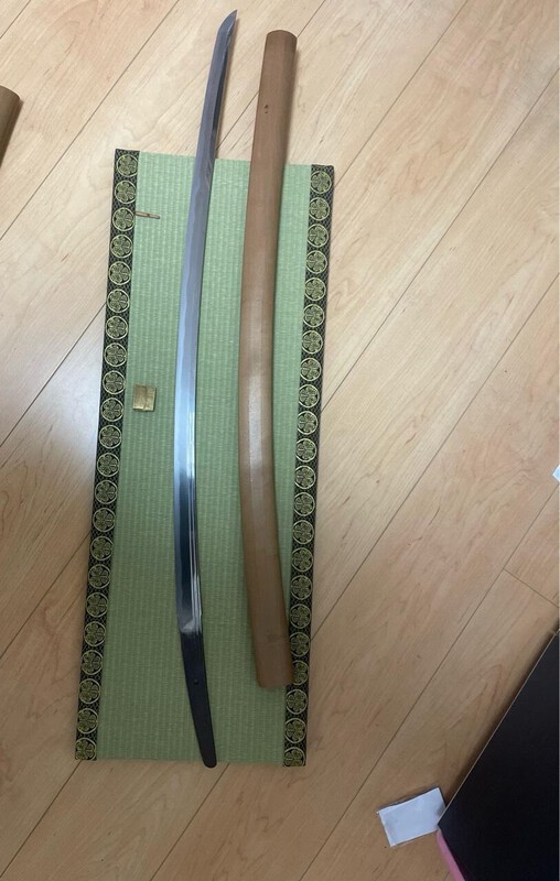

Hi Jussi,
Thank you for your recommendation. The Nobukuni one I bought is 75.4cm Nagasa and 2.8 Sori already. That is the reason I want to acquire a decent tachi with signature in 80+cm and 3+ sori.
I will keep looking for now and maybe increase my budget depends on the piece.
By the way I did enquiry one from Nipponto and it’s double my buget, what do you think about this one from Nipponto
https://www.nipponto.co.jp/swords10/NT333511.htm
this is my Nobukuni
