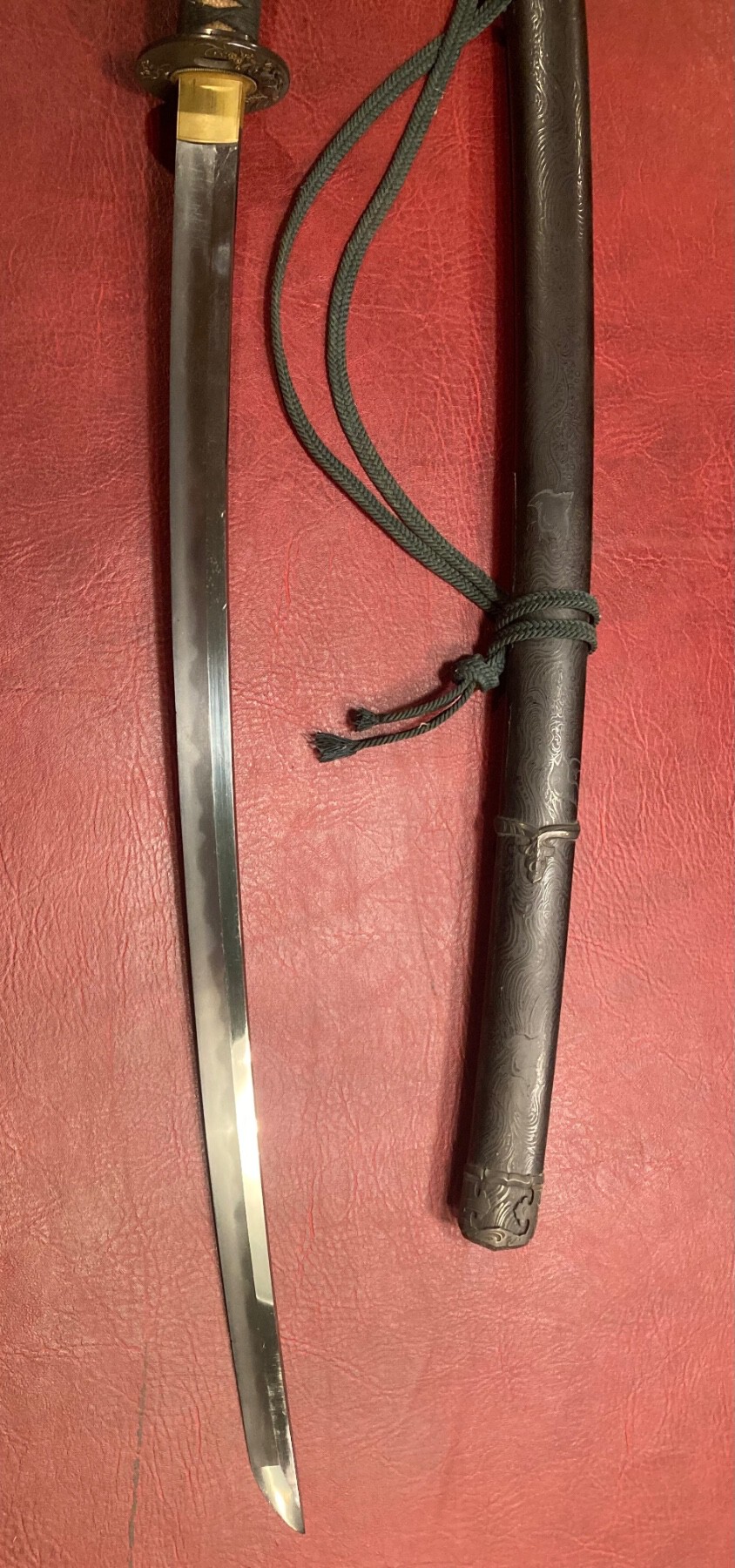

Okiraiders Posted April 10 Report Posted April 10 Looking for help in gaining more information on this family heirloom. We understand it was presented to our family member when leaving his position in Kobe Japan in the late 1800’s. Any help would be appreciated. Quote

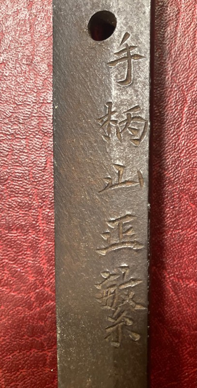

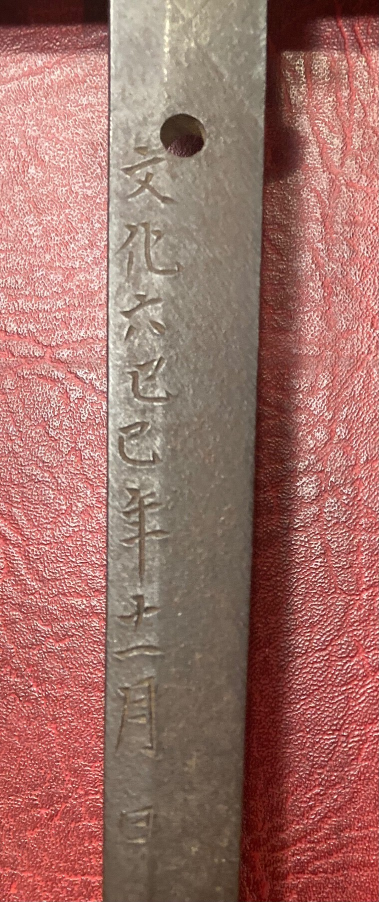

nulldevice Posted April 10 Report Posted April 10 Its signed: 文化六己巳年十一月日 手柄山正繁 I believe the date is: "A day in November of Bunka 6 (1809), year of the snake" Tegarayama Masashige My date translations are super rough, so its probably a bit garbled but I think its close. He was a quite high ranked smith (Jo-jo saku) who was active in the late 1700s to early 1800s. 2 1 Quote

Okiraiders Posted April 10 Author Report Posted April 10 On 4/10/2025 at 5:17 PM, nulldevice said: Its signed: 文化六巳巳年十一月日 手柄山正繁 I believe the date is: "A day in November of Bunka 6 (1809), year of the snake" Tegarayama Masashige My date translations are super rough, so its probably a bit garbled but I think its close. He was a quite high ranked smith (Jo-jo saku) who was active in the late 1700s to early 1800s. Expand Many thanks for the information. Would the age and smith make it worthwhile to have the sword appraised? Quote
nulldevice Posted April 10 Report Posted April 10 If other more knowledgeable members chime in and have no issues with the signature, I would say that it is worth sending to the NBTHK for appraisal, especially if you are already in Japan where it is a much simpler process. 1 1 Quote
Toryu2020 Posted April 10 Report Posted April 10 Certainly deserves further study - to my eye the spacing is off compared to the examples from Fujishiro - the Tagane seems heavy compared to the control examples and most especially the "Shige" character is wrong, look at the last three strokes. I would be curious to see the end of the Nakago does it match those in the book? -t 1 Quote

Nobody Posted April 11 Report Posted April 11 There is at least one example, which shows the bottom of 繁 is not just three strokes. 2 1 Quote

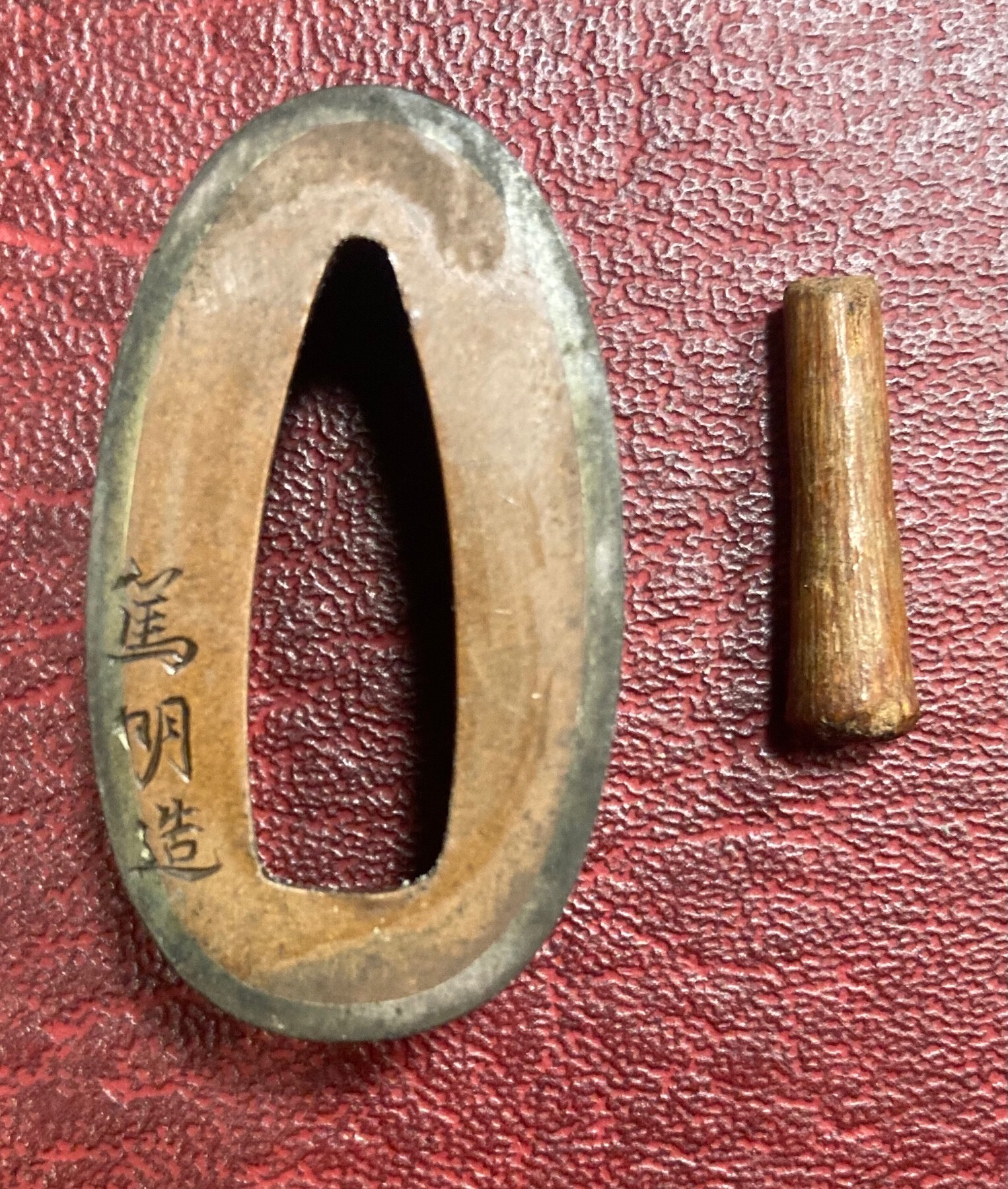

Bugyotsuji Posted April 11 Report Posted April 11 https://nqs.takaebi.sa.com/index.php?main_page=product_info&products_id=19442 Your Fuchi could be the same Meiji Kinkō artist 篤明 as in the link above. 1 Quote
Jacques Posted April 11 Report Posted April 11 Masashige changed the engraving of the Shige kanji since Kyowa the sword in question was made in Bunka, that said I don't trust this mei, It should bear the Kai no kami (甲斐守) title received in Kyowa 3 1 Quote
Bugyotsuji Posted April 11 Report Posted April 11 On 4/11/2025 at 3:46 AM, Bugyotsuji said: https://nqs.takaebi.sa.com/index.php?main_page=product_info&products_id=19442 Your Fuchi could be the same Meiji Kinkō artist 篤明 as in the link above. Expand 篤明 seems to be listed under both readings of Atsuaki and Tokuaki. Kyoto. 田中信造, with 'go' of 一寿斎, d. aged 50 in Meiji 22. Quote
