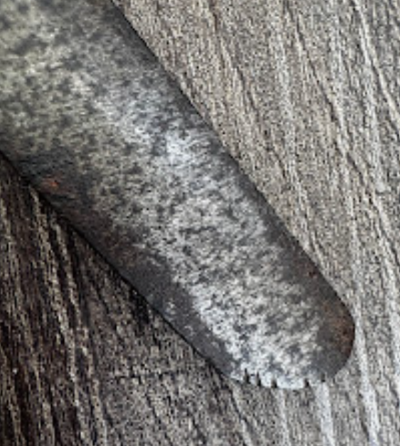

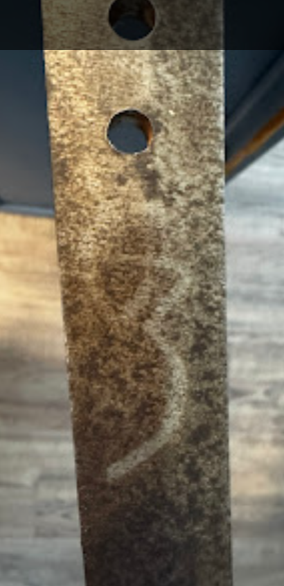

BurtMayer Posted April 7 Report Posted April 7 WWII Officers Sword - Tell me what I have? A recent local pick up. I know very little about Japanese swords. Someone told me this was a very good example and that the blade polish was very very high. Things I note: (Pardon my terminology, I'm new) 1. Five marks on end of tang. Blade testing's? 2. The high polish. 3. Overall Length 34 1/4, cutting edge 25 7/8. 4. Shadow highlight that looks like a "G over 3". Was this a spot that was originally painted on that was removed when fitted during WWII. 5. One person at the show said they believed it was WWII fitted about 1934 or earlier? No idea why they said that. 6. Two holes. One for the original assembly, the second for WWII? 7. I have good reason to believe this is out of an old collection. All photos are too large so below is a Google Photo Album Click here to see photos BurtM Quote

mecox Posted April 8 Report Posted April 8 Well its means one of us is wrong. It is tachi-mei, but from pics doesnt look shinshinto to me. As best I found his real name is Ishii Sanhachi and he was born Meiji 38 (1905) February. That would give ample time to have made a sword before the war, and for remounting as gunto. The lower hole looks a bit rough and newer? Is this the hole used on your sword? Sesko has another Tadaaki.....but not Hizen and different "aki": TADAAKI (忠明), Keiō (慶応, 1865-1868), Inaba – “Yamamoto Tadaaki” (山本忠明). I no longer have Hizen ref books. Quote
Brian Posted April 8 Report Posted April 8 Tang notches were usually to keep the fittings and blade together. They are almost certainly never anything to do with testing or "kills" 1 1 Quote
Bruce Pennington Posted April 8 Report Posted April 8 Like Brian said, they are Roman numerals. Yours seems to be "3 2" which will often match the numbers stamped on the fittings. But your fittings only has the "3". The fittings are nice, and an upgrade from standard. You don't show the saya (scabbard), but if it has haikan (belt hanger loops), it is a Type 94. Most likely it is a Type 98 officer sword. You can read about both versions on Ohmura's site: Military Swords of Imperial Japan. Posting photos of the marks and numbered fittings. The painted "3" also matches the fittings and the 3 of the hash marks, verifying these are there to keep the custom fitted parts together. 1 Quote
BurtMayer Posted April 8 Author Report Posted April 8 Thanks Bruce, photos of the saya are in the group. All of this makes sense, other than a very very old antique manilla tag that gives all the specs and has lines that say, Tachi blade, Hizen Kuni Tadaaki Saku, Shin Shinto, Metal case." Makes me wonder who looked at this years ago and what made them write the comments. Quote
nulldevice Posted April 8 Report Posted April 8 On 4/8/2025 at 3:54 PM, BurtMayer said: Thanks Bruce, photos of the saya are in the group. All of this makes sense, other than a very very old antique manilla tag that gives all the specs and has lines that say, Tachi blade, Hizen Kuni Tadaaki Saku, Shin Shinto, Metal case." Makes me wonder who looked at this years ago and what made them write the comments. Expand Hizen smiths usually signed with a tachi-Mei meaning the signature is facing outwards when the blade is worn cutting edge down. It’s one of the things that this school did that is fairly unique on blades in Shinto and later eras. There may be some confusion of the previous owner regarding the smith in question. Mecox above has a wartime smith that signed this way and the fittings also match that. Unless there is another Hizen smith that signed this way from the Shin Shinto era, it’s more likely that this is a wartime smith. The other stuff on the tags all seems correct. 2 Quote

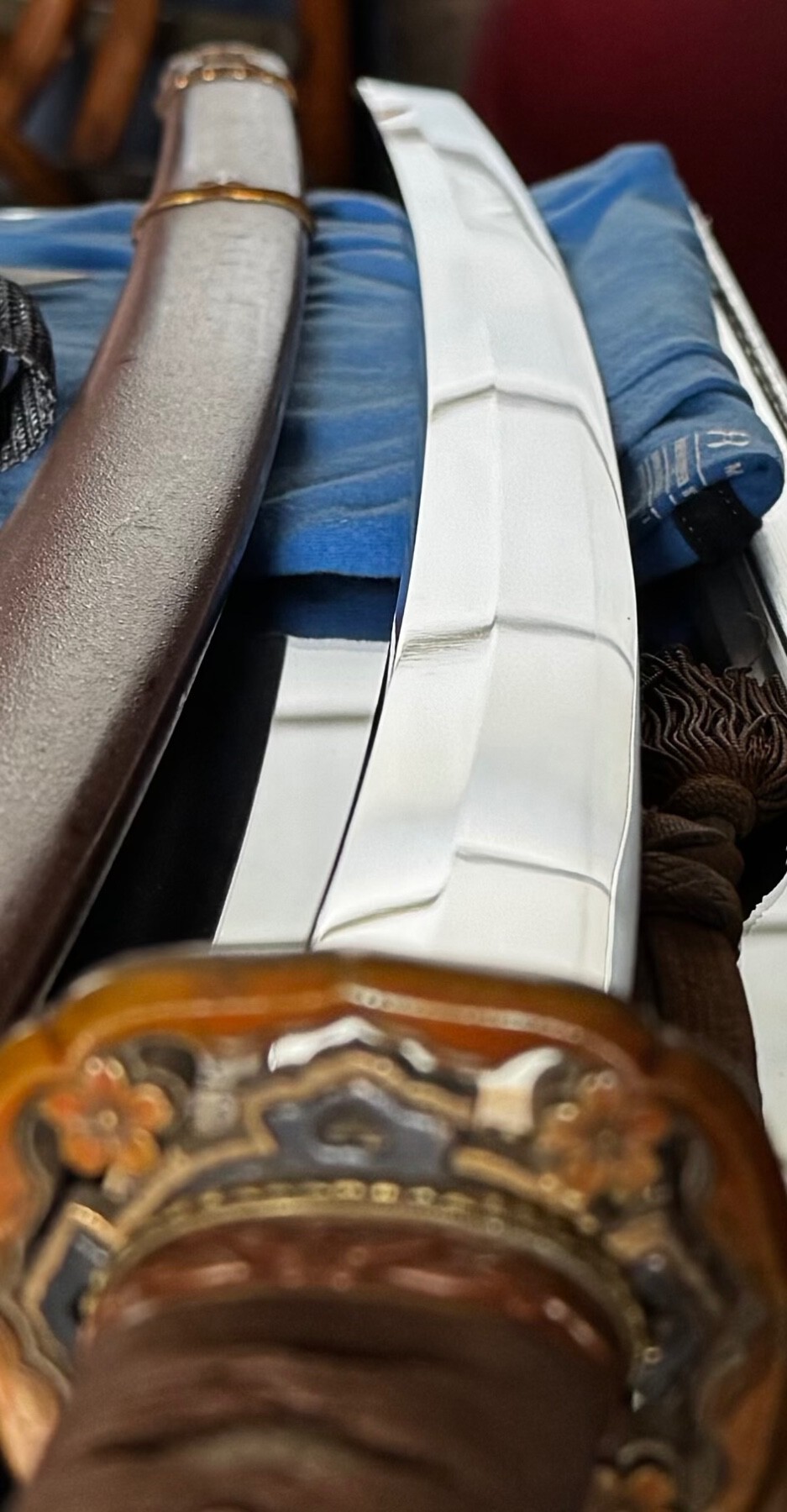

BurtMayer Posted April 16 Author Report Posted April 16 It’s taken me forever to capture the Hada, or did my camera play tricks on my eyes? Konuka Hada? 1 Quote
Geraint Posted April 19 Report Posted April 19 Dear Burt. To summarise somewhat. This is a very nice sword, the thick seppa/washers and the pierced tsuba/guard as well as some other features are probably what lead your friend to tell you it was 1934, there is a quality about these mounts which not all Shingunto have. The original label called it a tachi because of the fact that the mei/signature is on the side usually called tachi mei, most katana are signed on the other side of the tang. Now as Chandler has already said this is a distinctive feature of the Hizen school who tended to sign tachi mei on katana, it would not mean that the sword was a tachi though from a dealer point of view it might be nice to describe it as such. Dating it to Shinshinto or late Edo period is understandable but in this case wrong I think. Have a look at this thread, particularly about 11 posts down where Morita san has posted an oshigata that matches well with yours. This does suggest that this smith was known for forging gendato, traditionally forged swords as opposed to Showato which are not traditionally forged. To my eye and from your photographs your sword does look interesting and I wouldn't be surprised if it does turn out to be gendaito which puts it into a whole other bracket. Go slow, don't do anything more than wipe the blade surface with some very light oil and get in touch with a local sword club who can examine the sword in hand and tell you more. There is a ton to learn and a never ending mine of information to assimilate but the journey is fun. All the best. All the best. 4 Quote

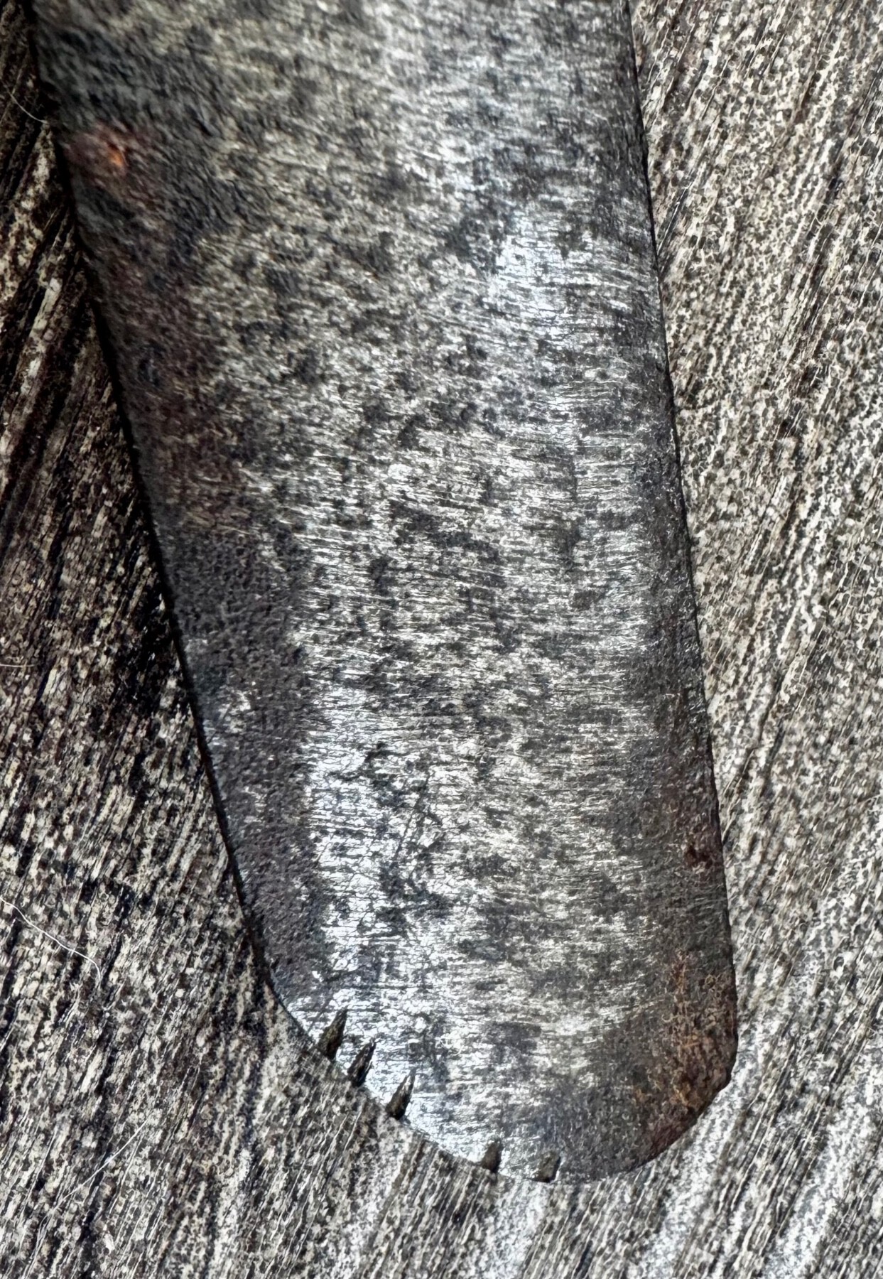

Bruce Pennington Posted April 20 Report Posted April 20 On 4/20/2025 at 2:36 AM, BurtMayer said: About the 5 notches. I do see a small division between 2 and 3 of the hash marks. "3" being the number on all the small parts of this sword in its current mounting. Why would they also paint a number 3 on it? I've searched the net for weeks, and no one definitively knows the answer. The answer is always batted back and forth. Also why the 2 holes in the tang? Expand Just a guess, but I'm thinking the hashed "23" was the original number that matched the numbered original fittings. "3" would be the fittings number of the current set. The 2 ana (holes) mean the blade was refitted to the current koshirae and had been in something else originally. It's a fairly common thing to see. Quote

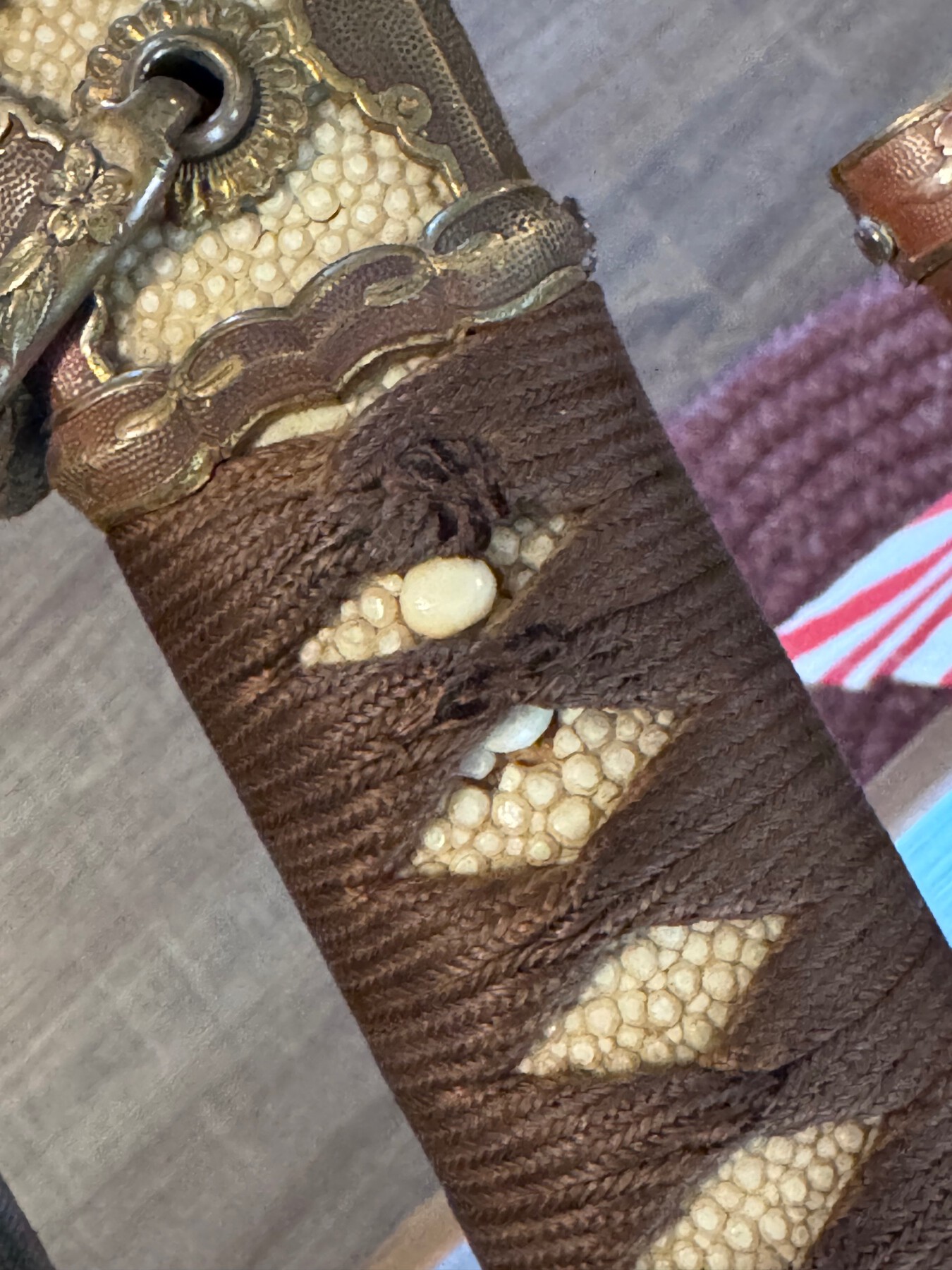

BurtMayer Posted April 23 Author Report Posted April 23 I also did not know what this was. After some research I realized it is a good thing. 1 Quote
BurtMayer Posted April 26 Author Report Posted April 26 I copied this paragraph from "https://nihonto.com/459-2/". Hopefully it does not offered or violate anyone. Q. Is it possible the 2 and 3 hash marks on my swords tang are an indication of original length? "MISC - Hizen blades are said to have the most stylish shape of all Shinto works, which opinion is probably based on their perfectly balanced curvature. The most popular length was 2 shaku and 2-3 sun (66.7-69.7cm). The Hizen works have a beautiful jihada, but since the kawagane (skin steel) is thin, there are frequently works where shintetsu has crept out. Not withstanding this trait, Hizen blades have, throughout their history, been highly sought by both Samurai and modern day collectors." Quote

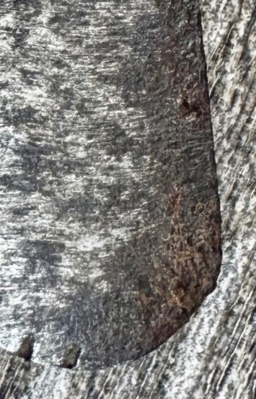

ROKUJURO Posted April 26 Report Posted April 26 Burt, your blade is obviously not EDO JIDAI. You can see that from the patina on the NAKAGO. If it was made as GENDAITO, it could be that the smith drilled a MEKUGI-ANA right after he forged it. When it was put into military mounts, they had to drill a second MEKUGI-ANA to make it fit. I would not assume a big secret in these notches at the ende of the NAKAGO. Certainly no hidden sign of age or length. This thread should have been posted in the "military" section Quote

Brian Posted April 27 Report Posted April 27 On 4/26/2025 at 7:51 PM, BurtMayer said: Q. Is it possible the 2 and 3 hash marks on my swords tang are an indication of original length? Expand No. As mentioned previously, these are almost always (never seen a single case of anything different) put there to mark the blade and identify it, likely for fittings purposes. If you send out a number of blades for fittings or work, you are going to want to mark them in such a way that you can identify what goes with what later. Quote
robinalexander Posted April 27 Report Posted April 27 On 4/23/2025 at 12:16 AM, BurtMayer said: I also did not know what this was. After some research I realized it is a good thing Expand Yes Burt, that is a good thing to have on your sword. It's a nice example of genuine stingray skin (samegawa) and having larger nodules around the top of the tsuka (more the better) again shows that these are better than average mounts. Nice package Love your enthusiasm. . Quote
BurtMayer Posted April 27 Author Report Posted April 27 I’ll have to take this to the lab and have it carbon dated. Looks like some very old rust. I think maybe a previous owner did oil the tang which may have inadvertently removed some of the built up rust. Quote
Scogg Posted April 27 Report Posted April 27 Burt, I’d be curious to see the results of any testing you do. That being said, I see nothing to suggest this sword is any older than what mecox’s original translation purports. Of all the World War Two swords I’ve handled, they’ve all had varying degrees of rust on the nakago from very pitted to shiny clean. The hash marks you see on the nakagojiri is a typical wartime method of keeping the blade and fittings organized during manufacture or assembly. See below a sword I handled this week. A wartime blade with hash marks to match it to some fittings. Your sword looks very nice and personally, I’d be proud to own it. All the best, -Sam Quote

ROKUJURO Posted April 28 Report Posted April 28 Burt, obviously, you are not informed about carbon dating: Radiocarbon dating (also referred to as carbon dating or carbon-14 dating) is a method for determining the age of an object containing organic material by using the properties of radiocarbon, a radioactive isotope of carbon..... The measuring accuracy is about +/- 40 years, so would not work for WWII. 1 1 Quote
BurtMayer Posted April 28 Author Report Posted April 28 ROKUJURO, I believe that comment was made light heartedly, lets say as a joke. I'm clearly not going to pay for this. Yup thats the funny part. I've studied hundreds of photos of documented blades, and probably thousands overall. I've also looked at every listed Showa, forged blade Gunto on militaria websites, and every current and completed eBay offering. The rust or lack of can not be a single factor when determining the age of a blade. I've seen blades that are dated in the 1500's that tang area looks great compared to the age, some even better than mine. On 4/28/2025 at 12:56 AM, ROKUJURO said: The measuring accuracy is about +/- 40 years, so would not work for WWII. Expand Quote
