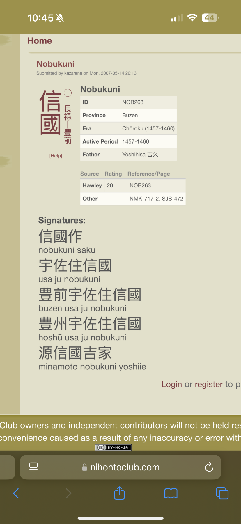

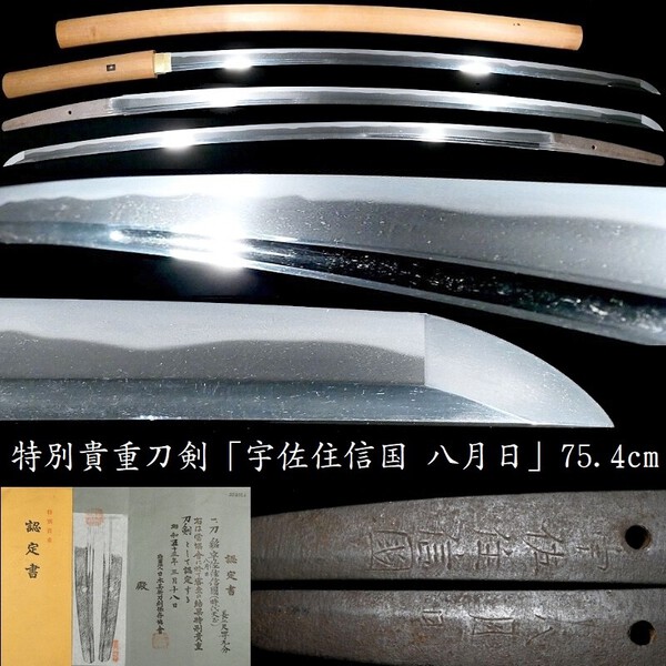

Bosco Posted April 7 Report Posted April 7 Hi, I just want to know how they determine which generation of Nobukuni for this sword. This is the best picture I could get. Thank you. Quote
Rivkin Posted April 7 Report Posted April 7 To keep matters fast and simple - its not, the chance of repapering today is 10%. 1 Quote
Bosco Posted April 7 Author Report Posted April 7 On 4/7/2025 at 10:35 PM, Rivkin said: To keep matters fast and simple - its not, the chance of repapering today is 10%. Expand Thank you, I have the same thinking as well. For the sword, do you have any comment for it ?. I plan to study on this one with a book. Gotta start somewhere. Quote
Rivkin Posted April 7 Report Posted April 7 Treating it as gimei: Around Tembun(?), weak hada, poor polish, hamon suffocated by hadori. 1 Quote
Cola Posted April 8 Report Posted April 8 On 4/7/2025 at 10:54 PM, Rivkin said: Treating it as gimei: Around Tembun(?), weak hada, poor polish, hamon suffocated by hadori. Expand How do you see the difference between hamon and hadori in pictures like these? Quote
Jussi Ekholm Posted April 8 Report Posted April 8 I wouldn't necessarily think too negatively about the sword. It is not "THE" Nobukuni lineage but instead quite unknown Buzen Nobukuni. As the signature would be 宇佐住信国 - Usa jū Nobukuni. 1 1 Quote
Rivkin Posted April 8 Report Posted April 8 On 4/8/2025 at 7:01 PM, Cola said: How do you see the difference between hamon and hadori in pictures like these? Expand Precisely - if only hadori is seen, it means either that hadori is very heavy or the hamon does not have any nie. The problem is that some of the photographs are from above, some taken at an angle. Both cases look nearly the same, but if you put the contrast to the max, there is some nie. Which suggests its very hadori heavy and most likely its ko nie without any large nie crystals. Otherwise you would see significant difference at different angles. 1 1 Quote

Bosco Posted April 9 Author Report Posted April 9 Since the paper was issued in 1970s. A bit of research and I found the signature was actually dated further back. Quote
Nihonto student Posted April 9 Report Posted April 9 Dear Minh, without going into this specific case of attribution, I think it is useful for you to read this article since I think it is the real answer to the title of your post: https://web.archive.org/web/20210123052725/https://blog.yuhindo.com/green-papers-no-papers/ You will find many posts about this argument on the forum... the advice I want to give you is therefore to focus on the study of blades with reliable certification and only when you have gained skills move on to the dubious ones. Regards Giordy Quote
Jacques Posted April 9 Report Posted April 9 Quote making it a truly remarkable piece of history. Expand This kind of sentence is a red flag for me As the certificate is no longer recognized by the NBTHK, this sword can be considered without papers. Quote
Shugyosha Posted April 9 Report Posted April 9 On 4/9/2025 at 2:47 PM, Nihonto student said: Dear Minh, without going into this specific case of attribution, I think it is useful for you to read this article since I think it is the real answer to the title of your post: https://web.archive.org/web/20210123052725/https://blog.yuhindo.com/green-papers-no-papers/ You will find many posts about this argument on the forum... the advice I want to give you is therefore to focus on the study of blades with reliable certification and only when you have gained skills move on to the dubious ones. Regards Giordy Expand As Jussi says, it's not the the big name Nobukuni, so there's no reason to suspect that this paper isn't the genuine opinion of the shinsa panel on the day it viewed the blade - if anything, the paper talks the blade down by ascribing it to the smith working in Tensho. If you read Darcy's article, it emphasises that the bigger then name, the greater the danger with these papers and that they aren't all bad - this is a small name smith and so this one is probably OK. @Bosco - the seller isn't going to tell you that the blade is a piece of junk that you definitely shouldn't buy and using the Sengoku Jidai as sales puff is something that occurs frequently as there's a degree of romance attached to the period that sells swords - but I've just reread your post and it looks like you've already gone for it, so I hope you like it once it arrives. Quote
Geraint Posted April 9 Report Posted April 9 Dear Minh. The date on the nakago is Tensho as Steve has pointed out. Nihonto club is a useful resource but not comprehensive, Hawleys lists several smiths signing this way working between 1350 and 1573. It is not reasonable to jump to a date based on Nihonto club which contradicts the mei on your sword, rather more likely to be one of the other smiths working in the Tensho period. Enjoy your sword and your research. All the best. Quote

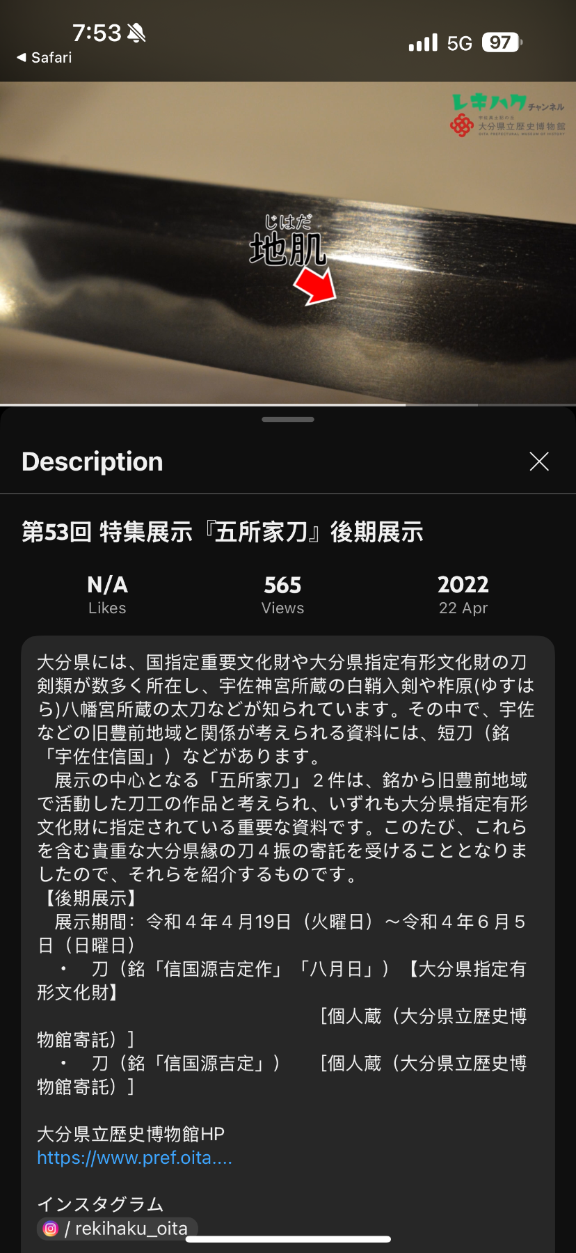

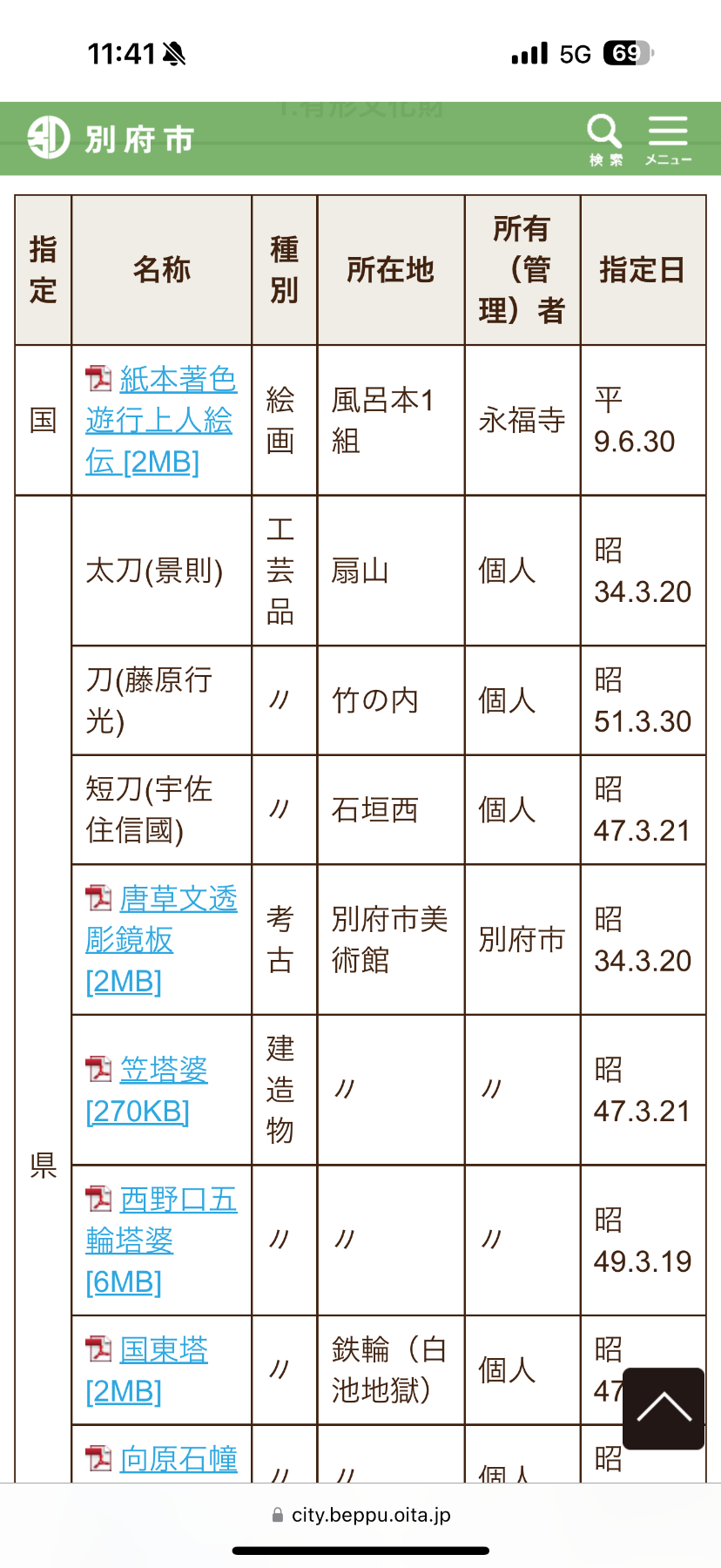

Bosco Posted April 9 Author Report Posted April 9 Thank you all for your information. To me I just want to track down who made it and it’s not fake that’s all I care about. It’s a beautiful sword. I have been trying to track down a second one signed with Usa Ju Nobukuni - 宇佐住信国 . But the only one I can find is in Oita Prefecture from Usa Jingu Shrine or Yusuhara Hachimangu Shrine a Tanto signed 短刀(銘「宇佐住信国」. I love research and study on new things, Nihonto has always been in my heart. But I never get to learn more. I genuinely asking for advice and opinions. But I’m young… we all started somewhere right ?. Have a great day guys. “ 大分県には、国指定重要文化財や大分県指定有形文化財の刀剣類が数多く所在し、宇佐神宮所蔵の白鞘入剣や柞原(ゆすはら)八幡宮所蔵の太刀などが知られています。その中で、宇佐などの旧豊前地域と関係が考えられる資料には、短刀(銘「宇佐住信国」)などがあります。” Quote

nulldevice Posted April 10 Report Posted April 10 On 4/10/2025 at 3:09 AM, Bosco said: My question was how accurate is the certificate with the signature. As far as I know there are only 2 out there with the same signature. Given the fact that the first Tanto signed Usa Ju Nobukuni - 宇佐住信國 was the only and first registered in 1972. It was displayed at Oita Prefecture Museum “ 第53回 特集展示『五所家刀』後期展示” . While the green certificate was given on 1976 so I bet it was the first time they saw such signature. Expand How do you know that tanto you found was the "only and first" tanto signed that way? The NBTHK has had hundreds of thousands of blades pass through their shinsa over the decades and there is no possible way to guess how many Nobukuni signed blades passed through in any given year. We'll likely never have that information in English let alone Japanese for the lower level papers. I would assume there are many more examples of blades with this signature that the NBTHK has record of. There isn't an online index where you can search NTBHK paperwork and only a small portion of papered blades make their way onto the internet where we can search them. The NBTHK asked that many people with older papers re-submit for a new shinsa just to clarify the very thing we're debating in this thread. Not all old papers are unreliable, but enough are that in order to remove all doubt, you should resubmit for Hozon and get the same attribution. 1 Quote
Bosco Posted April 10 Author Report Posted April 10 On 4/10/2025 at 3:45 AM, nulldevice said: How do you know that tanto you found was the "only and first" tanto signed that way? The NBTHK has had hundreds of thousands of blades pass through their shinsa over the decades and there is no possible way to guess how many Nobukuni signed blades passed through in any given year. We'll likely never have that information in English let alone Japanese for the lower level papers. I would assume there are many more examples of blades with this signature that the NBTHK has record of. There isn't an online index where you can search NTBHK paperwork and only a small portion of papered blades make their way onto the internet where we can search them. The NBTHK asked that many people with older papers re-submit for a new shinsa just to clarify the very thing we're debating in this thread. Not all old papers are unreliable, but enough are that in order to remove all doubt, you should resubmit for Hozon and get the same attribution. Expand Yet, none of Nobukuni signed Usa Ju Nobukuni has been sighted out there. Even deep search in Japanese wouldnt show up anything.I'm reaching out to Oita Museum at the moment to track down that Tanto so I can have more information on it. Because the green paper said Tensho which is 1573-1592. While the signature and particular one like this one is from Choroku 1457-1460. I want to discuss the year it was made and signed. How paper was given to Tensho. Not the condition of the blade. I’m a beginner, what I want to learn is fact and history. Please forgive my English if it sounded offensive to anyone here. Quote
Bugyotsuji Posted April 10 Report Posted April 10 (The old papers suggested Tensho, as Steve says.) Good luck and happy hunting. With such a regional, even local blade, I agree that there was probably no benefit to anyone by adding a gimei to it, as you say. Quote
nulldevice Posted April 10 Report Posted April 10 On 4/10/2025 at 4:02 AM, Bosco said: Yet, none of Nobukuni signed Usa Ju Nobukuni has been sighted out there. Even deep search in Japanese wouldnt show up anything.I'm reaching out to Oita Museum at the moment to track down that Tanto so I can have more information on it. Because the green paper said Tensho which is 1573-1592. While the signature and particular one like this one is from Choroku 1457-1460. I want to discuss the year it was made and signed. How paper was given to Tensho. Not the condition of the blade. I’m a beginner, what I want to learn is fact and history. Please forgive my English if it sounded offensive to anyone here. Expand I mean, there may be 10 more Usa Ju Nobukuni signed blades out there with old and modern papers sitting in collections that we may never see. The NBTHK has records of these and probably the best library of resources and oshigata in existence and we get only a very small glimpse into their world. What we do know is that during the shinsa session, they had reason to assign the blade to the Tensho Nobukuni and we know that they have more resources than just Fujishiro, Hawley, Toko Taikan, etc.. I hope you can find more information and wish you happy hunting as well. The thrill of tracking down new information is indeed exciting and challenging when dealing with a foreign language that is hard to search if you don't speak it at a decent proficiency level, even with good internet skills. Edit: Also, if your final goal is to put all doubts aside, a new shinsa is really the best way. The reasons have been beaten to death above. 1 Quote
Bugyotsuji Posted April 10 Report Posted April 10 Here are some more Usa Jū Nobukuni to sift through, from the Nihontō Meikan. (cont.) 1 Quote
Bosco Posted April 10 Author Report Posted April 10 On 4/10/2025 at 4:56 AM, nulldevice said: I mean, there may be 10 more Usa Ju Nobukuni signed blades out there with old and modern papers sitting in collections that we may never see. The NBTHK has records of these and probably the best library of resources and oshigata in existence and we get only a very small glimpse into their world. What we do know is that during the shinsa session, they had reason to assign the blade to the Tensho Nobukuni and we know that they have more resources than just Fujishiro, Hawley, Toko Taikan, etc.. I hope you can find more information and wish you happy hunting as well. The thrill of tracking down new information is indeed exciting and challenging when dealing with a foreign language that is hard to search if you don't speak it at a decent proficiency level, even with good internet skills. Edit: Also, if your final goal is to put all doubts aside, a new shinsa is really the best way. The reasons have been beaten to death above. Expand On 4/10/2025 at 5:24 AM, Bugyotsuji said: Here are some more Usa Jū Nobukuni to sift through, from the Nihontō Meikan. (cont.) Expand Thank you so much, I will definitely have fun with all this information. 2 Quote
