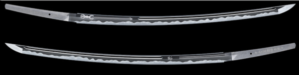

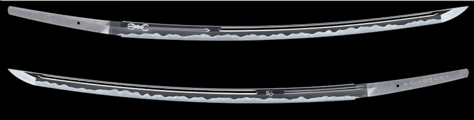

Kanenaga Posted Thursday at 09:37 PM Author Report Posted Thursday at 09:37 PM To be clear, we're talking about a shinsakuto. It has horimono but no hi. Regrettably, the maker is no longer living, so I can't ask him. I like the combination of horimono and hi, which I sometimes see (like the 2 below). Also, like many contemporary swords, it's heavy, so hi would lighten it. Just askin' tho. 1 Quote
