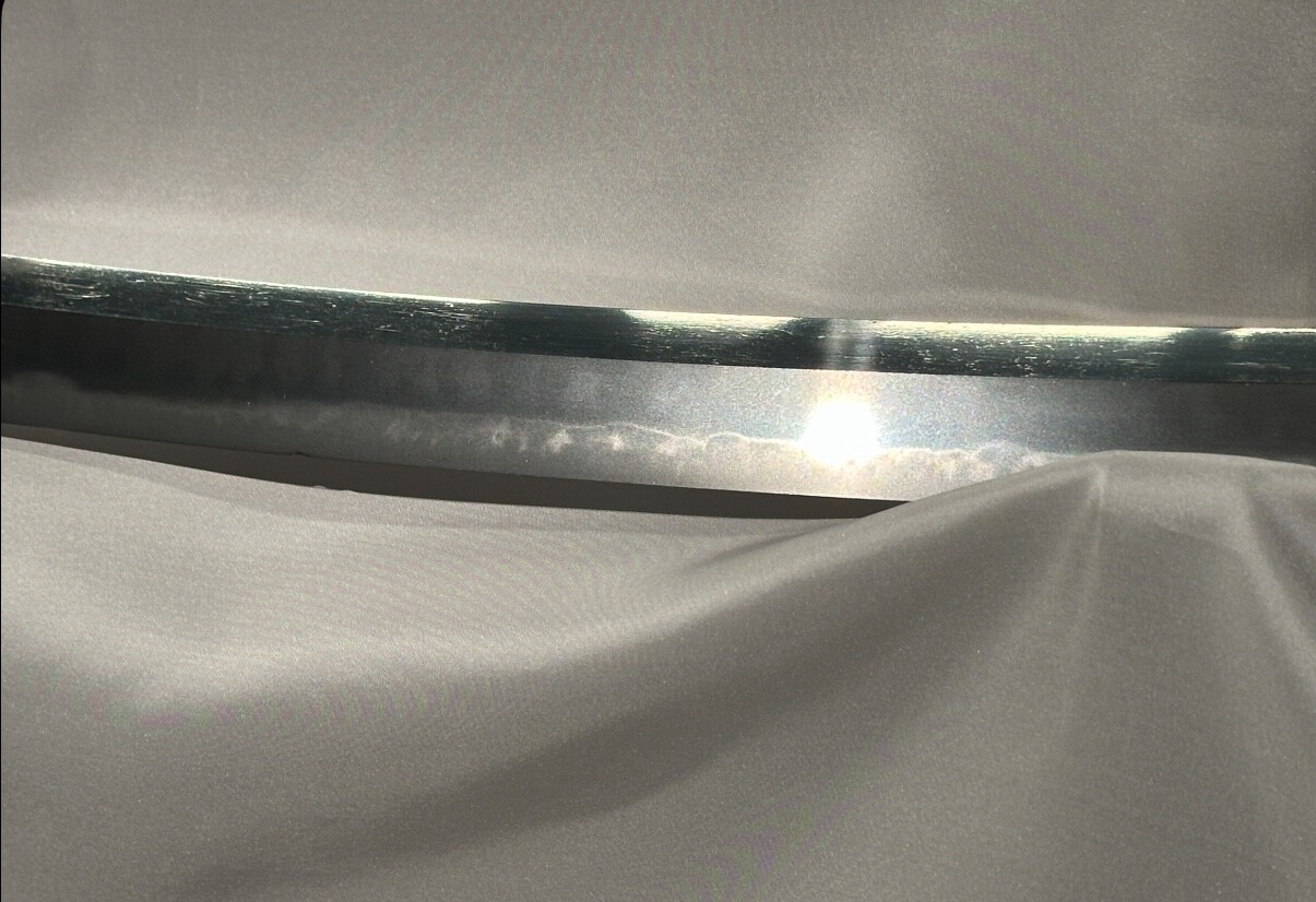

CSM101 Posted Wednesday at 04:06 AM Report Posted Wednesday at 04:06 AM Rai Kunimitsu - Nie utsuri Quote
