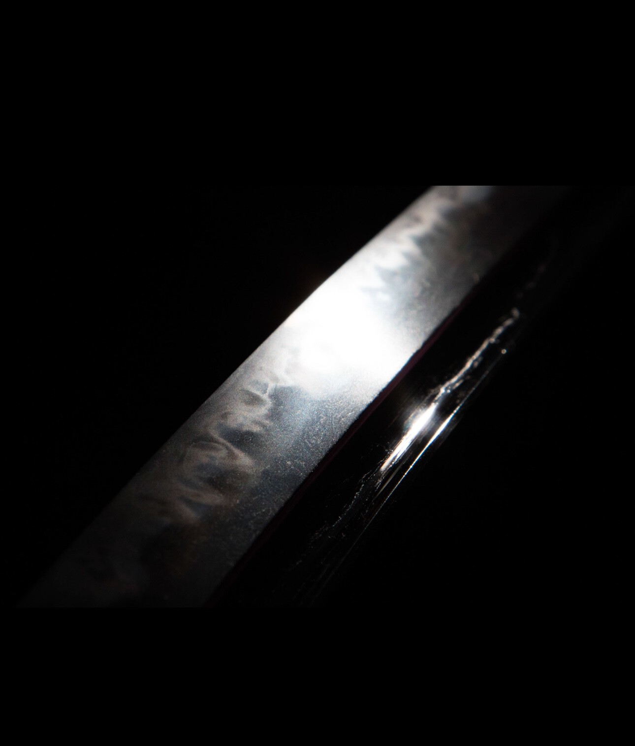

CSM101 Posted Thursday at 07:45 PM Report Posted Thursday at 07:45 PM I once wrote an article about Jigane & Jihada with photo of different kinds of utsuri. Here is a Ko Bizen Muneyoshi with jifu utsuri for a better understanding. Quote

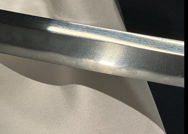

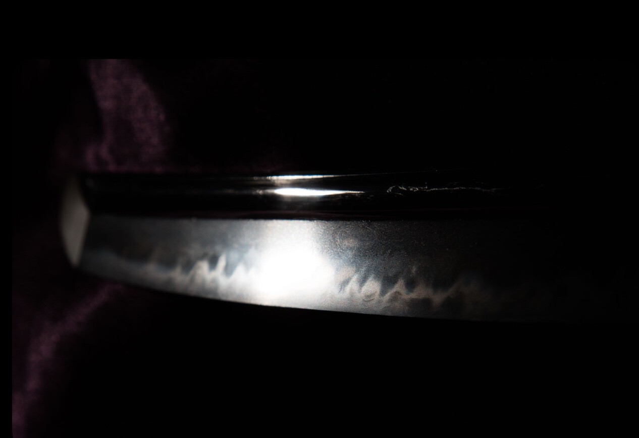

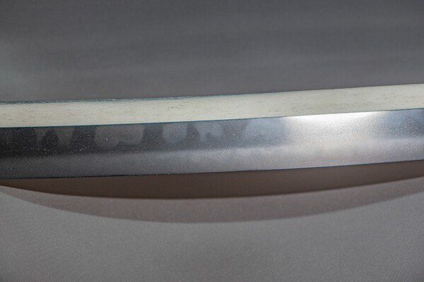

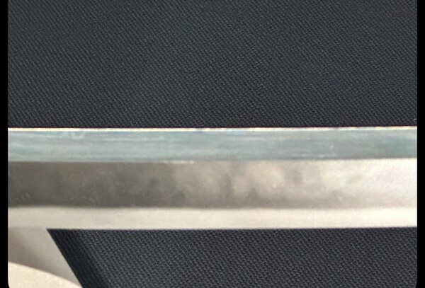

Lewis B Posted Thursday at 08:10 PM Report Posted Thursday at 08:10 PM A timely reminder to all those, like me, who like a blade exhibiting utsuri. Nefarious sellers out there praying on the appeal of this feature. https://www.facebook.com/photo/?fbid=2401552303244992&set=pcb.2401556073244615 https://www.facebook.com/photo/?fbid=2401552296578326&set=pcb.2401556073244615 A warning from Andrew Ickeringill " A warning to sword collectors... Please have a look at these pics taken from a Japanese auction site, when you look at this utsuri, what do you see? Have a good look and think about it before reading the below... This kind of utsuri was drawn to my attention a few years ago, a client had asked me to open a window on an old tachi. As soon as I saw the blade, I knew something was off... it had been acid etched (not unusual) but something else was going on with the utsuri. After a few minutes pondering I concluded that the utsuri was fake, but the owner wasn't convinced and still wanted a window opened. Sure enough, the window revealed the utsuri was completely artificial, it came right off and didn't return. I believe the sword pictured here has had the same treatment, it has no utsuri... well it might have some kind of utsuri underneath the artificial one, but I doubt it. I'm guessing it's been created using some kind of VERY strong chemical process, applied either very carefully with a cotton bud stick, or perhaps a stencil was used as a guide. I've been seeing this kind of "utsuri" quite a bit recently, mainly coming from the Japanese auction sites. It's a very cheeky deception that I imagine has fooled many people. So, how can I tell this is fake just from looking at pics? That's the hard part to explain, I'll do my best... For starters, how do you view utsuri? Similar to the way you view the hamon. Real utsuri generally can't be seen very well from the angle that you'd normally view the jigane from, which is from directly above. But the "utsuri" in these pics shows up very strong in the jigane pics. What about the shape/pattern of this "utsuri"? It seems there's a contrived shape and repetitive pattern. On a sword with this kind of gunome-ba, I'd expect real utsuri to mirror the hamon in a similar flow, the utsuri would rise where the hamon dips into valleys, and the utsuri would fall where the hamon peaks (this isn't always the case with real utusri, for example shirake-utsuri). But with this sword you can clearly see the pattern of the utsuri is often at odds with the flow of the hamon in a very unnatural way. Also, please note the granule-like/mottled texture of this "utsuri", it's a result of the acid and you don't see that effect in real utsuri. One more thing, look how defined this "utsuri" is, especially the area down towards the hamachi where they've tried to emulate a mizukage-like effect. It's so sharp and defined, like it's been painted on, well it basically has been! So, just beware of these Japanese auction sites and their swords, some are gimei, some are acid etched in the hamon and jigane, and some have completely artificial utsuri. I'm not saying don't buy from these sites, there are some good swords to be found there, but you need to be aware it's like navigating a minefield, please be cautious and don't get had! I wouldn't recommend buying anything from these sites unless it's at least papered Hozon level." 1 Quote
