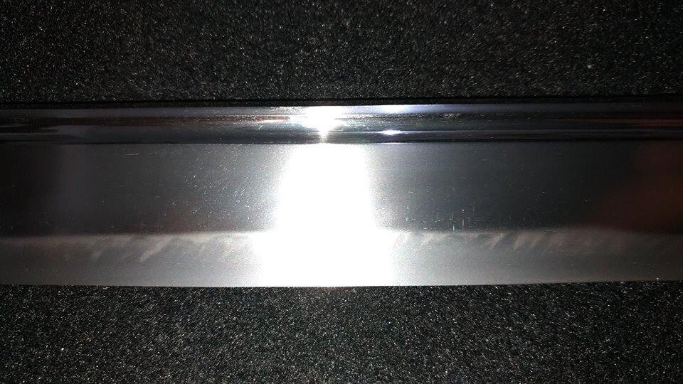

C0D Posted April 2 Report Posted April 2 3 minutes ago, Franco said: The name of this smith? Images of his work? Or even verbal descriptions? Type of utsuri he's producing? Thanks. The smith is Kei'un Naohiro 1 Quote
Franco Posted April 2 Report Posted April 2 While this appears to be utsuri, and this smith may have discovered a technique for producing this utsuri, sorry to say that it is no where near the level, quality, and control of utsuri seen and produced on earlier Koto period swords. If only it were easy. 1 Quote
C0D Posted April 2 Report Posted April 2 Just now, Franco said: While this appears to be utsuri, and this smith may have discovered a technique for producing this utsuri, sorry to say that it is no where near the level and quality and control of utsuri seen and produced on earlier Koto period swords. If only it were easy. I never said he did master the old koto masters utsuri, and anyway those are just two examples that I actually own. This topic isn't about who made the best utsuri, but how utsuri is made 2 Quote
Franco Posted April 2 Report Posted April 2 3 hours ago, C0D said: The way to create that utsuri is actually "simple", you heat up the edge of the blade only to the temperature of quench, so the rest of the blade will have transitional temperatures which will turn out in different cristalline structures in the metal and different hardness, resulting in a different appearence once polished. 26 minutes ago, C0D said: I never said he did master the old koto masters utsuri, Understood. Still, it needs to be made clear that there is a world of difference. Even between old swords there are significant differences between the types of utsuri. p.s. looking at your image again I would describe this utsuri as being more like a second hamon than genuine utsuri, a shadow of the hamon, a reflection of the hamon. Quote

C0D Posted April 3 Report Posted April 3 8 hours ago, Franco said: Understood. Still, it needs to be made clear that there is a world of difference. Even between old swords there are significant differences between the types of utsuri. p.s. looking at your image again I would describe this utsuri as being more like a second hamon than genuine utsuri, a shadow of the hamon, a reflection of the hamon. same blade as the same picture, not a second hamon. I know how to look at utsuri another blade from same swordsmith, is this "real" utsuri? 1 hour ago, Rayhan said: It has been a very long time since i had an inkling to comment on the board but since i am in Japan and saw some amazing Nihonto i just dropped by and saw this very interesting topic. Utsuri is a result of the process of thermocycling the steel in different intervals befor yaki-ire. Koto smiths could not afford to make mistakes with their steel. Tamahagane was not in abundance (still isn't) and so thermocycling was used as a way to reduce any risk of issues when quenching. What we must do is look at the direct meaning of Utsuri (to change, to transition) those who own Koi will also understand Utsuri and its meaning. The swords were clay coated in cases and put through thermocycling many times before being quenched. New clay is applied at various intervals, removed and reapplied. This takes time and precission. This produces varying hardness at mm dissipation throught the koto blades. In the later Edo period swords were made in different styles and made in more flamboyance with an emphasis on hamon and the Shinogi was not really part of the same outer jacket of the sword overall so this process was cut back. This also made production of blades faster (no doubt the lessons of cutting corners in the Muromachi period). And so those smiths that reproduced Utsuri in the Edo period and now are following an extensive, time consuming process when making their blades. Who made this theory? Do you have any evidence or experiment about this process? This sounds an overly complicated process for someone who wants to reduce the risk of mistakes during hardening, not to mention this might give some extra internal stress. This would not be easy even with modern day tools. 1 Quote

Franco Posted April 3 Report Posted April 3 (edited) 1 hour ago, C0D said: same blade as the same picture, not a second hamon. I know how to look at utsuri another blade from same swordsmith, is this "real" utsuri? If you know how to look at utsuri why are you asking me? But, since you asked, utsuri? No, perhaps an utsuri like effect. Which is not the same. Saiha gives an utsuri like effect, but it's not utsuri according to Yamanaka. Effect is not the same as what my eyes are seeing. Even when you do see utsuri, it becomes apparent that certain types of utsuri are quite intentional. While other types are more incidental. Edited April 3 by Franco Quote
