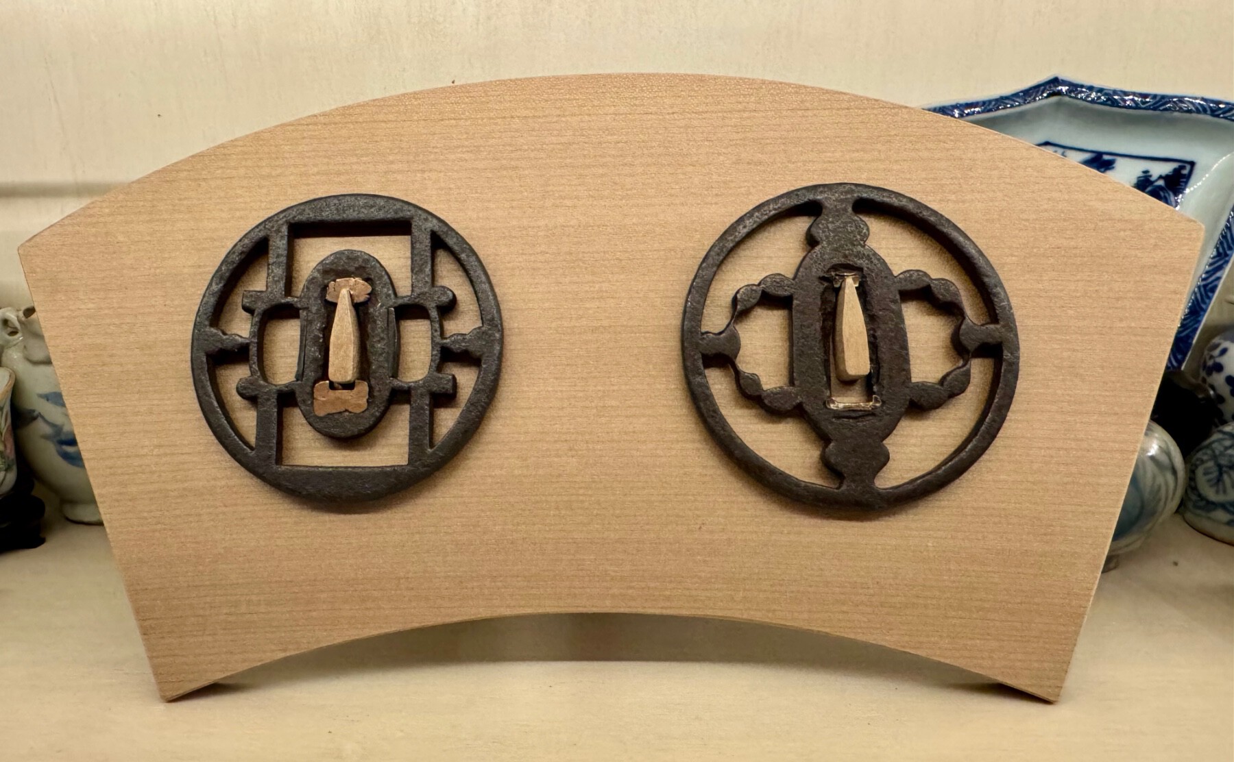

Kanayama tsuba are thought to have been produced only during a 25-30 year period spanning the late 16th and early 17th centuries during the Momoyama and earliest Early Edo Periods. They reflect the aesthetics of the Wabi Tea Culture of their time. However, like all trends occurring in a small sub-population of refined connoisseurs (the buke in this case) amidst the rapid changes in sensibilities that accompanied significant transformation of the sociopolitical landscape, their demand and production were short-lived.
We presume that there were, therefore, only a very small group of tsubako in Owari Province at the center of this artistic development. The problem is that none of their creations are signed. Is it possible, nonetheless, to identify individual tsubako based on characteristic features of their mumei works (e.g. motifs, composition, forging techniques, etc.)? Just as we have Shodai, Nidai, and Sandai masters of a particular school such as Yamakichibei (at least 5 masters and perhaps other smiths in their workshops).

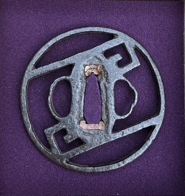

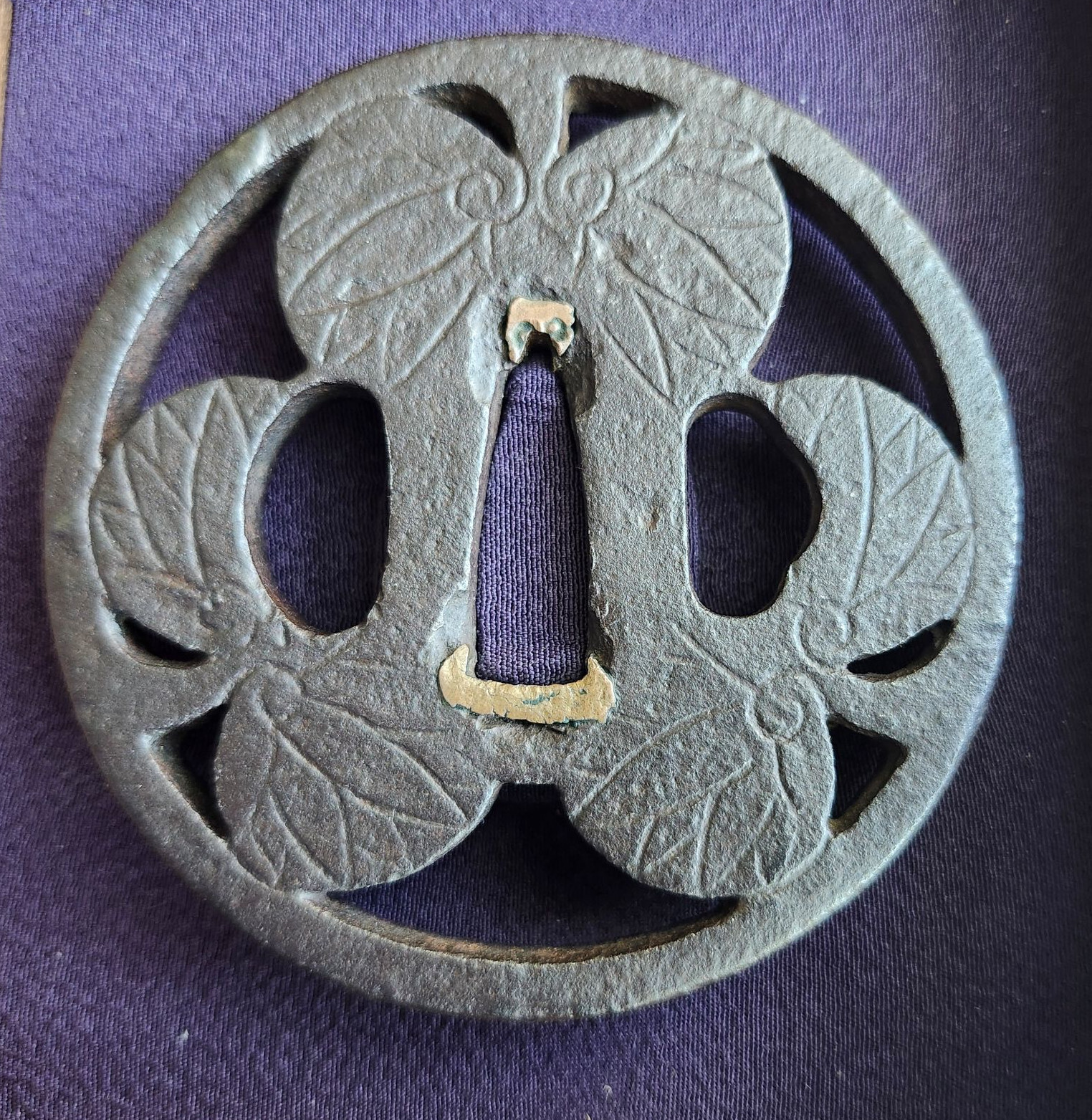

I submit two tsuba from my collection that I display together because they share so many features in common that they are highly likely to have been the products of a single smith or small atelier, whom I call “Hyotan-dai” (maybe someone can offer a better phrase) because of his apparent fondness for gourds as depicted in my two tsuba. This is speculative of course, but nonetheless compelling. Same iron forging technique (including tsuchime and tekkotsu), perfect marugata type, similar style of seppa-dai, square mimi, and same color/texture. In toto we see a defining profile of his workmanship.

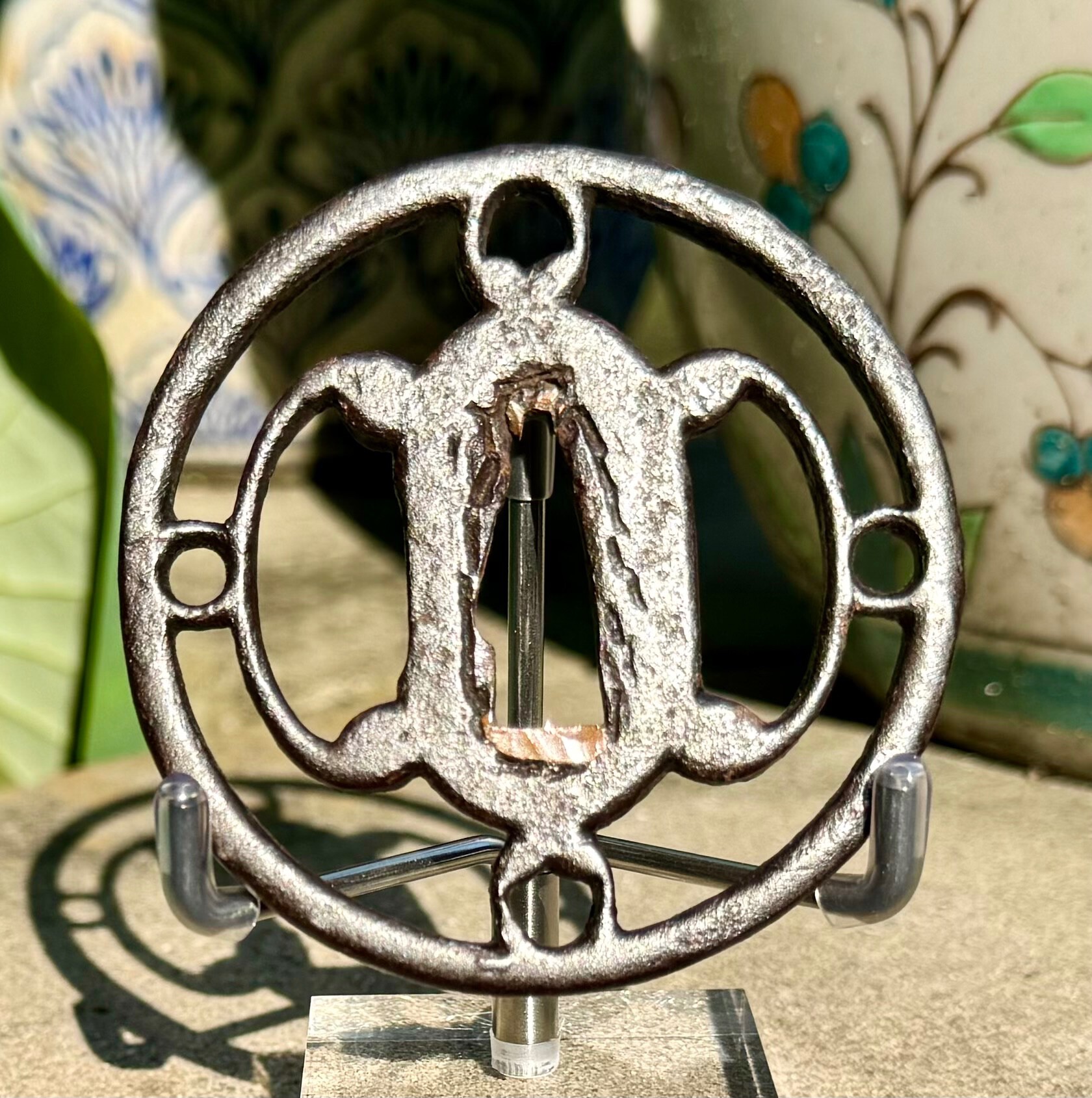

Here is the $175 Kanayama tsuba I picked up somehow along the way in Singapore (about 2001) at an antique shop, not realizing what I stumbled on until a year ago when I saw it published in Owari To Mikawa No Tanko. It is just chock full of tekkotsu and dripping with Wabi Tea Ceremony aesthetics. It has punch marks around the nakago-ana.

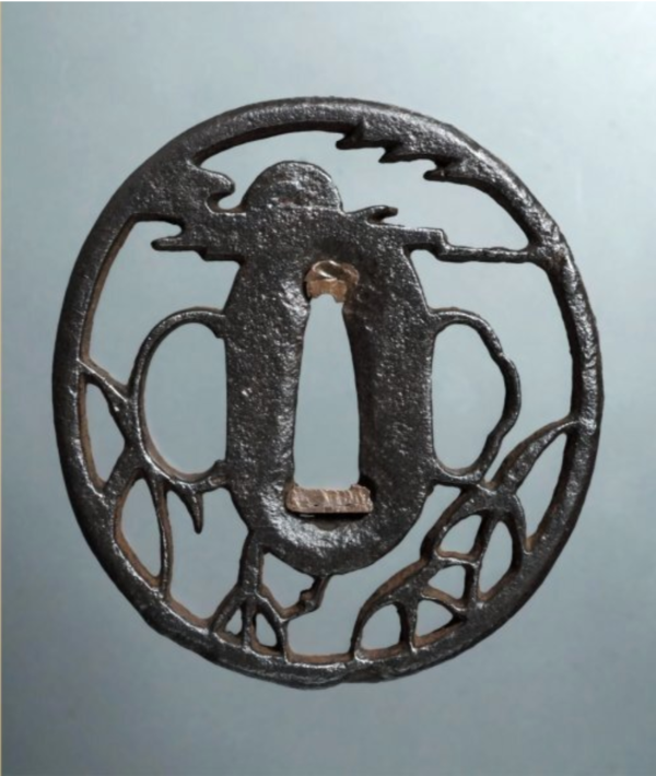

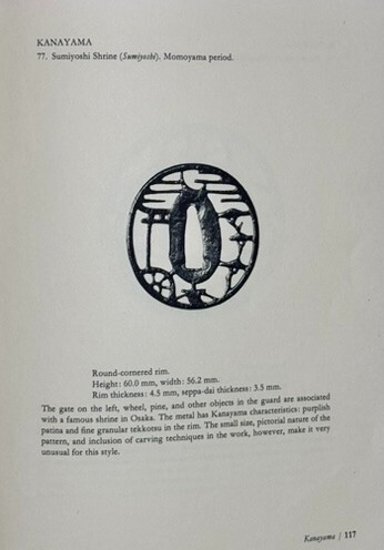

Here is another "grouping" of Kanayama tsuba (small size, lumpy tekkotsu), but with unusually pictorial imagery. Sasano doesn't quite argue that #1 and #2 are likely by the same smith, but he presents them together and describes them as unusual. If this is another distinct Kanayama workshop group, then the taste is more of the "rustic elegance" sensibility of Enshu's kirei sabi. An additional one (#4) from my collection (ex-Sasano, Gold book, #75) has the same yakite shitate "melted" surface treatment and hitsu-ana that are similarly if not identically shaped as those of #3 (especially the kogai hitsu-ana).

Interesting observation on those poetic and atmospheric pictorial kanayama being kierei-sabi, I had not thought of them that way before. Enshu was the Tea Master to the Shogun Tokugawa Iemitsu, where we see the Tokugawa-driven shift in Buke education away from Buddhism to Confucianism, following the Chinese scholar-warrior model. This aligns with ther rise of Kaneie (also kierei-sabi), which this scholarship I recently discovered, (published in the JSS/US Newsletter by Arnold Frenzel) puts Kaneie in the early Edo period, much later than what has been supposed by other researchers.
