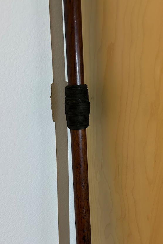

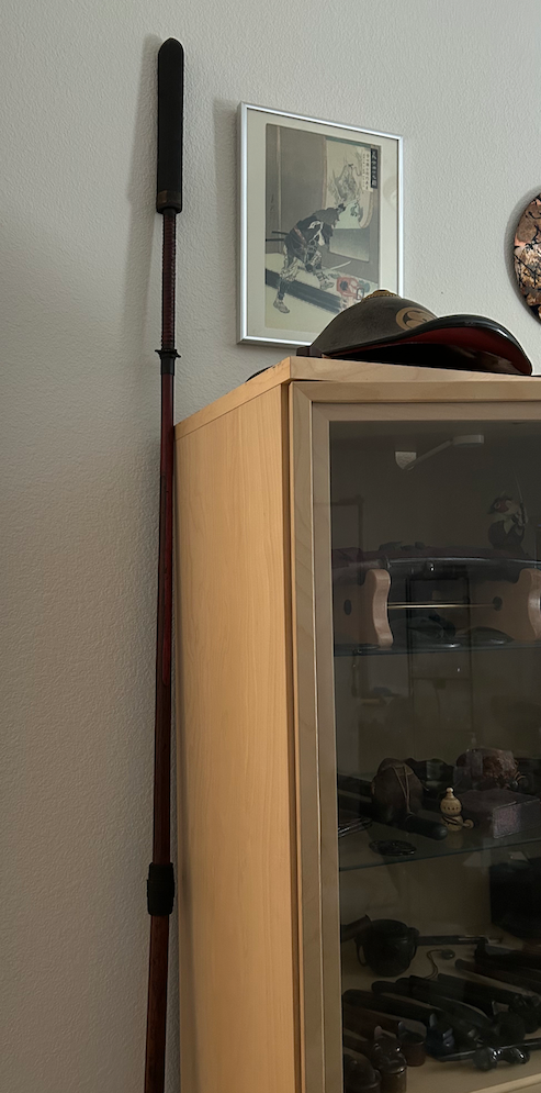

As some of you know, yari poles often come cut here in the US, due primarily to shipping costs and storage issues (see pic 1). I wanted to display the pole as a single piece, however not by doing a permanent, blended repair (may come later). I also didn't want the fix to look completely out of place (e.g., clamps, duct tape, etc.).

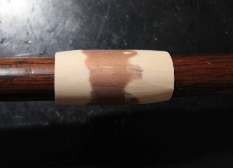

I decided on a quick collar that resembled a kaburamaki to somewhat blend in with what would normally be on a pole (I know - its position is too low but that's where the cut was). See pics 2 and 3. This attaches without glue or fasteners so the pole can be disassembled for storage or shipping.
Here was the process for those interested in doing a similar fix:

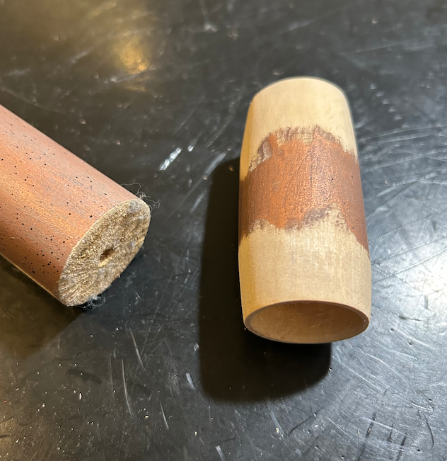

1. get a pole of larger diameter. In my case, a wooden curtain rod worked.
2. cut to length and drill out the center. I used a 1 inch forstner bit.
3. Sand to a barrel shape to represent the kaburamaki
4.Wrap with cord. In this case, I used yellow hemp cord that I dyed black.
5. Slip over the ends without glue or fasteners. It will hold for display and allow the pole to be quickly taken apart and shipped/stored.
