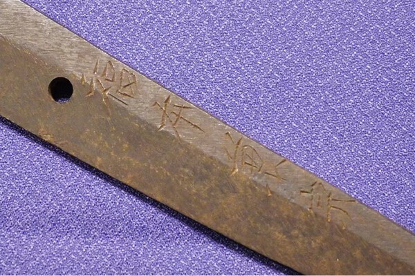

IBERIAN Posted March 21 Report Posted March 21 Greetings to all. I bought this katana. Showato. WWII period but I have no data on this swordsmith. The seller indicates that it is FUKUMOTO KANEMUNE and the material tamahagane. I think there is hamon line but I can't see it well. On one side of the tang is the signature. There is a marking on the other side of the tang. I think the mark is an inspection check, but I'm not sure. If anyone can give me details of the craftsman and the mark I would appreciat Thank you for your help. A greeting. Jose. Quote
John C Posted March 21 Report Posted March 21 Jose: The black mark on the tang is the number 8 (hachi); an "assembly" number. The fittings look like the type carried by Gunzoku, civilians working for the military. Are there any marks above the signature closer to the habaki? John C. Quote

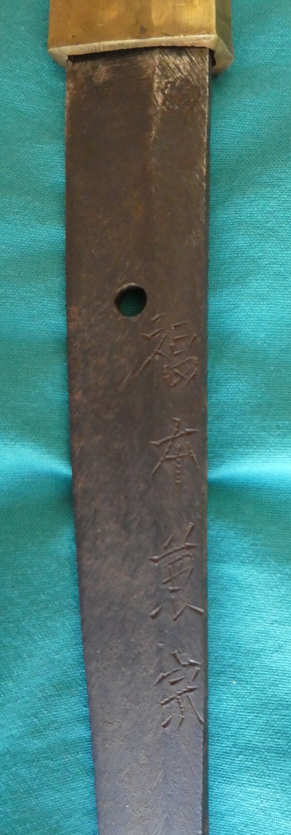

IBERIAN Posted March 21 Author Report Posted March 21 Hello John , Thanks for your help. There is no mark above the signature. I too thought it might carry arsenal mark but it does not. Please John, can you confirm translation of signature on the tang, ¿FUKUMOTO KANEMUNE?. Jose. 1 Quote
mecox Posted March 21 Report Posted March 21 Jose, the mei reads Fukumoto Kanemune 福本 兼宗 with some variation in cutting style. He was a major swordsmith in the Amahide workshop of Seki and it appears the mei could be cut by different people. As noted this is in koshirae for civilian use. In NMB Downloads his background and examples: 4 Quote
