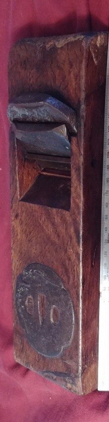

Bruce: Thought this was interesting. While researching the above kanna blade, found this kanna plane that may have been used to make koshirae at Nakano Shoten.
John C.

@John C  @Bruce Pennington  John interesting plane, mei on blade is probably Senkichi  千吉  and yes the ink character on the plane is trademark of Nakano Shoten.
This trademark was applied for in Meiji 37 (1904) June 9 and registered same year on September 1.   Registration No. 21988 was to  Nakano  Youzou  中野要蔵 and used into WW2.
Nick Komiya [“warrelics”]  notes that this logo would be read as “Yamayo”, the upper representing a mountain (“yama” 山) and the lower as katakana “yo” ヨ.

@John C    Yes the kanna blades by Teruhide and family were well described, but I dont recall reports of others during wartime.   However, quite a few Seki (and other) wartime tosho came from backgrounds (father or grandfather) of agricultural tool makers or edged utensils (hamon) and also quite a few went back to that after the war (eg Toki family).
