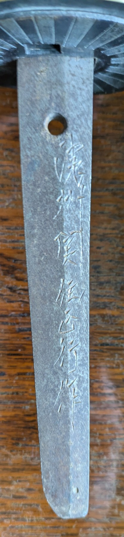

Hi guys,
Hoping someone would be kind enough to help me again! I've tried translating this, but I just can't seem to find the matching characters for a bunch of these kanji... (Any book recommendations for a decent reference list beyond Sesko's Swordsmiths would be very welcome :))
PXL_20250314_094740009_MP2.thumb.jpg.34a4394d72684e301472c1d89f401589.jpgPXL_20250314_094721537.MP3.thumb.jpg.2c6af3ea33cda6411c045561b4a8ea77.jpg1100458598.jpeg.fe46cbf2fc8ffee1bf0931ae86f16575.jpeg1100458597.jpeg.3aa55afcbf5fb85cfa9cd8105ccf2a2e.jpeg
(The sword literally only arrived at my home today fifteen minutes before I had to leave for a ten day trip to Germany just, so apologies for the slight blurring - I've added the original auction photos to help too)
Thanks,
 George

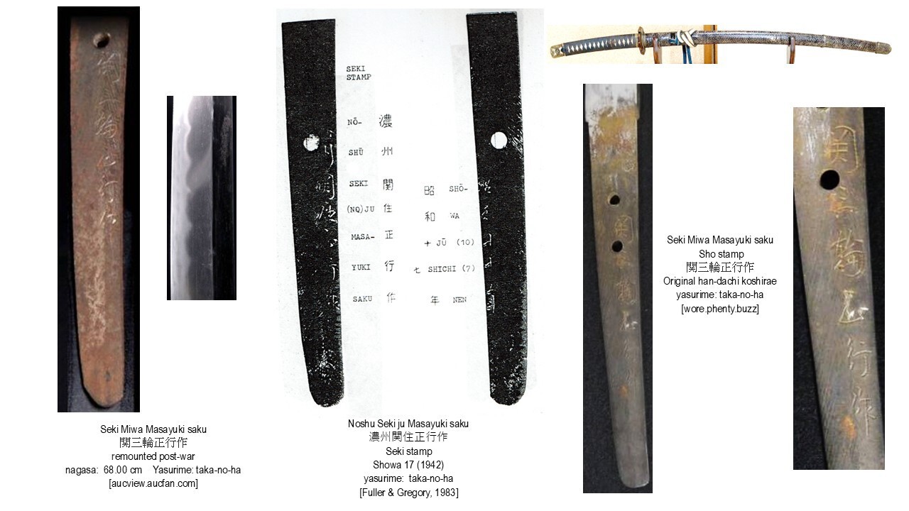

After looking further....this is MASAYUKI (正行),  but I dont think it is  Miwa Tomoo (三輪友雄), born August 8th 1895.   As he used taka-no- ha yasurime and was mostly before 1943.
Here is similar example from Japanese Sword Index

Apologies for the delay, I'm back home now with the blade in hand properly.
Which Masayuki could it be though? Sesko only lists two Showa smiths of that name:
MASAYUKI (正行), Shōwa (昭和, 1926-1989), Ōsaka – “Ikeda Masayuki kore o saku” (池田正行作之), “[Swastika] Masayuki” (卍正行), real name Ikeda Tatsuo (池田辰男), born November 20th 1938, he studied from 1954 under his father Masahisa (正久) (see picture right)
MASAYUKI (正行), Shōwa (昭和, 1926-1989), Gifu – “Masayuki” (正行), real name Miwa Tomoo (三輪友雄), born August 8th 1895, he worked in Seki as guntō smith
And the first one there would have been a toddler at the time that was signed... (Not to mention there is no swastika)
Is that a large or small Seki 関 stamp?  Can you measure the height of the stamp?

@George KN   George, well looks like yours is probably Miwa Masayuki.  Its a bit confusing and as you note Ikeda would be too young.  I found some other examples that have both taka-no-ha and sujikai filing, and although mei changes a bit looks to be the same smith.
It is possible for dated blades he used taka-no-ha earlier and Sho stamp? (1941, 1942) and sujikai later with Seki stamp? (1943).    But still needs more study.
Miwa Masayuki is listed in 1940 in Seki Token Kaji Association and also to have registered as a Seki swordsmith in Showa 14 (1939) October 26.
 Slide1.thumb.JPG.da421a4ba47a7f01d3ecf4f289999a67.JPG     Slide2.thumb.JPG.3b4895037293eee0ba668ad3d4d9e949.JPG
I believe it is the large Seki stamp - it is 5mm tall by 4mm wide. Apart from the painted sub assembly number, the only other marking is that single dot at the bottom of the nakago. Thanks for confirming the sub assembly number, it definitely matches all the other roman numerals on the fittings then! I've uploaded more pics of the blade and fittings on the original military thread here if you're interested and haven't seen it already: https://www.militaria.co.za/nmb/topic/51690-how-to-valuerank-showato
