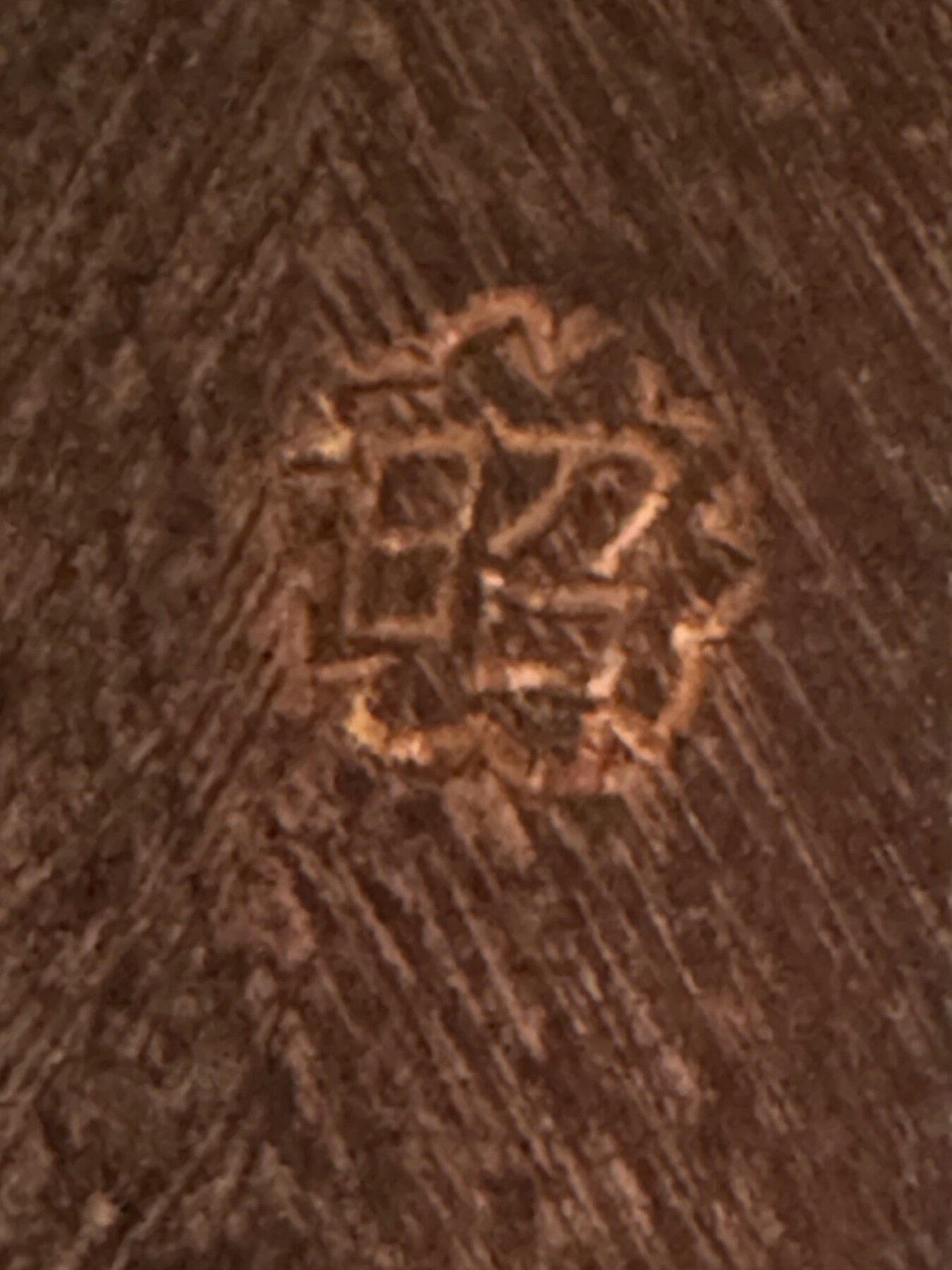

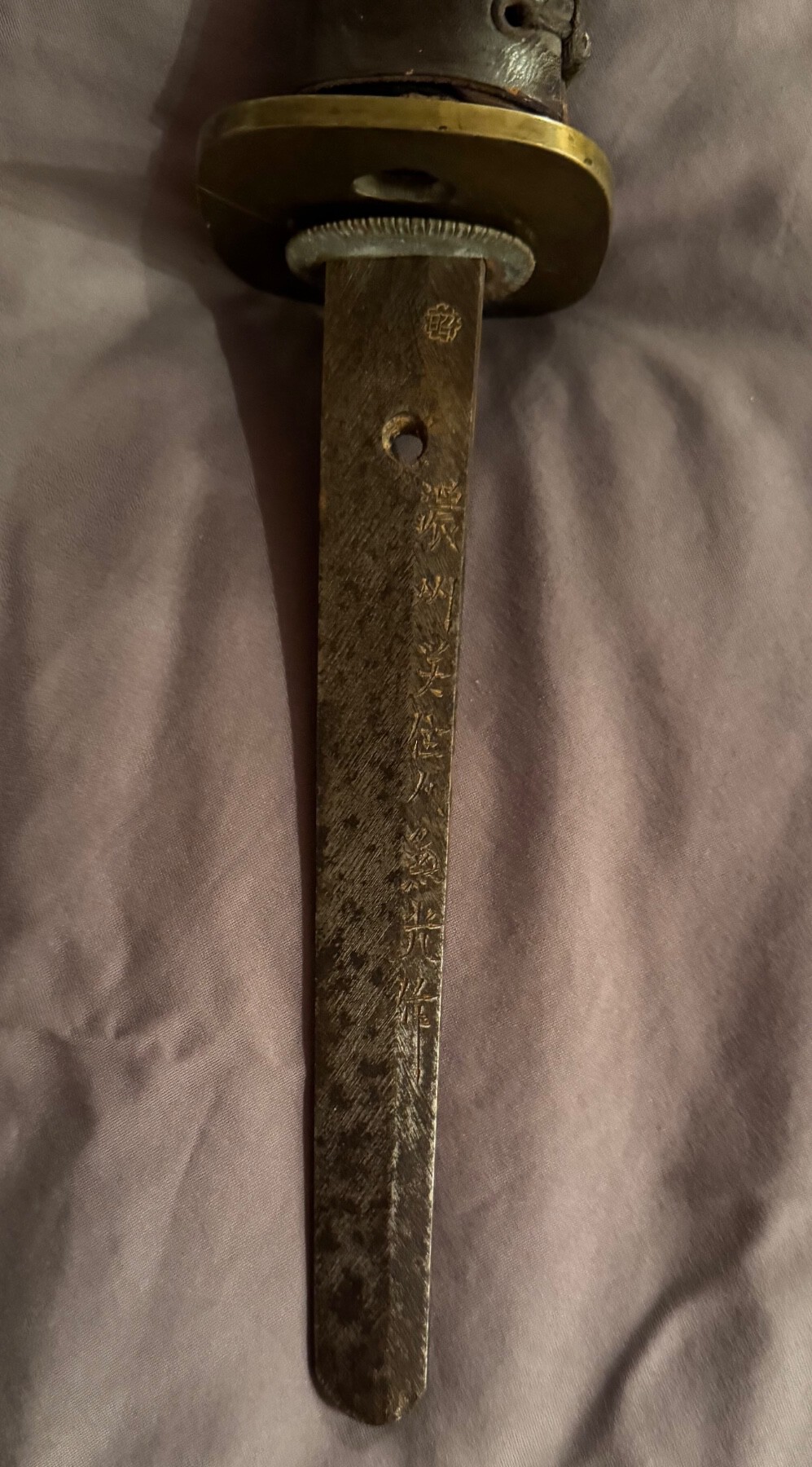

I have this Japanese sword and I’m looking for whatever information I can find on it. It only has characters on 1 side. It has a round stamp that I am curious about. Any help would be greatly appreciated. Thanks, Curtis
Curtis,
You can read all about the stamps on blades on this article:
Briefly, it is the approval stamp of the civilian Seki Cutlery Manufacturers Association.  It was used between 1935 and 1942, with most of them seen on blades made in 1940-41.
Mind posting a shot of the blade and fittings?

Thank You for the information Bruce.
@SouTex  Curtis,  as noted  your  mei looks to read  "Noshu Seki ju nin Kanemitsu Saku"  ( 濃州関住入兼光作)  (made by Kanemitsu a person living in Seki in Mino (Gifu)).  (The kanji read "seki" looks odd, and more like "warai"  笑   which does not make sense to me, but it was read that way by F&G in 1983).
Kanemitsu is a common smith name with at least seven in wartime Seki, but of these only three have this kanji   兼光  and one (Yamada Kanemitsu 1877-1935)  died pre-war .
Most likely yours is one of these, but probably is Goto who produced some very good work.  (examples given).
KANEMITSU (兼光)  real name Gotō Shōzō (also read as Matsuzo) (後藤 松蔵), student of Kanenaga (兼永), born Meiji 20 (1887) July 20.   Registered as Seki smith in early period on Showa 14 (1939) October 26.  He became a rikugun-jumei-tōshō and in 1942 Banzuke was ranked as Joko no Retsu (5/7).   He died in Showa 32 (1957) March 18.
KANEMITSU (兼光)  real name Ogawa Mitsuo (小川 光雄), born Taisho 10 (1921) January 20, registered as a Seki smith in Showa 17 (1942) July 3.  Worked as a guntō smith.   In 1942 Banzuke he was ranked as Ryōkō no Jōi (6/7).    He enlisted or was drafted into army             and KIA in Showa 19 (1944) July 8 (age 23).  Very little info on him.

Curtis,
Would you do me a favor and post a clear shot of the face of the tsuba (handguard)?  Hard to see in these photos, but is it plain, with no design pattern?
Also, check the fringe at the end of the tassel to see if there is a discernable color in the mix.  Your strap is two shades of light brown, and often the lighter shade is just badly faded red.  Could be a Field grade tassel, and sometimes the red can be seen in tight spots where the 2 straps come together at the knot on top, or in the center of the fringe at the bottom.

Hi Bruce, the tsuba is plain, no markings. I checked the strap and it is faded green on the inside of the strap.
