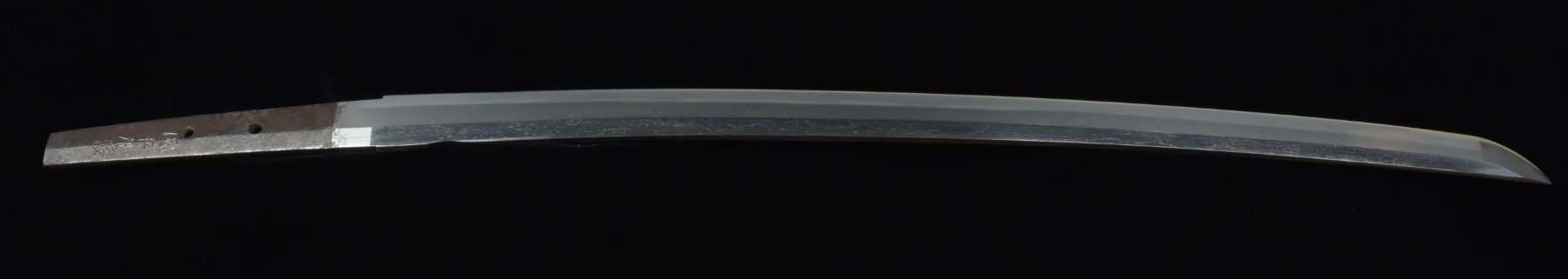

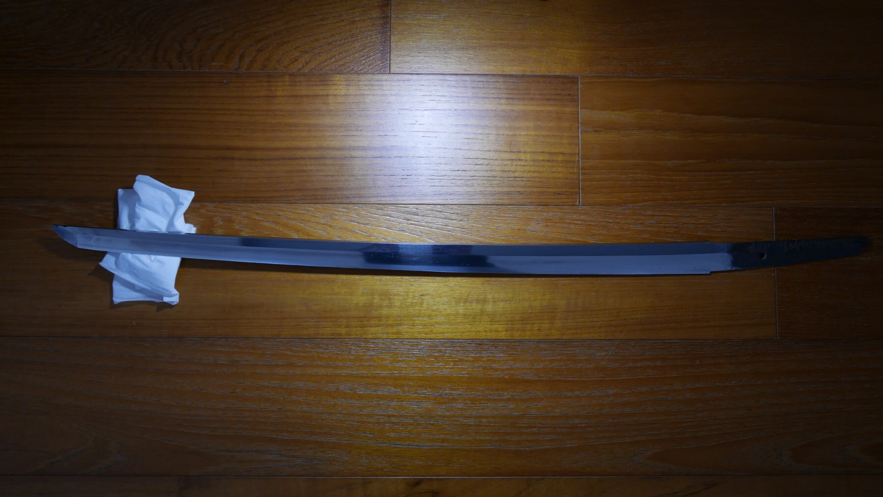

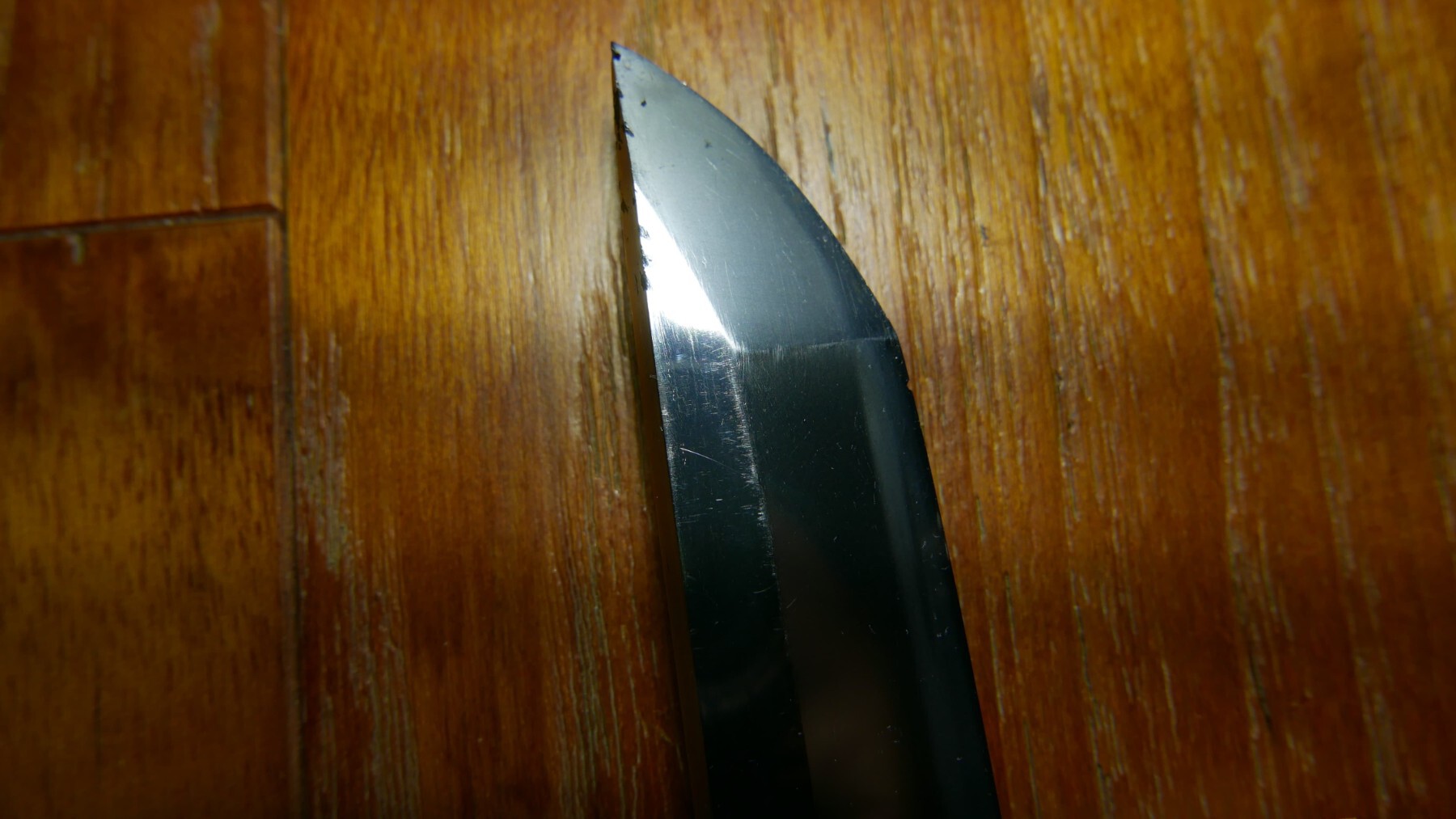

My first nihonto was this 60.4cm Shinto katana by Fujiwara Tsunayuki, made in Genroku period(1688 ~ 1704). Sori is only 0.9cm, so it's quite shallow.
I've bought it at about 1300$ in Yahoo Auction. That time I was really happy to buy a katana thinking that this was a bargain, but now I think the price wasn't that cheap compared to the state of the blade.

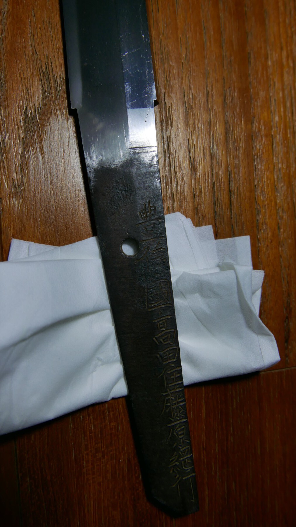

As you can see it is not in a good shape - old polish, can't see boshi, so many flaws at kissaki, quite weird length for a katana, rust here and there.
I'm not really sure about the tiredness; the boshi problem always ticks in my mind when I see it. At least I'm sure I won't buy blades that are in worse shape than this later.

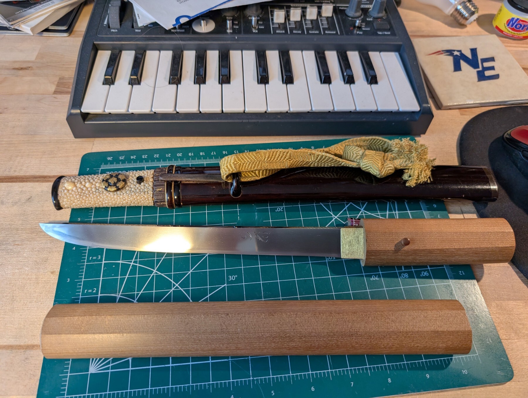

My first Nihonto was this tanto. I got it from AOI Art. They were really easy to deal with and I've gotten another tanto and a wak from them. This one is mumei, attributed to Chikushi Ryokai (early Muromachi) and has hozon origami. It's been fun learning about all this! Yoon, I wonder what your blade would look like with a fresh polish?
John

thank you for your report! The photos are not really helpful to show what you have. You need a dark, non-reflecting background, and only nicely focused photos can give us an impression of your blade. When posting photos, please cut the object out so not much background is seen.
Technically, your blade is a WAKIZASHI as the length of KATANA is 2 SHAKU (= 606 mm) at minimum.
I have to second John in that a good polish might bring out some nice features in your sword, but before that you will have to make sure that the KISSAKI is intact. If it has been altered with the HAMON running out now, it would probably not warrant a new polish.

This is very embarrassing, but I think I'll need to confess something- that bad photos were the most recognizable ones of total 500 shots. Trust me, I've tried under many conditions. Turns out that I just really don't have photograph talent. Still, will try to get better photos!
And for the polish... I'm just oiling and preserving the blade what it is like for now. Getting new polish is quite hard here, we also have somekind of Torokusho which makes really hard to send blades out to polish and bring them back in. Though I'm also curious how it will look like after polishing.
