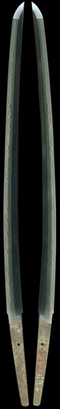

George: Have you seen this kai gunto in the For Sale forum? Kai gunto from Takayama forge by @Swords

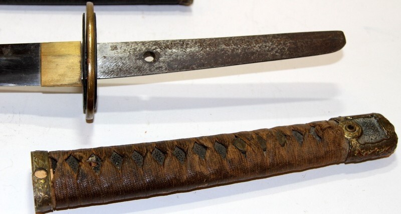

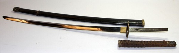

Thanks for the continued advice! In the end, using the mixed pictures I had available from the auction, I put bids on all of them, at levels I felt comfortable given the different amounts of risk involved with each one. So not quite a gut feeling, nor really waiting for one to speak to me, more like throwing spaghetti at the wall and seeing what stuck :laughing:
The other people in the auction must have been bigger fans of shin gunto, or perhaps there's something terribly wrong with it I can't see in the pictures, but the only one I successfully bought was the Kai Gunto, at considerably less than I'd bid on the Yoshimitsu!
1100456664.thumb.jpg.8bbb33c15f52ac72848a6b6589f20802.jpg1100456666.thumb.jpg.674a3ca2f48e5bccfd6fd0a5e9e7e9b1.jpg1100456665.thumb.jpg.38a2e213e696d15768d0639d876cadc7.jpg
153Mei1.png.3003d8fed884381b83e22575e1759714.png153Mei2.png.706b2ef3642d839eef037fcf6d587926.png
Although it's going to take me a week or two to get the blade home, I've also already ordered some ashi from ebay, at about 1/4 of the price I paid for the entire thing. Parts aren't cheap are they? I can live without a sarute, as I understand these were sometimes cloth/rope, but I'm not so sure about the chuso clip. Is there a navy specific one I should be trying to find as a replacement, or are they the same as the standard shin gunto ones?
And got to love small auction houses though. When I asked if there were any cracks or damage to the blade, they replied in an email that there was a "Small nibble to blade" - which is not something I've heard before whilst collecting lol. They also sent this wonderfully detailed photo of said nibble:
I'm just hoping there isn't a hagire hiding somewhere :S

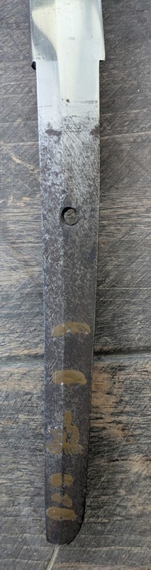

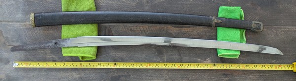

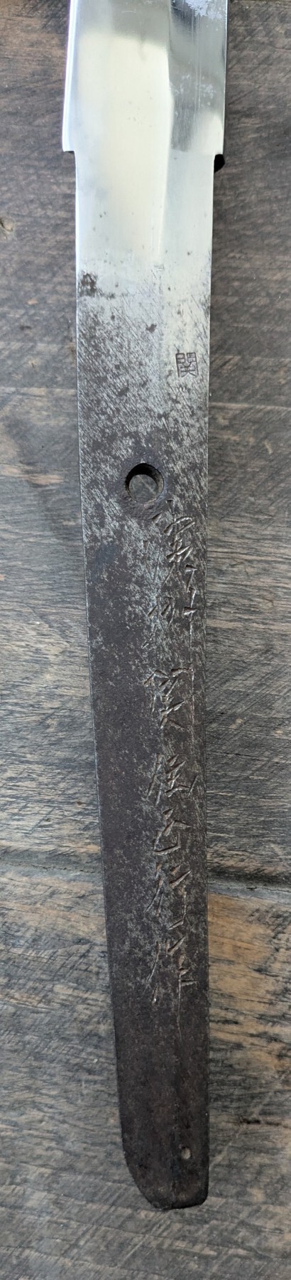

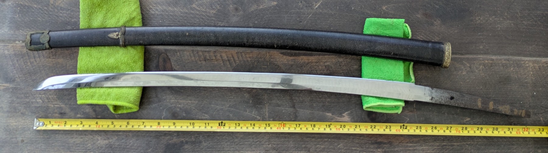

Ok, I'm home now, and finally been able to take a proper look at the kai gunto. No hagire I think, but it's definitely out of polish...
Jan was kind enough to provide me with the translations for the mei here: https://www.militaria.co.za/nmb/topic/51770-kai-gunto-mei
濃州関住正行作 = Nōshū Seki-jū Masayuki saku
昭和十八年 = Shōwa 18 (1943 CE)
Although missing it's ashi and mekugi peg, all the other fittings have the same 1,1,5,3 numbers, which leads me to believe these are also the numbers painted in brown on the nakago (please correct me if I'm wrong though):

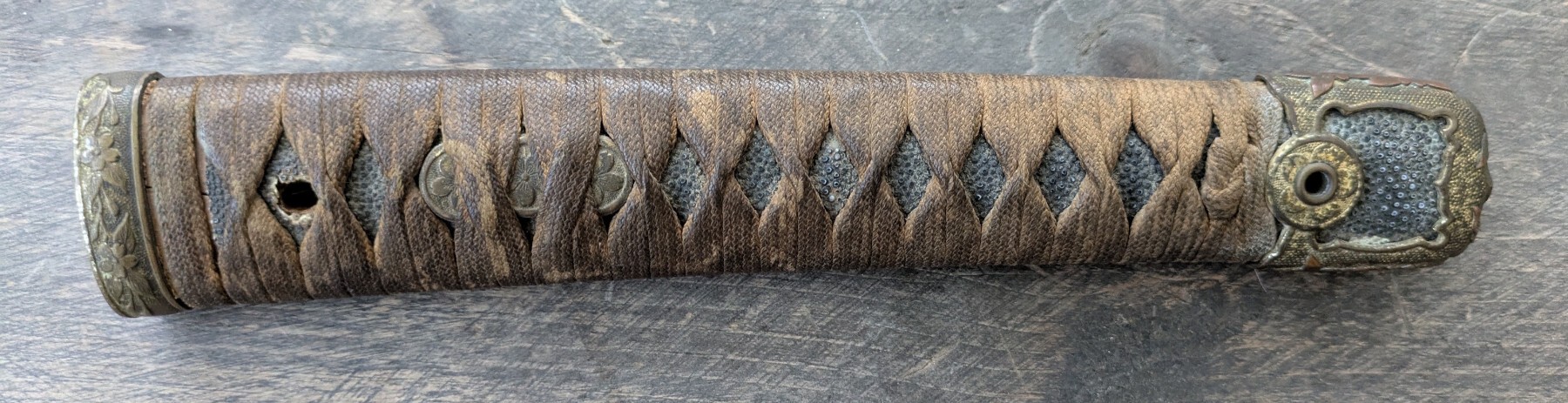

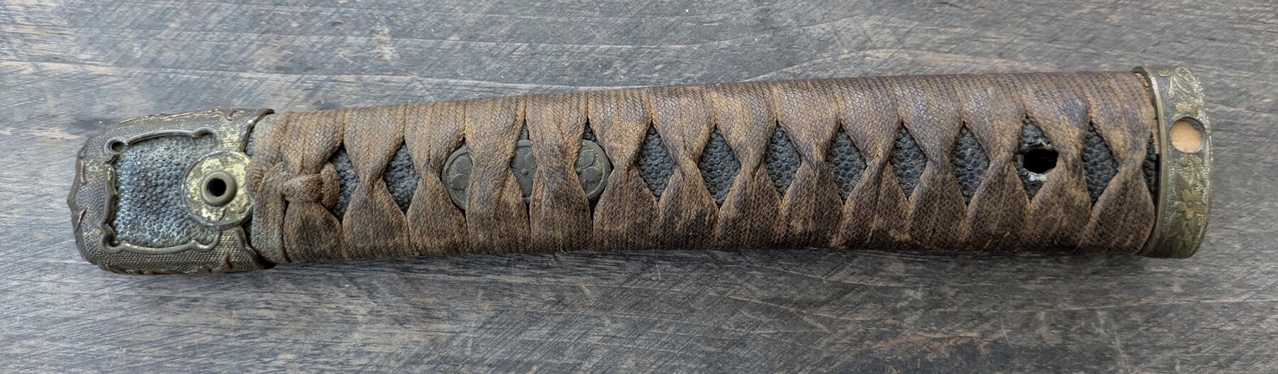

The saya liner is numbered 1153 inside, and the tsuka has it written on it too:
PXL_20250324_182723945_MP2.jpg.55636c9a6f912d600f1ce29737fea606.jpgPXL_20250324_182608585.thumb.jpg.1deb3fff6d49c44b81bcdd09792b10fa.jpg
Both the tsuba and the large kai gunto seppa are also numbered with the roman numerals (yes, they are upside down, but the numbers are this way up for some reason):
PXL_20250324_183013723.thumb.jpg.3014a8a2b3c74eb877b2812ac027a600.jpgPXL_20250324_182952107.MP3.thumb.jpg.d76b38a42edbb483b1bce96ed27eab55.jpg

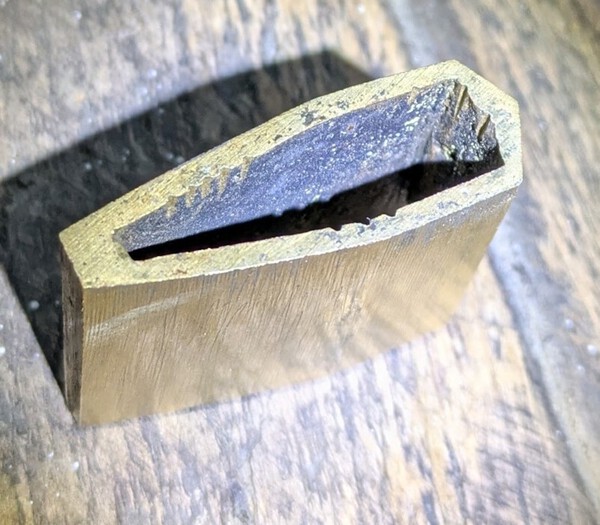

The habaki is also numbered, but using scratches instead:
PXL_20250324_182448889.thumb.jpg.0fccafc227800a4ecccb28e93e27c4e3.jpgPXL_20250324_182416739.thumb.jpg.b36d3784358293f504e2b8a35981be73.jpg
PXL_20250324_183032533.thumb.jpg.910d4c8e29d416886484c6ebcc1fd53b.jpgPXL_20250324_183039955.thumb.jpg.b215acf1299fe292b3319e8333eaf0b5.jpg
PXL_20250324_182117057.thumb.jpg.ed4a400e14192f29215aac9157e451da.jpgPXL_20250324_182050317.thumb.jpg.00bdb216ba475955b72e07eb74319d7e.jpg
It all feels genuine, but the casting bubbles are fairly obvious on the tsuba, and even the inside of the habaki again looks cast. And considering the 1943 date, I'm guessing this is an example of the decline in the quality of production due to resource shortages.
Out of interest, does anyone know what the highest numbered kai gunto is?
Apart from the missing ashi (which will be a pain to replace since they are the kind that need screws), the other two big issues with it is the saya skin is splitting along its entire length (hopefully this may be fixable?):

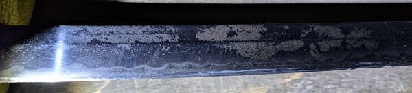

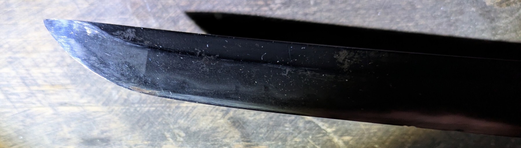

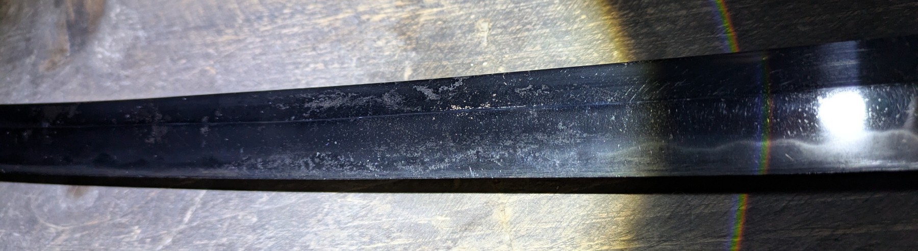

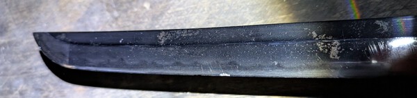

And that the blade is very out of polish:
PXL_20250324_194519085.thumb.jpg.d14b5fae2401b52e7495202d10d6aad1.jpgPXL_20250324_194513029.thumb.jpg.d5e5bfb062236c0a576407ab58f16908.jpgPXL_20250324_194445505.thumb.jpg.431ffe396e335fdd4205fa9425bb621b.jpgPXL_20250324_194416454_MP2.thumb.jpg.2d79011a80de11b01ec8b088fa27d30b.jpgPXL_20250324_194408643.thumb.jpg.9abc97b2d00f61410ec4a7e831df218a.jpgPXL_20250324_194244186.thumb.jpg.9c0b80d9d8a949404db7e7b0ee7e2a63.jpgPXL_20250324_194227577.thumb.jpg.46ef747dc04986f7c5e1dfcd30f5932b.jpgPXL_20250324_194103532.thumb.jpg.45f0035efc96b855b281b26ce00eb9f2.jpgPXL_20250324_194013185.thumb.jpg.c9d15a70c924ddcacd1faff1fcbd1843.jpgPXL_20250324_193958483.MP4.thumb.jpg.2ddc64c37a5629eb494054b8f2f28da3.jpgPXL_20250324_193947237.thumb.jpg.dadb56c81dd46256885cdbb1b48df79f.jpg
Thankfully it's all surface rust as far as I can tell, but it is a pain the auction wasn't able to show this all in more detail *before* I bought the darned thing. Now I know why it was so cheap for a kai gunto!

I think I may have instead ended up with a battered showato in battered fittings instead of listening to this sound advice :doh:
Oh well - hopefully I'll be able to at least stabilise the rust with oil and uchiko.
On the bright side, it is nice to finally be able to hold and study a kai gunto, as well as a showato for the first time :)
The hash marks are a modified Roman numeral system. You can see two single strikes at the top for the one, one, and the five strikes on one side and the three strikes on the other. So the number matches the rest of the fittings.

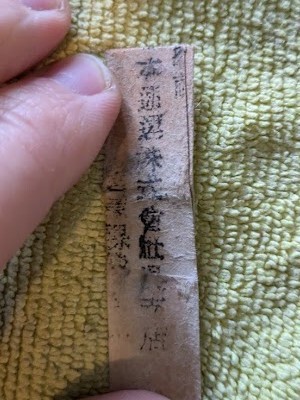

So... I was cleaning the tsuka of this kai gunto today, trying to get rid of some of the mould. To do so I needed to remove the knot loop and the kabuto-gane (I've done this before with the shin gunto and the removal process was just the same).
However underneath it was a bit of paper. I initially assumed it was just to help with the fit - but out of curiosity I took it out and unfolded it, and it does have some writing on...
PXL_20250329_145020730.thumb.jpg.40cd74154316eadbd4182630c7ac8668.jpgPXL_20250329_145426777.thumb.jpg.a00828e6151824b34560fe637dd0ee43.jpg
PXL_20250329_154513936_MP.jpg.0578cc945363458ade297a94c859409b.jpgPXL_20250329_152631795.jpg.b87e8d2afa467dcca58f7bcca2136c66.jpg
There wasn't any other writing on the other sides. Is it just a scrap piece of paper do you think, or something else? For now I've just stuck it back where I found it.
Thanks again,
 George
The column in the middle is a name of a company.  The last character translates to "store."
??株式會社??
