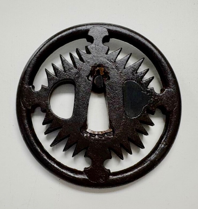

After a long and patient wait, I have just acquired my first tsuba in the composition of the Jesuit IHS Slanting Rays of Light (Shakoh) or Sacrifice for the Christian Faith (Kirishitan Ikenie). This is not a tokei tsuba (why would samurai and bushi adorn their swords with fittings depicting clock gears?). Here is my summary of this tsuba.

12 hours ago, Bugyotsuji said:
Interesting tsuba.
It may be that the central design was pushed into the rim, which would account for the fine lines around the 分銅 bundo weights.
The lines are skillfully executed and well-defined on each of the bundo weights on omote.

The paper to Owari is just plain wrong, if you are referring to my tsuba. It’s not an Owari. It is clearly Akasaka. Fred's is attributed to Shodai Akasaka, although he feels that it may be earlier. The features and historical context point to Shodai or Nidai for both (they never signed their tsuba, so this attribution must be inferred).
That Japanese motif often seen in arts and crafts is also called “myriad treasures.” The bundo weight is frequently seen in Owari Province tsuba of the Momoyama and Edo Periods, connoting strength and balance. And it is depicted exactly as it existed in the real world. Here is a copper one from the Edo Period. And here is my Kanayama tsuba with gourds and bundo weights (chock full of lumpy-bumpy tekkotsu).

The one from the Varshavsky collection on the lower right is in a later style in which the motif is being softened and disguised to avoid persecution. It is quite typical of the mid-late Edo period.
These 1st style Early Edo Shakoh don’t look like clock gears. And both are proto-Akasaka, as I have argued from their features and historical context.

Did Ko-Akasaka - in this case Shodai Tadamasa - produce such fully rounded rims?
I was under the impression that all of the Ko-Akasaka masters produced distinctively rounded rims. Mine doesn’t have the 3-layer puff pastry construction (mokume-game) that I have seen in Nidai Akasaka work. Using Deepseek AI query, it doesn’t appear that Shodai forged mokume-gane tsuba. This was developed by later generations starting with Nidai.
Here is a possible prototype-Akasaka tsuba with features of Owari and Akasaka tsuba: https://richardturner.wordpress.com/2011/09/28/who-can-it-be-now/
Sorry for confusing You. Of course a maru-mimi is a typical trait of Akasaka smiths.
I was talking about the ring-shape of the rim, the technical term is torus.
The generations from the fourth onwards used this shape frequently, but I’m not sure about Ko-Akasaka and first generation particularly.
Great point, Florian. The rim is rounded, but not radially like a true torus. I’m waiting for sunny weather to take a better pic to show this. The inner wall actually has a flat portion, but it is more rounded than Fred’s. His is flatter on the omote and ura surfaces—more like Owari. Perhaps the unusual quasi-torus shape of the mimi reflects experimentation—prototyping as it were. It creates a very robust and substantial effect even if this idea was ultimately abandoned by the Akasaka atelier.

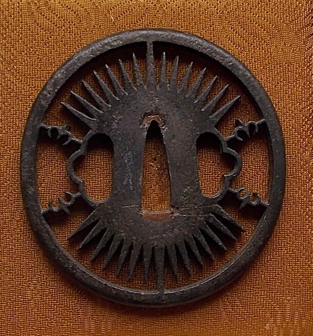

A SHAKÔ TSUBA from my collection with pronounced rays:
  • Love 1

Thank you Steven,
that TSUBA on Jauce is probably from the same workshop! Very close!
