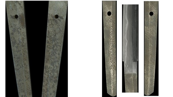

Below are 2 examples from Japan sales sites   (they read as Yoshida):
Left:   mei:   "Yoshida Kanesada saku"  (as tachi-mei = cutting edge down),  dated : Showa 17 (1942) November.     length 66.8 cm   sori:  1.6 cm.  Hamon is straight suguha.  No stamp seen.    [e-sword, Japan]
Right: mei:  "Noshu Seki ju Kanesada saku"    (as katana-mei = cutting edge up).   No date.    Hamon more active notare-suguha.    No stamp seen.   Length:  69.2 cm   sori:   1.4 cm   [Meirin Sangyo Co Ltd]
