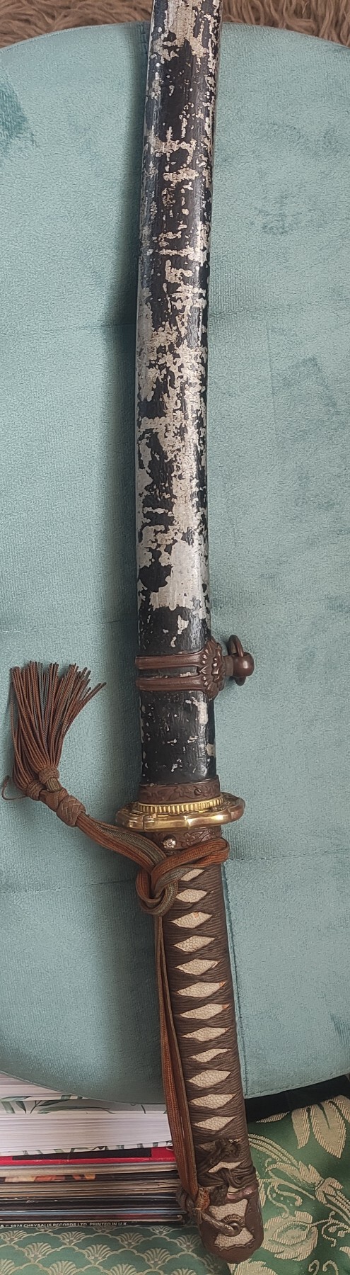

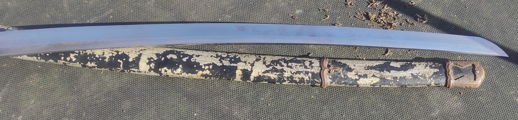

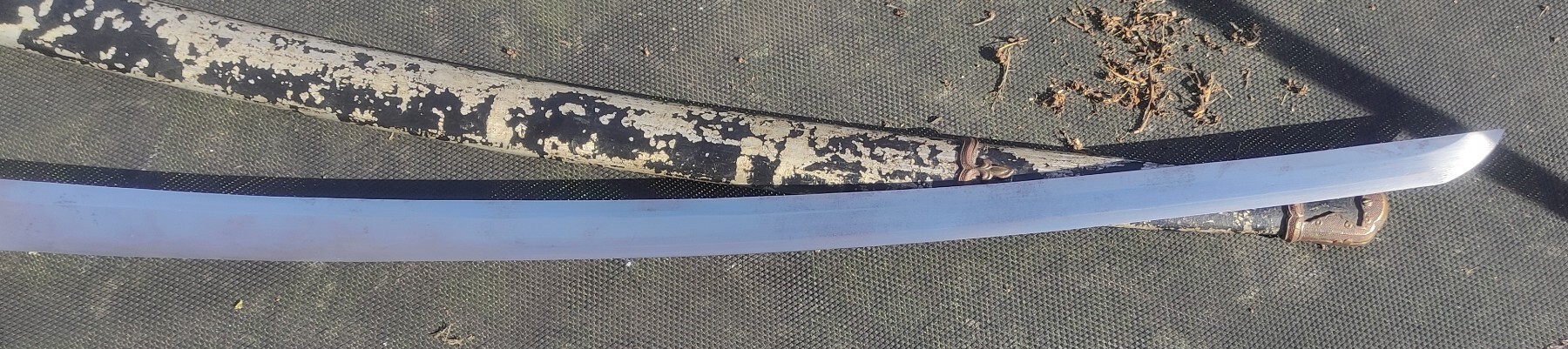

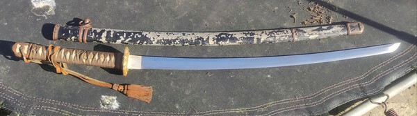

Sometimes you get lucky at auction as this was not a good looker from the auction pictures when I placed a low bid, so it was a nice suprise on collection no pitting particularly in the flesh (looked black and sandpapered in some of the pictures) a Mon on the tuska and a nicely visible hamon.

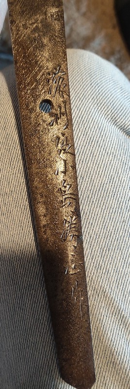

Nice find, Perry!  Don't know how much you know about it.  Smith was Katsumasa:
"KATSUMASA (勝正), Shōwa (昭和, 1926-1989), Gifu – “Katsumasa” (勝正), real name Kojima Shichi´emon (小島七右衛門), born October 20th 1892, he studied under Kaneyoshi (兼吉), worked as a guntō smith and died September 22nd 1947"
Likely no date on the other side, with that large Seki stamp, but most of those were made in 1942, plus or minus a year.
Faded blue/brown tassel was for Capt's & Lt's.
