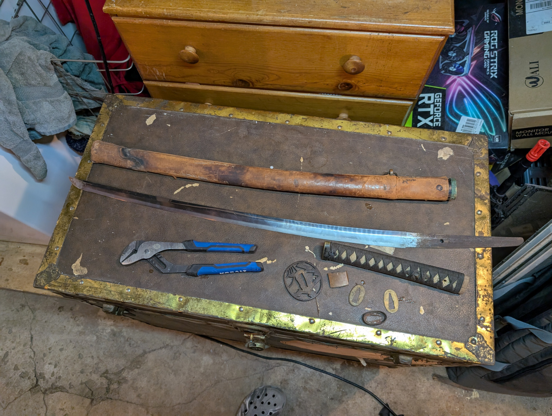

Hi all, I was given this sword by a friend for helping clean out his Grandfather's house and getting it ready for sale. (he lived to 101 we should all be so lucky) His family knew nothing of it's history only that he served in the U.S. Army Combat Engineers and they THINK he came back with it. The guy was a bit of a hoarder and loved Flea markets and pawn shops so it's entirely possible he bought it later on.  My knowledge of Japan and it's culture is limited to old Akira Kurosawa films and Anime. So I'm fairly ignorant of what this is beyond some google searches on my phone. I used to restore furniture for a living and love old cars and motorcycles so i decided to clean it up and hang it in my living room. After reading though the forum i realize i probably made mistakes (Like taking the rust off the tang) but since I have no plans of selling it I'm not concerned about $$$ value. There is no hamon so i don't believe this was hand forged, but the steel is quite good. There are no other markings on the blade, the other side is blank and there is no arsenal stamp. I've been trying to noodle out the marking on my own but have come up with little. I figured I'd see if there was someone more knowledgeable here who can help or point me in the right direction. PXL_20250302_142437720.thumb.jpg.4110803ca5c14f01c00d3ec344679feb.jpgPXL_20250302_231947717.thumb.jpg.38a07327ca99921cc68646b4c95c0936.jpgPXL_20250302_143216122.thumb.jpg.c80776effa9b709ebcb210a55b356850.jpgPXL_20250302_235209153.thumb.jpg.ca3fbb7a1914a4e687bb731de2b967b0.jpgmarkup_1000005086(1).thumb.jpg.76afd5b3a9d0c7f30436b67e7a88b504.jpg

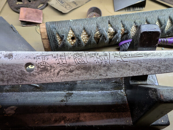

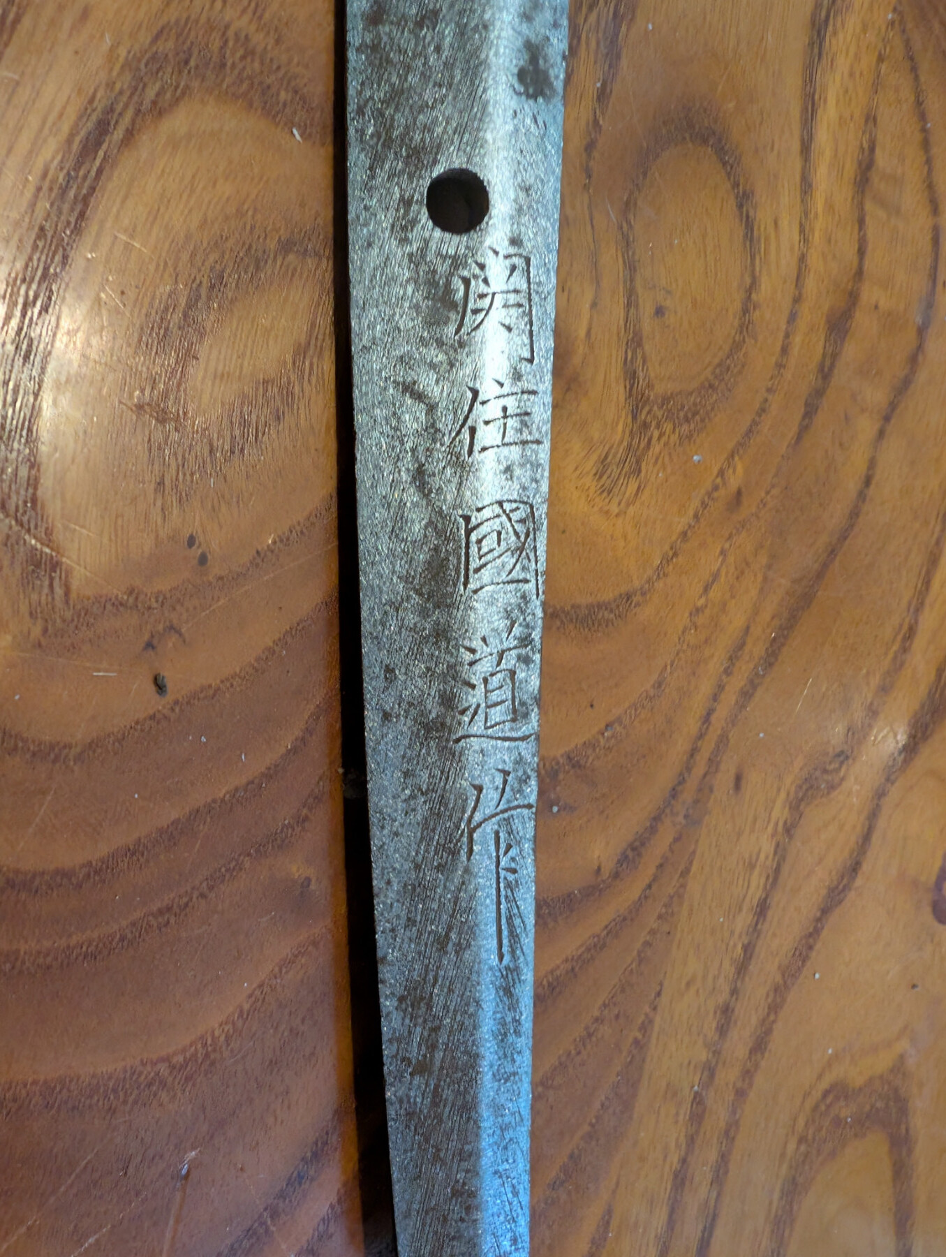

The tang is signed Seki ju Kunimichi saku "Made by Kunimichi of Seki province"
As you stated, removing the rust from the tang was an unfortunate mistake as it is a very important part of the history and also value of the sword. But it is a WW2 era sword and from what I've read here, having the leather saya cover is an added bonus (some of the military guys can chime in there).

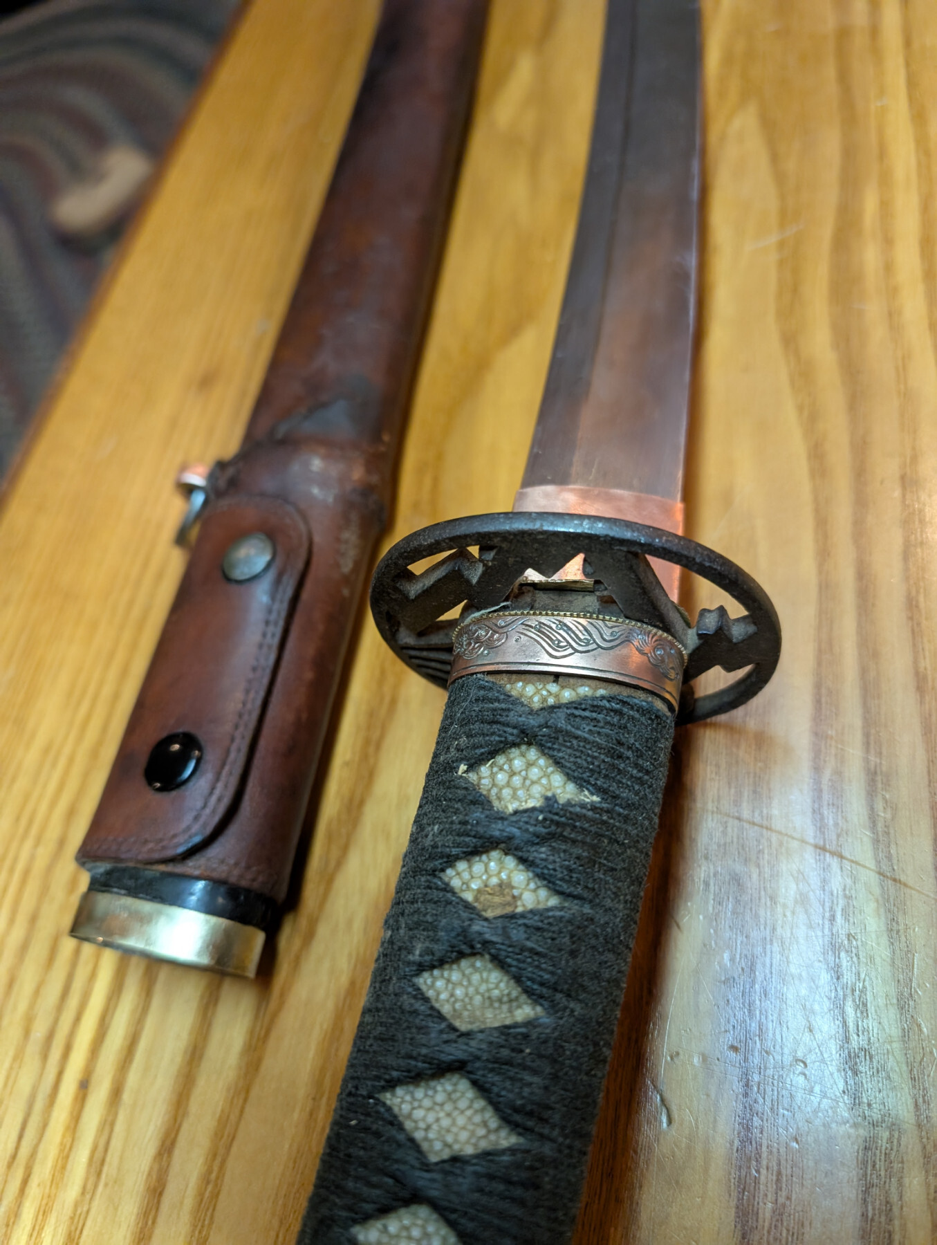

Thanks so Much! The leather on the sheath (the saya cover. I'm still learning the lingo) was really brittle and in need of reconditioning. Unfortunately my wife decided to unsnap it and tore some of it, but i used some smelly old school Hide based hot glue to secure it. Then did about a dozen passes with saddle conditioner and mink oil and it's fairly supple now. The lower Snap on the saya lost it's cover i was going to black lacquer it, but decided to leave it alone. I polished all the copper and brass (i don't know if that's correct to do but it looks nice). As i said before i stripped the rust off the tang in my ignorance, then used 600grit, 1000grit and the 2500grit wet paper with a 10:1 water to oil soap to polish out some rust marks on the blade, there is still a bit of pitting (especially near the point where the sword was left standing in the corner of the basement near a lot of moisture) but you have to look for it. However the edge is perfect and a few gentle passes with a stone and i could almost shave with it! I'd love to have some chisels from this kinda steel! I need a new buffing wheel to give this a nice mirror polish, but that will have to wait till tomorrow. I took a bit of 600 grit to the hilt (Tsuba?) just to knock the loose rust off but left it kinda "blued". The peg (mekugi?) that attached the handle was broken and loose. I turned a new one out of Ash since I had that lying around. There was still a lot of wobble between the handle and tang though, and I read somewhere that they would put prayer papers in there to tighten the fit. i don't know if this is true or not, but i used some old framing canvas to act a a shim and tapered the peg and it's tight as a drum now. All in all I'm pretty pleased with how this turned out. I might have damaged some of the historical value of this, but i don't really care. It's a cool sword that was forgotten behind a dresser in an old man's basement doomed to rot. Now it has a chance to live on!

All the work on the blade, fittings and tang are exactly the opposite of what should be done on a Japanese sword. Kinda hurts to read. Ruined a lot of the value it would have had. Too late now though. It's a wartime sword, and it does have a temper line. But with the work done to it, there is little chance it will be visible now, without very expensive professional restoration. These are also not sharpened like knives, you don't take a stone to the edge. Sharpening is accomplished through the blade polishing process which is quite complex and expensive. I suggest doing no more work on it, and just keeping it lightly oiled.

Robert,  looks to be made by  “Kunimichi” (国道), real name Kobayashi Magoichi (小林孫市), of Seki,  born March 14th 1901, and died September 4th 1969.   He was a wartime smith but did produce some good work. He registered early on as a Seki swordsmith in Showa 14 (1939) October 26.   This one has a stamp of Sho in sakura indicating early war and not traditionally made.   In 1942 list of 400 smiths he was ranked as  Ryōkō no Retsu (7/7) and in the 1941  exhibition was ranked as  Fourth Seat.  Yours is in wartime civilian mounts.

Dude, I've made my fair share of mistakes when trying to treat rust, but what on earth possessed you to clean the copper 😅... Do you just really not like patina? Fair play with the leather work though - as Bruce has said the same sorts of rules that apply to the metals don't to this, because it degrades so quickly. Similarly replacing the wooden mekugi peg if needed is also fine.

1. Japanese swords last hundreds of years. They get past from owner to owner, generation to generation. If someone in that chain doesn't look after it well, and rust builds up, it will need to be polished. Polishing is a destructive action - it always removes steel from the blade, never adds it. Yes, you have removed the rust, but in doing so have likely removed more material than a traditional polish would, shortening the swords lifespan. The nakago (tang) is never traditionally polished, or else the mei (signature) would quickly disappear. As others have mentioned, removing the rust from the nakago also removes one of the easiest ways to help date a blade.
2. The other problem with using sandpaper and stones without knowing enough about Japanese swords is you'll likely have changed the geometry of the blade, rounding edges and divisions that shouldn't be. For example most nihonto aren't shaped like a knife with a razor edge, and instead have a rounded niku/profile like the below (A.) example (https://japaneseswordindex.com/niku.htm):
niku2
This profile can be easily altered unknowingly with stones and belt sanders.
Similarly, the yokote (the vertical dividing line between the kissaki (tip of the blade)) and the rest of it should be a sharp transition, as should the shinogi (ridge line) - these again will likely have been rounded more than normal (https://www.Japanese...dex.com/glossary.htm).
blade
They are possible for a professional to fix if there is enough meat on the blade, but doing so will mean even more of the steel will need to be removed than in a normal polish to do so, shortening the blades life further.
