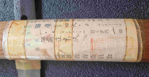

lorn9800 Posted March 16 Author Report Posted March 16 Bad news. I found this at the place my father in law. So it is a copy Quote
Scogg Posted March 16 Report Posted March 16 @lorn9800, Your sword is a genuine Japanese sword. NOT a copy, fake, or repro. The paperwork that you have is misleading; maybe incorrectly and/or poorly translated. (or maybe even for a different item?) The signature may or may not be genuine, but the sword absolutely is! Take good care of it. Cheers, -Sam Quote
Brian Posted March 16 Report Posted March 16 Yeah, for a change we get to say "NOT a copy" Nope..genuine and decent antique Japanese sword. Look after it. 1 Quote
