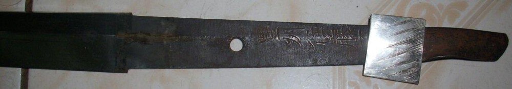

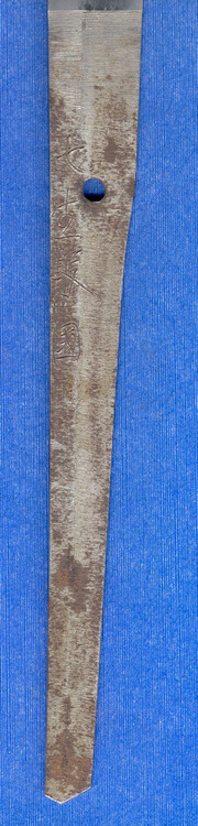

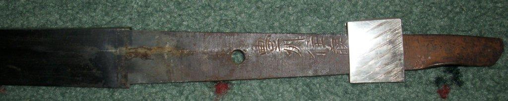

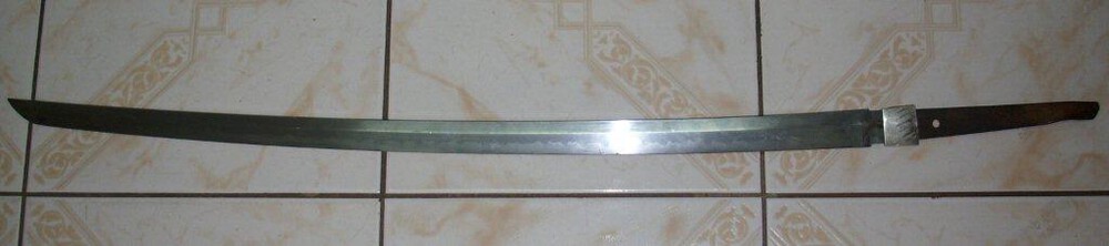

shawn Posted February 6, 2010 Report Posted February 6, 2010 Hi all, I was hoping someone may be able to identify the sword in the photos. Its in pretty average condition so I apologise for the photos. The total length of the blade is 90cm. Any help in identifying is appreciated especially in deciphering the marks on the tang as I have little knowlegde on Japanese swords. Quote

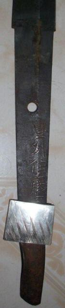

Stephen Posted February 6, 2010 Report Posted February 6, 2010 disregard my request in TA and post more pix here. all the hardware needs to come off so we can see whats going on with the nakago, why its turns down, a shot like this Quote

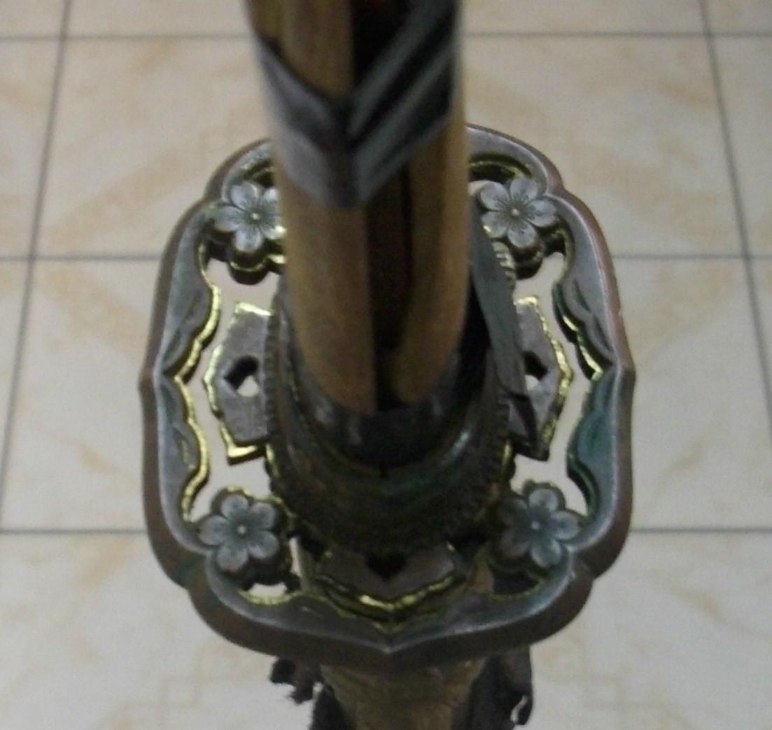

pcfarrar Posted February 6, 2010 Report Posted February 6, 2010 Looks like the nakago might have been altered to fit in a kyu-gunto koshirae. Quote
Stephen Posted February 6, 2010 Report Posted February 6, 2010 yea Pete, i was holding off on that thought in hopes of better, Hope springs Quote

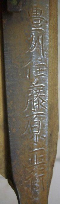

leo Posted February 6, 2010 Report Posted February 6, 2010 Hi, in case you want to know the smith, it´s "Hoshu Ju Fujiwara Masayuki", Bungo province, Bungo Takada school, 1st or 2nd generation, between 1624 and 1687. Regards, Martin S Quote

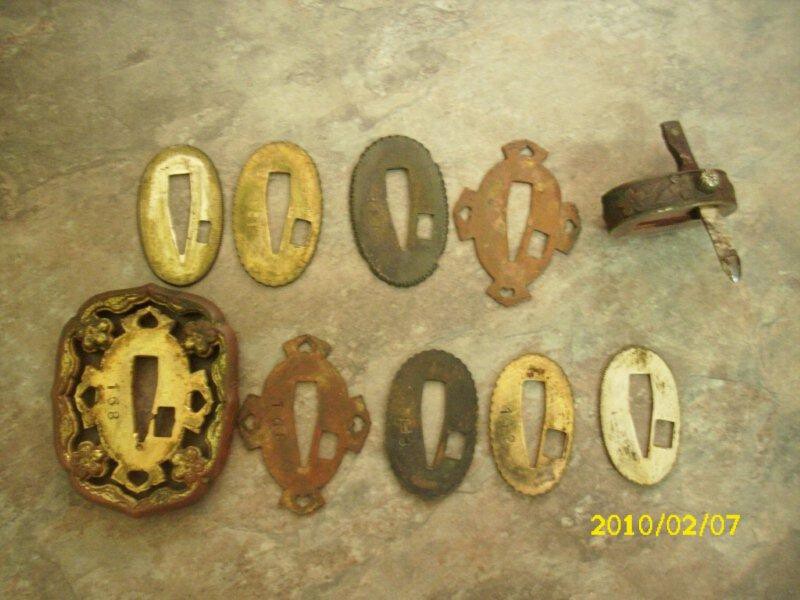

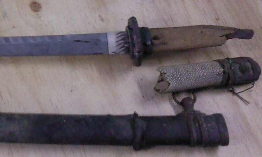

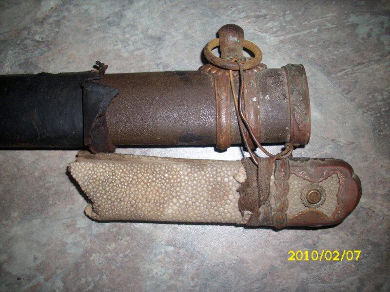

shawn Posted February 6, 2010 Author Report Posted February 6, 2010 Thank you very much to everyone who has replied. I appreciate all your help so far. I will post some more detailed photos soon. It amazes me that this blade could be so old. Not that I'd sell it, but I would be curious to know its approximate value. I've noticed that all the parts (not the blade) have been stamped 168. I've attached a few more photos that may be of help. Once again thank you to all. Quote

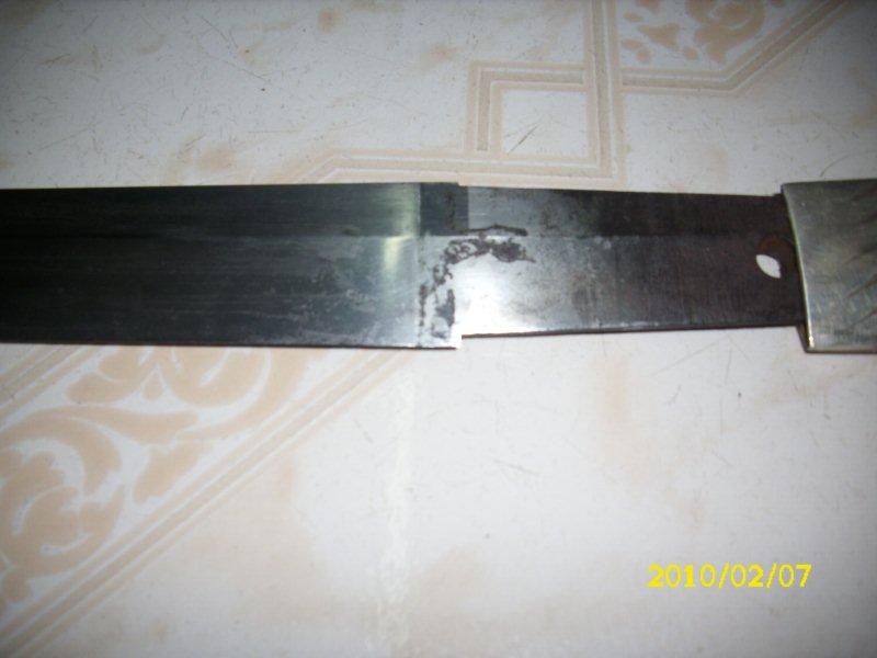

Stephen Posted February 7, 2010 Report Posted February 7, 2010 new pix just show us the parts added to the sword for its use in WW2, we would like to see the nakago (tang) end. Please post full shot of the blade and tang without any of its parts and one good one of the nakago with out the habaki, blade up. thanks for putting up with the requests. Quote

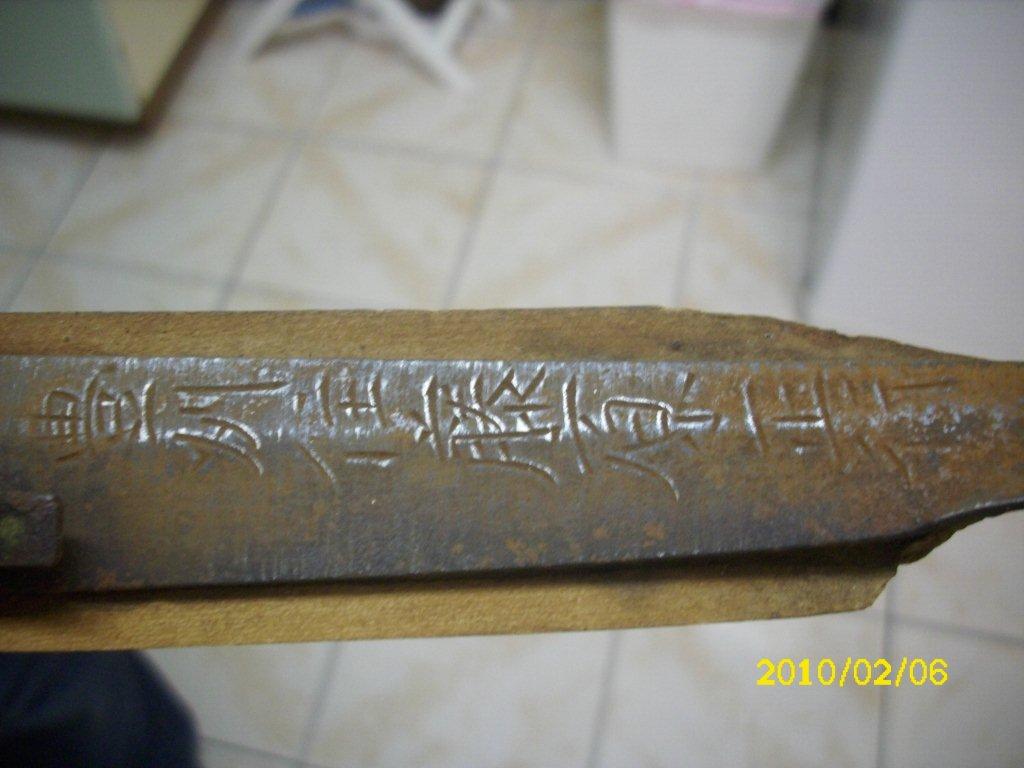

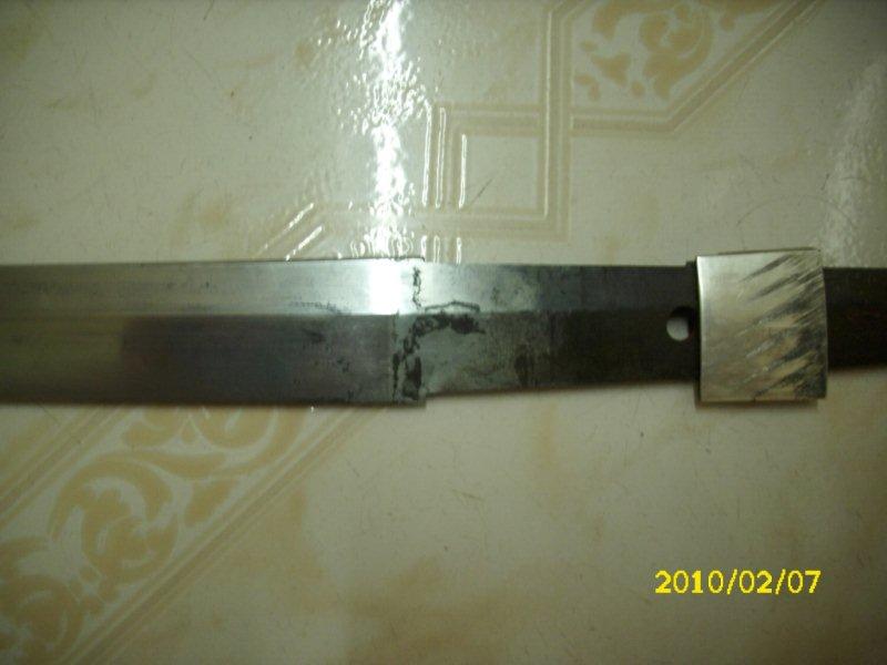

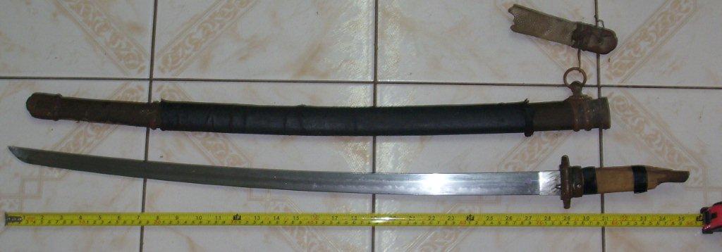

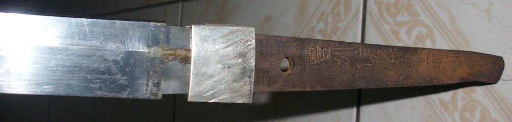

shawn Posted February 8, 2010 Author Report Posted February 8, 2010 Hi, Unfortunately I cannot remove the habaki completly. Apparantly during the war the tang was hit by a bullet. As it is now bent out of shape and I have little knowledge on these swords, I am not prepared to straighten it as I do not want to damage it anymore than it is. I have attached new photos. I hope these a what you were refering to. Unfortunately the browser restricts the size of the photos. I'm curious as to why the tang should not be cleaned (I did do this to make the characters readable). I've noted the smiths name below and approximate year of manufacture, is there any way to trace its origins further? Can anyone tell if this blade was common or of a rare variety. Thanks again. Shawn Quote
John A Stuart Posted February 8, 2010 Report Posted February 8, 2010 It seems to be 濃州住藤原正行 'Noshu Ju Fujiwara Masayuki'. John Quote
David Flynn Posted February 8, 2010 Report Posted February 8, 2010 Looks like it was hit with a bullet! Quote
pcfarrar Posted February 8, 2010 Report Posted February 8, 2010 shawn said: I'm curious as to why the tang should not be cleaned (I did do this to make the characters readable). If you clean the tang you devalue the sword and destroy a patina that has built up over hundreds of years. By cleaning it you have now lost a significant amount of the swords value. Quote
Nobody Posted February 8, 2010 Report Posted February 8, 2010 John A Stuart said: It seems to be 濃州住藤原正行 'Noshu Ju Fujiwara Masayuki'. John Ref. viewtopic.php?f=15&t=6825 Quote
Stephen Posted February 8, 2010 Report Posted February 8, 2010 Quote you have now lost a significant amount of the swords value. i think he stoped before great value was lost. You have a fine sword and the school are well know for good fighing blades. i think a good smith could fix the nakago,or maybe a togi. What do you think Ted T, Bob B, Jon B? id give it hard thought to have it restored, as in polish and in shira saya. the sword is from the mid to late 1600's and a very nice find. Quote
pcfarrar Posted February 8, 2010 Report Posted February 8, 2010 He's cleaned it quite badly judging from the original photo and the new ones. Not the end of the world but it adds to the restoration costs. For a shirasaya, polish and repatinate/fix nakago he wont see much change out of $1500. I think it deserves to be restored if it was mine I'd fix the tsuka, get a new liner for the guto saya and fully restore the mounts. Quote
shawn Posted February 8, 2010 Author Report Posted February 8, 2010 pcfarrar said: He's cleaned it quite badly judging from the original photo and the new ones. Not the end of the world but it adds to the restoration costs. For a shirasaya, polish and repatinate/fix nakago he wont see much change out of $1500. I think it deserves to be restored if it was mine I'd fix the tsuka, get a new liner for the guto saya and fully restore the mounts. To clean it I used WD40 and a soft cloth. Unfortunately my lack of knowledge allowed this. If it were to cost $1500- what would this value the sword at? Quote
pcfarrar Posted February 8, 2010 Report Posted February 8, 2010 shawn said: If it were to cost $1500- what would this value the sword at? It depends on many factors. If the damage to the nakago can be successfully repaired and the sword survives polishing without any major problems or flaws you would likely get $2000+. It is however quite risky and you should never undertake a polish for possible financial gain. Quote

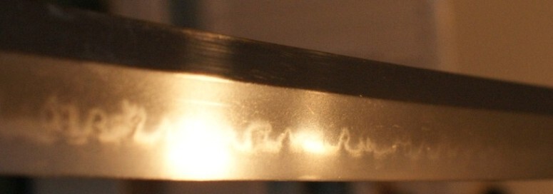

pcfarrar Posted February 8, 2010 Report Posted February 8, 2010 I have two Bungo Muneyuki katana in gunto mounts (both papered) and they are very nice blades. I think Masayuki was a student of Muneyuki. Attached is a photo of mine. Quote
